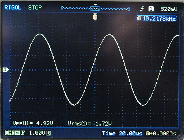

When oscillating correctly, what does the output look like on a scope? Do you see HF/VHF parasitic oscillations?
I get nice sine wave, however, if I scroll down to nS region, I was able to observe some HF oscillation as well. I am not sure where it came from. My scope BW is over 230MHz, it's possible the scope is picking up something else. Anyway, you have to adjust the final sine wave on spectrum analyser or good quality sound card, that's what you are after.

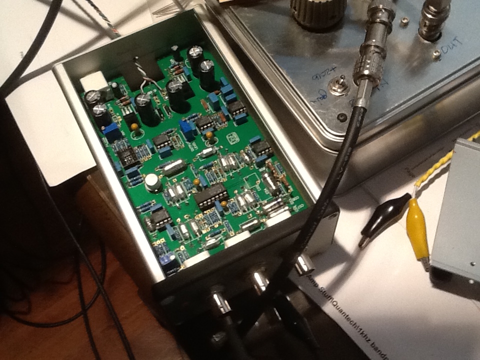

Is your oscillator in the box? Maybe you should post some pictures. BTW, I also have two SSR01 I can use, one is populated and the other one is just a PCB I didn't finish yet. But I had no need to use them since I have good results with Frex' zenner regulator, which I measured and gives around 4-6uV if I remember correctly.
Will send some pictures when I get a chance. The oscillator is not really in the box, I have it slotted into the recommended enclosure, but no end plates or lid. Some PP3 battery clips are on their way, will hook them up and drill the end plates. Did you drill holes in the lid so you can adjust whilst fully enclosed - that seems like a good option. Thanks.
No , I didn't drill any holes in the lid, I was lazy to do that. I don't think is necessary, unless you want the convenience of amplitude adjustment.
I had a little more luck this evening, managing to get the oscillator to work pretty well, though not reliably.
Rather than solely using the high impedance scope input, I added a 100k load. This seemed to calm things down and, with careful adjustment of the gain and amplitude controls, I was able to get a respectable 10kHz sine wave; clean, 5V pp, reasonable THD.
However, if I cycled the power with the gain control anywhere near the required level to start oscillation, I would have a 1MHz parasitic on top of the 10KHz wave. This could only be avoided by powering the oscillator with the gain control set materially less (multiple turns) than the level required to start oscillation. The higher the amplitude setting, the harder it was to start the oscillator without the 1MHz signal.
In summary, the only time I've had reasonable success is: 100k load; amplitude set to mid; gain turned down; slowly increase gain until oscillation, and once stable; increase amplitude to 5v pp. This would work fine, but power cycle would result in 1MHz parasitic and you would have to turn off and repeat this whole process.
This is still half in the case and using SSR01/2 regulators.
Nice build, btw!

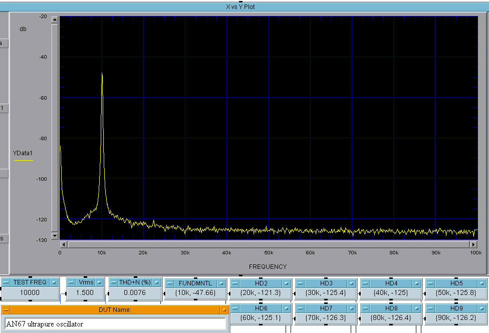

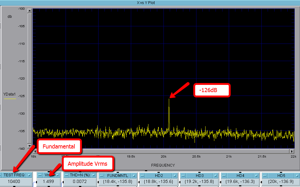

I just got mine finished, up and running. I found that the gain control only needed to be about +1/2 turn cw, maybe 3/4 for it to run consistently. The amplitude is at +6 cw and 1.5Vrms output. The 2nd harmonic trim is centered. I didn't find an easy way to measure the trimmers as the voltage in the psu caps throws the measurements off and they don't seem to bleed down. I had to turn the trimmers all the way until I heard their clutch click, then 12.5 turns to get them centered. I'm using a lab bench supply- and old HP 6205B and the onboard cap multiplyer. I presume that if you are using ssr1/2 regulators you are bypassing the cap multiplyer. I seem to recall reading that the Jung style regulators don't like bypass caps.
I was able to measure -126db 2nd Harmonic with Vout = 1.5Vrms. Pretty darn good. Didn't have much luck adjusting the 2nd H trim. Used Dick's Twin-T to null the fundamental to -47db.

zoom in of the 2nd H attached

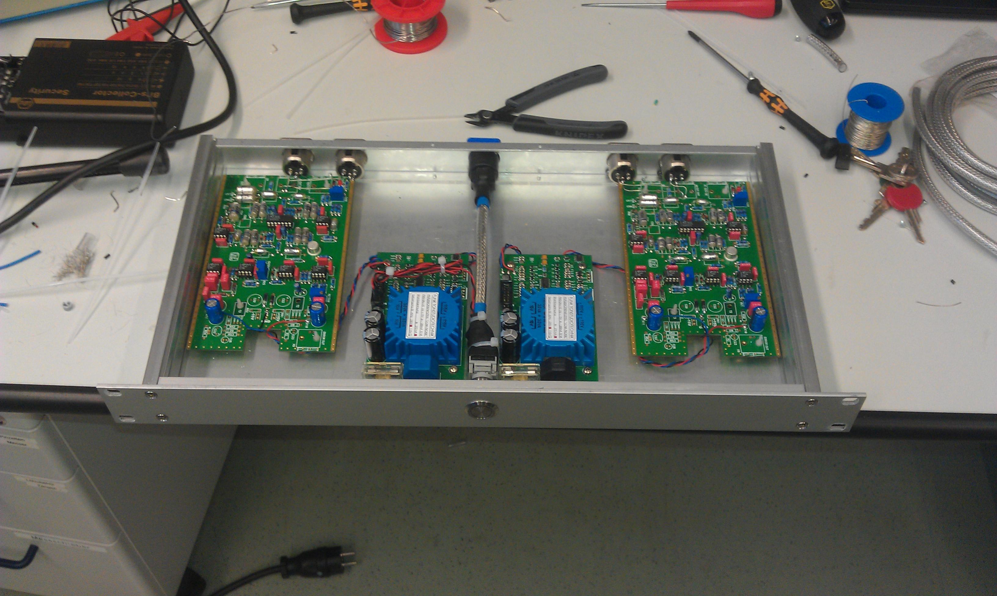

Sorry for my late answer Coretti.
The Powersupplys are from Funk Audio Berlin. They are quite sophisticaded and are "priceworthy" (around 80€). Mr. Funk is a very nice little bit nerdish engenier for special studio applications. I met him a few weeks ago in his outstanding laboratory and it was a nice talk.
Here are the measurements of those powersupplys:
http://www.funk-tonstudiotechnik.de/PWS-04a_V2-1-Messschriebe-2012.pdf
You must keep in mind, that they are "lowdrop" and do not dissapate a lot of heat.
He has also even better switched Powersupplys in his programm:
http://www.funk-tonstudiotechnik.de/SMPS-14T-Info-2-spaltig.pdf
For me there was no chance to build up my own regulators with the same money/time investment.

What did you use to measure THD? Is this 0.0076% THD the best your oscillator can do, or is it the limit of measurement method?
I have got much better THD than yours.
That result is from my HP8903a. It's the best the 8903 can do, not the oscillator. To get the actual distortion, I would need to calculate it from the measured harmonics, of which only the 2nd is visible. Even the 2nd might be an artifact from the active twin-t filter I used to null the fundamental.
