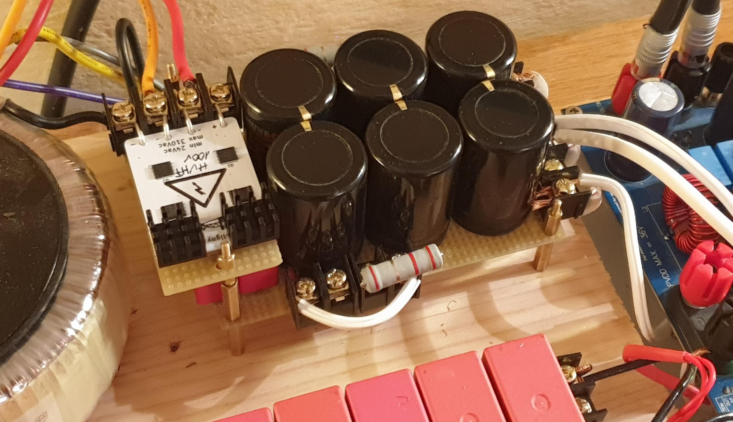

Same as previous post, I would also like to share my feedback, after one week of experimentation. I do not have any good measurement tool except my ears. Some would say it's the best device, some other the worst. In any case, it's only my own appreciation from a not so expert guy.
I received my package last Monday in good conditions.
Same day the awaited HVHF has been quickly installed in one linear PSU that I built for an amplifier made with the TPA3251EVM development kit from TI. Only the RURG3060 diodes (Ultra fast, slow recovery) haves been replaced. Otherwise everything is the same than before. Switched on and immediately heard something great happening. I listened so many hours before modification that I easily recognized improvements in the music. This was surprising to me, because I already spent so many time and budget to improve musicality and I was proud of the result, but I was wrong. Seems that my power supply was still noisy (diode noise, ringing ?) and the allegation that with this component the source of diode noise is killed is true.
- darker sound with HVHF than RURG diodes. Although I made some effort to fine tune the system in the past, I still felt it a little dry with high pitch. I thought the ESS 9038 DAC was guilty. But I was wrong. With HVHF in place, this has changed. Now I can appreciate a mouthful of fuller music. And the exacerbation of highs that sometimes triggered my right ear tinnitus never came back since Monday. This made listing sessions more addictive with no listening fatigue.
- fatter sound but still quick with more energy packed in each note I can feel. Sustained bass, heavier piano notes I like very much. The whole musical image has more contrast, thus easier listing again.
- more detailed with subtleties I never perceived before. I thought also here there was no improvement possible. But some higher resolution file like Seamus from Meddle Pinkfloyd 24/96 proved the opposite and the dogs really entered my listening room like never before.
- voices moved more in the forefront. Very pleasant listening of Operas and track with nice voices. Was a bit shy before, now sometimes a bit too much, but I rather blame my speakers and listening environment.
-truthiness of instruments. Here it's really different and shines. Especially classic tracks with wind instruments
Specification of the modified PSU :
-300VA 24VAC Vigortronix toroid transformer -CRCRCCCC setup with C=8200*µF Mundorf M-Lytic AG (50000µF in total) and R=2.2Ohm Wima FKP1 0.1 bypass before last R. -RURG 3060 diode before HVHF.I came to these components after many hours spent or diode tests, cap and snubber attempts across diodes and rail and R value and positions. The setup above gave the best listening experience, given the fact that my 95db efficiency are not too difficult to drive.
Many thanks Tibi for offering this very nice device. Small question : I received the old HVHF. What is the difference between this one and the new MKII ?

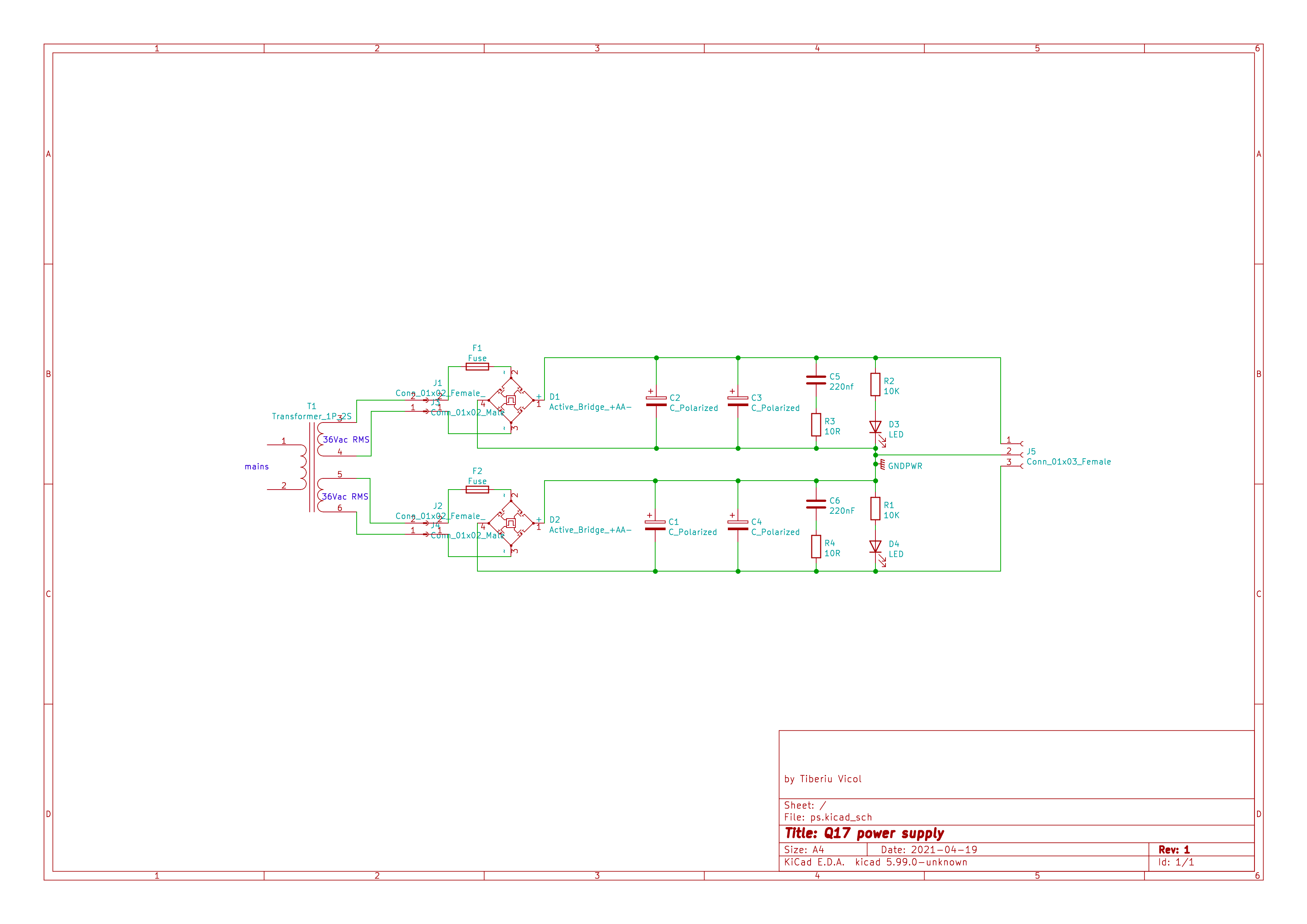

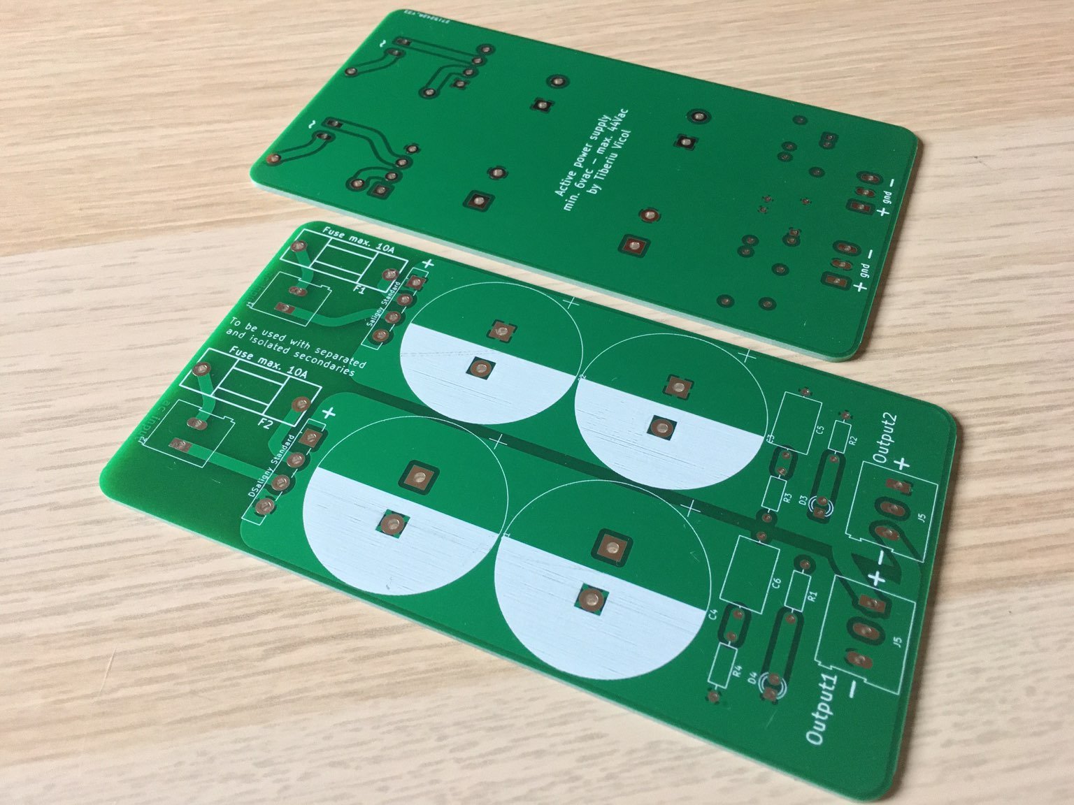

This is an active power supply designed to accommodate Saligny Standard.
Design is open-source. All surce files attached.
BOM and gerber archive included.
To open files use KiCad 5.99.
Enjoy !
Tibi

Answering here on some personal messages:
Fuse model is from this page Kicad
Any Saligny bridge can be ordered by subscribing to GB google sheet, or by pm me.
Saligny Standard is pin compatible with any GBU bridge and active power supply will work with a normal bridge as well, so use what you consider best. I do not mind if you use this design with a GBU bridge. 🙂
Active power supply pcb can ordered using gerber archive at jlcpcb for under 2$/pcb (I'm not affiliated with them).
Please use thread for technical questions. PM is for personal messaging. Thanks !
Tibi

Small question : is the snubber in the pcb still necessary ?
And in BOM snubber value is 100nF while in schematic is 220nF ?
Regards
Hi Greinedo,
Thank you for your observation.
There is no need for snubber if you use synchronous rectifier.
However the PCB s not restricted to Saligny and can be used with a wide range of diode bridges.
Publicity spot open !
But, I must mention that, even with snubbers a normal diode bridge will not be even close in therms of noise and dynamic performance compared with a well made synchronous rectifier. Will take a while till people realise "This is the way".
End of the publicity spot ! :-D
In case of a diode bridge, the proper value for C5 and C6 is 100nF or 220nF and 10ohm resistors must be adjusted on a scope, till diode on/off switching noise is minimised.
Tibi
