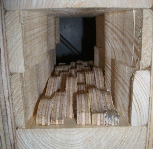

I have been experimenting with this driver again for midrange. I wanted to try some midrange enclosure ideas out and it was easiest to build a tiny enclosure for this speaker than to build full size ones
The plan is open back with diffusion treatment on the walls to try and minimise standing waves/resonances. Test enclosure built very simply. I haven't used it long but I observe some points.
The open back sounds somehow clearer than with it sealed (no reflected wave coming back through the cone), but a large amount of stuffing must be used or you get a "playing into a tunnel" sound. I suspect the ideal is to have the main resonance of said tunnel outside the bandwidth of the midrange; will need to be below 400hz for my mids (any idea how to calculate that, something to do with wavelengths?). Studio foam should be better than stuffing. The cabinet walls seem sturdy but still seem to resonate, I see a solution might be to build a box inside a box and fill with sand between them.
Anyhow, with the large amount of stuffing this sounds good as a midrange and this enclosure style when refined should be quite successful. A picture of the internal diffusion patterns \/

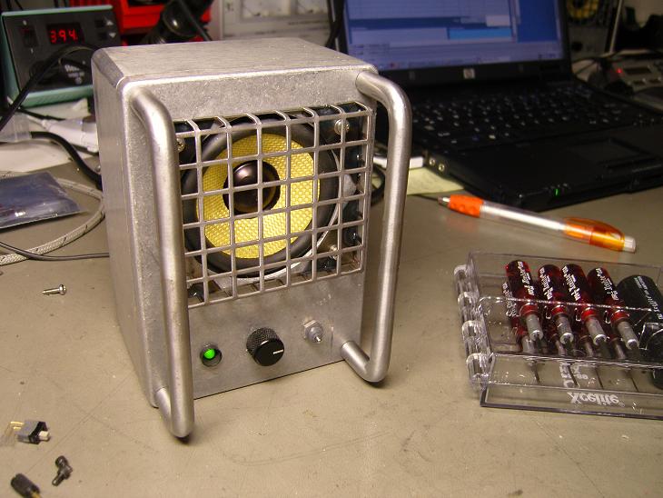

Here is my small speaker based upon that monacor driver:
http://www.speakerporn.com/displayimage.php?album=17&pos=0
I've had my eye on that drver for a while and got hold of one. They're a little bit expensive but very impressive i agree. It rolls off around 150hz
My favourite small driver is the 4" Wharfedale 3038LB. It has the amazing ability to not only give great balanced full-range sound, but also produce great bass form tiny enclosures.
http://www.speakerporn.com/displayimage.php?album=17&pos=2
I have some plots i measured using TrueRTA, i'l try and remember to upload and post them.
The amplifier is the best bit. I've tried tripath amps and i don't like them because the Iq is too high. I've built my own class-d amp using the TPA3001. Iq i've measured with a load conected is just 13mA at 12v. I have a load of new PTH PCBs comming in the next couple of days if anyone is interested. Sound wise i can't fault it, and its soo small! no output filter needed either.
I'l be back with more....
-dave
p.s www.speakerporn.com is my website i'm trying to build. Please register and post some pictures! feel free to link from it.

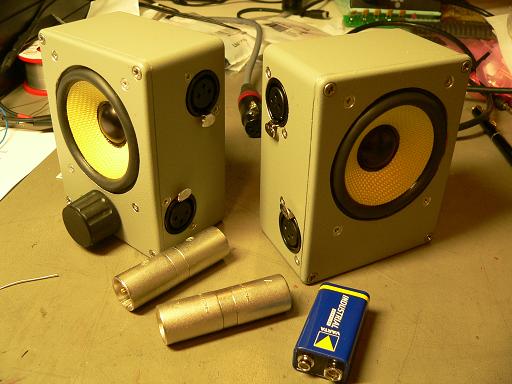

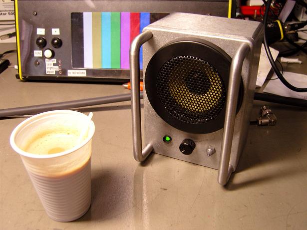

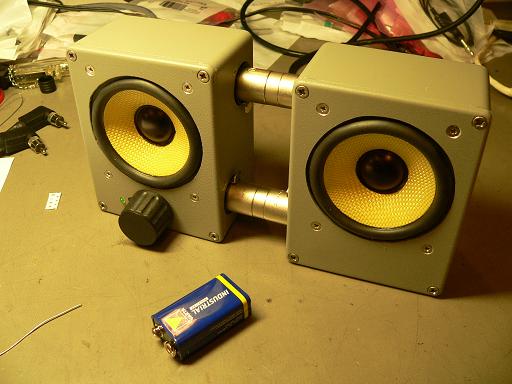

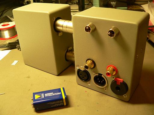

Hey guys,
I have been changing bits and pieces on the design I posted about most recently... (Link to more:http://41hz.com/Forums/topic.asp?whichpage=-1&TOPIC_ID=1917&REPLY_ID=12822)
And I am planning a bedroom soundsystem with addition of a subwoofer.
Still in for a trade Davey T? If you like I can also trade a complete filter circuit, I'm sure it'll make you like the SPH-30X much better!
Latest looks:
