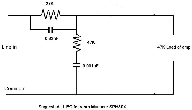

I might have a solution. Looking at the fr graph:
http://www.bmm-electronics.nl/img/Data/hq/sph-30x-8-d.gif
with the many peaks and dips smoothed out helps see a solution.
What's the input R of the amp? I don't think I can totally null it out, but certainly flatten it, and reduce the 20 dB roll-off above it.

Hi, I don't exactly know the input R...10K? I also think the response graph from monacor doesn't comply with reality. The 9.3Khz peak is well visible there though...
The dustcap is 28mm, the voice coil is allready 25mm....
I hear very enthusiastic response about ARTA, will try, thanks.
Than input Z should be 47K, as the gain setting feedback resistor has that value...

Hi v-bro. Try this. The 47K - 0.001 uF should provide roll off above 6khZ
The 0.82nF provides boost at 14kHz. Max attenuation should be about 7 dB @ 9K.
If that works out OK, we can add BSC.
If you change values to taste, change one at a time, they will interact a little.
Geoff

No measurements yet, but I tried your circuit Geoff, nice things are happening with the high frequencies. But voices still could be somewhat more in the background. My previous 2.5Khz notchfilter with added 1nF caps parallel to the input resistor. The latter absolutely enhances the highest frequencies.
But Monacor probably measured the driver in a baffle, they also seem to add smoothing on the graphs. The enclosure I use is far from ideal, so that might need a different type of filter (or same filter, but other values...)
Looking at the measurement I took from the unfiltered loudspeaker it would seem that it would just need bass boost....
Or maybe Z isn't 47K afterall...I'll have to get back to it tomorrow...

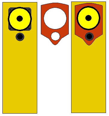

I am definately interested in this driver for use in a cyburgs needle style design. What I don't know is if it will perform especially well in that design without modification, since it is meant for the visaton or tangband drivers. That said people have used it with all sorts of drivers and reported good results so perhaps it is quite universal 😕
Dare I say I like the idea of using a tweeter/supertweeter 😱. Crossed around 8khz it would be outside of the critical band(s) and would give extra high end and help control that large peak at 10khz. The Dayton ND20FB might make a nice tweeter/supertweeter for this. I also like the mounting idea I've pictured, though making that mask would be difficult especially without a router 🙁
I could start a new thread if you'd prefer, this might be going a bit off track.

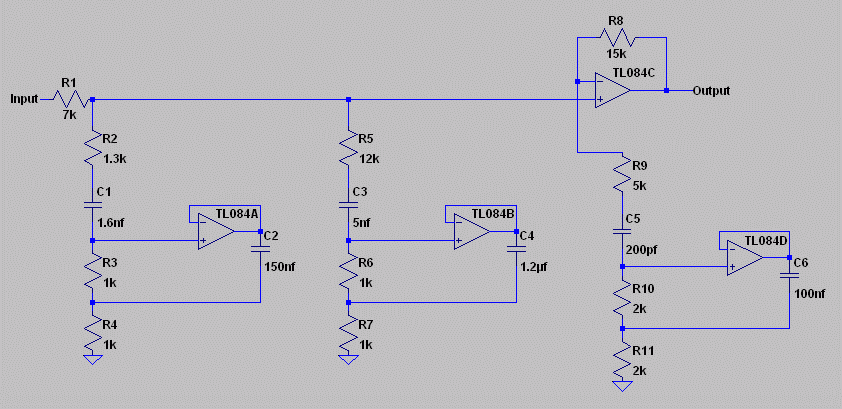

Ok, I finally got one, for experimenting at this stage. Its a decent little unit; high sensitivity, good excursion and power handling, very fast transients and good presentation of vocals.
Shot with EX-Z40 at 2007-07-06
Shot at 2007-07-06

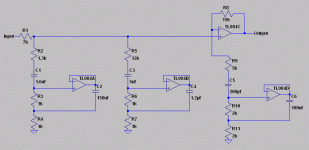

I find run without any filtering the sound is a bit too harsh and forward. I designed a set of filters based on this design:
http://www.madaboutsound.com/bravura_fr125S_speaker_design.asp
and arrived at component values through experimentation on switcher cad based on the frequency response chart of the driver. In practise the filters work well but a little fine tuning is required I feel, still a hint of shoutyness/reedy tone and too much sibilance on some recordings (though that bothers me on most systems I've heard so I don't think its a flaw in the speaker). The filters are attached, you need an input buffer and a low cut filter may be desirable to reduce excursion.
My testing is so far with a thick cardboard tube acting as a TL. It allows the driver to produce some bass but nothing amazing yet. How do you calculate the tube length based on resonance again, does it involve the speed of sound in air? I'd like to try a cyburgs needle for it.
