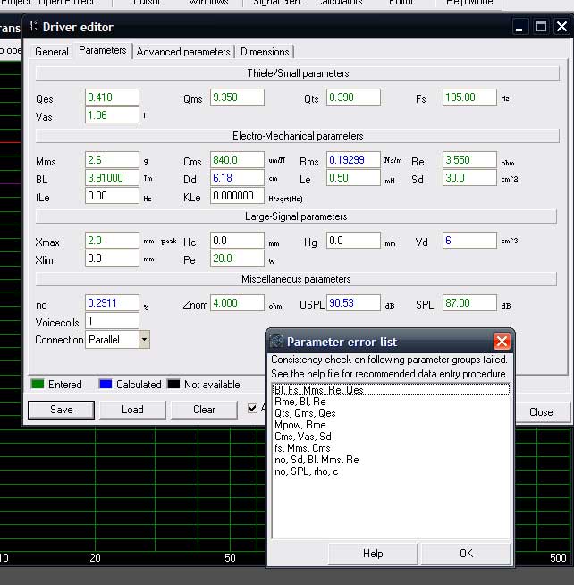

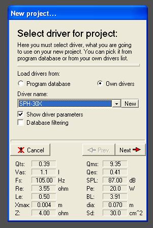

How did you get the driver to work with WinISD?
I tried inputting all the TS parameters, and got the following error (see attached)... 🙁
Could you post up yer wdr file or somethng... 😉

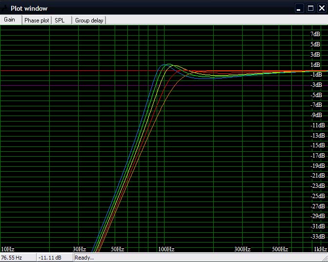

I attach a screenshot of my WinISD data, hopefully it helps you 🙂
Thanks for the screenie - by the looks of it I was using the wrong version os WinISD (I was using the pro version)...
Anyway, I downloaded the non-pro version, and it works like a charm. 🙂
I think I'm gonna go with the yellow line, box tuned to 105Hz, 3.8l box (2 drivers). I'm probably gonna use 40mm waste tube as a port. 😀 :smash:
