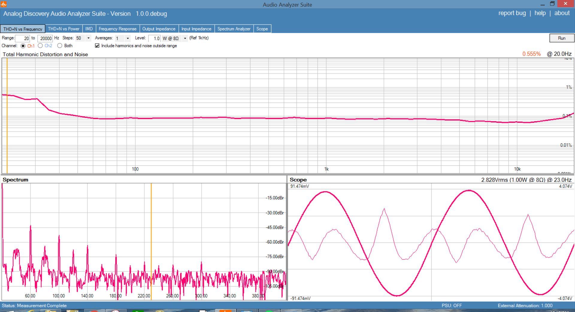

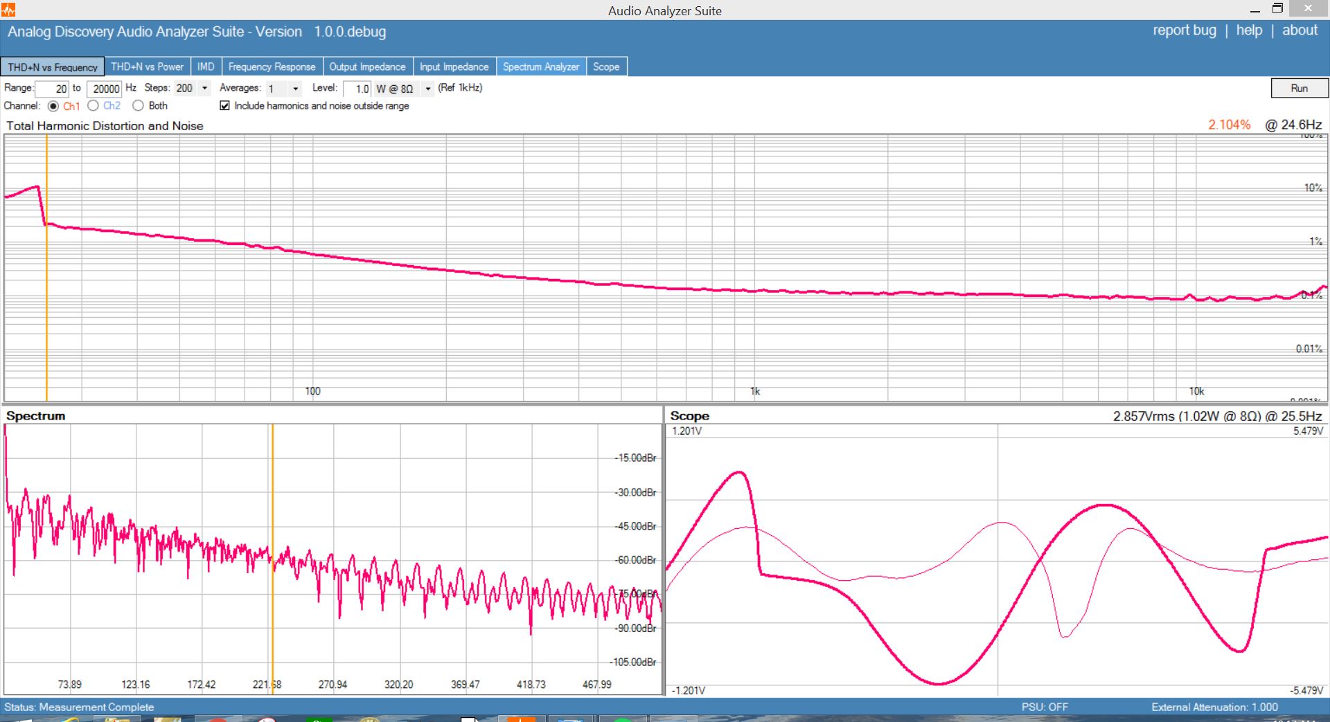

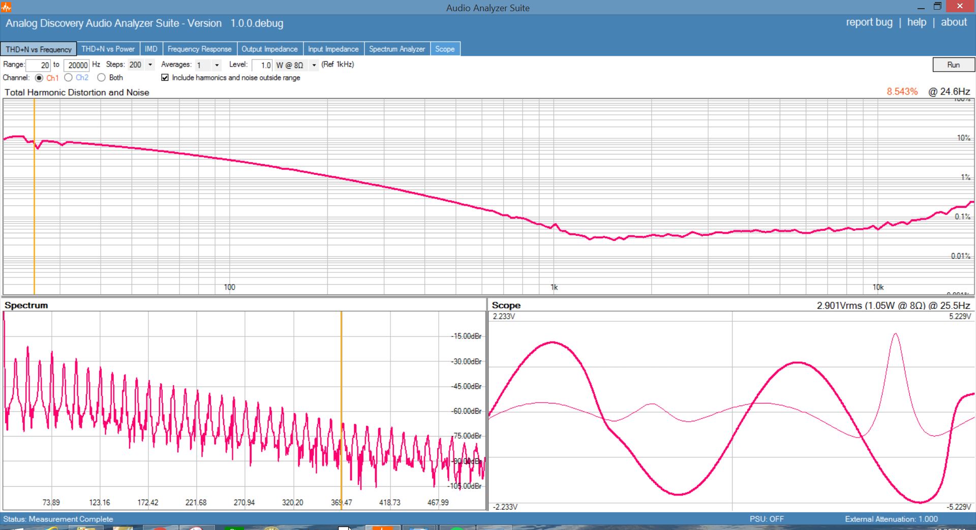

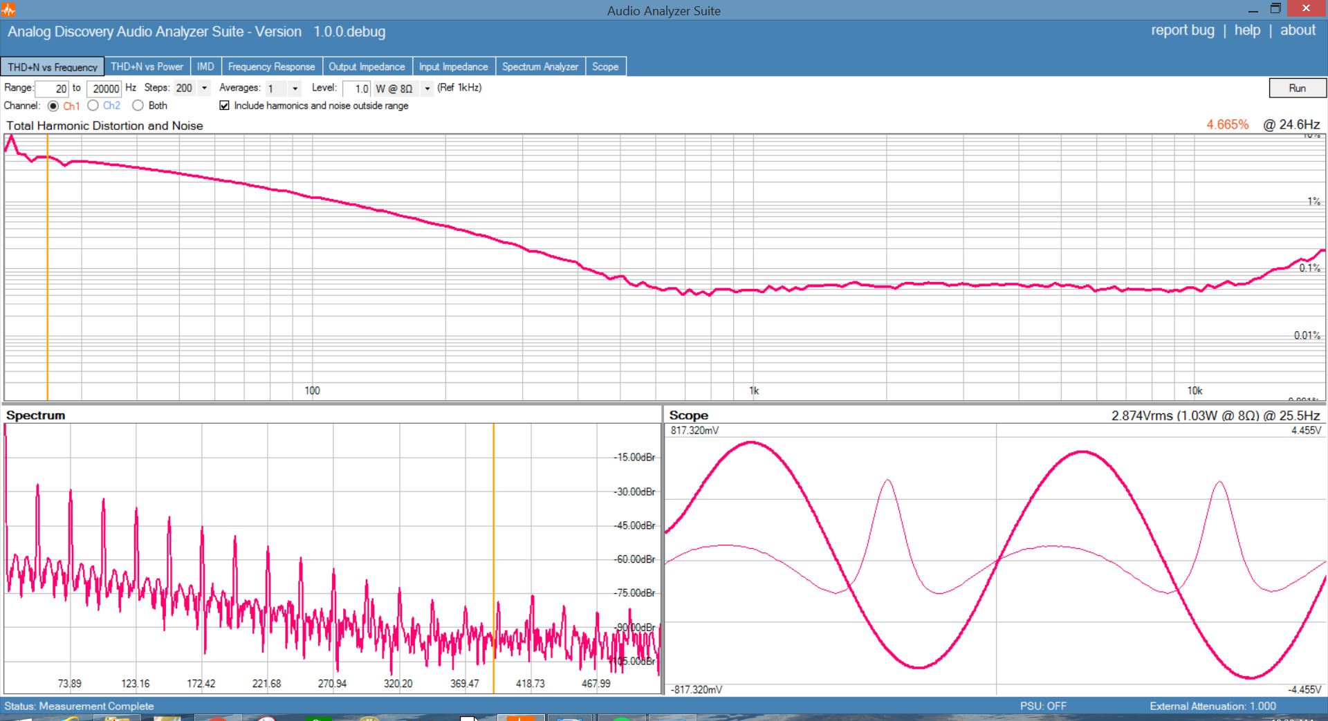

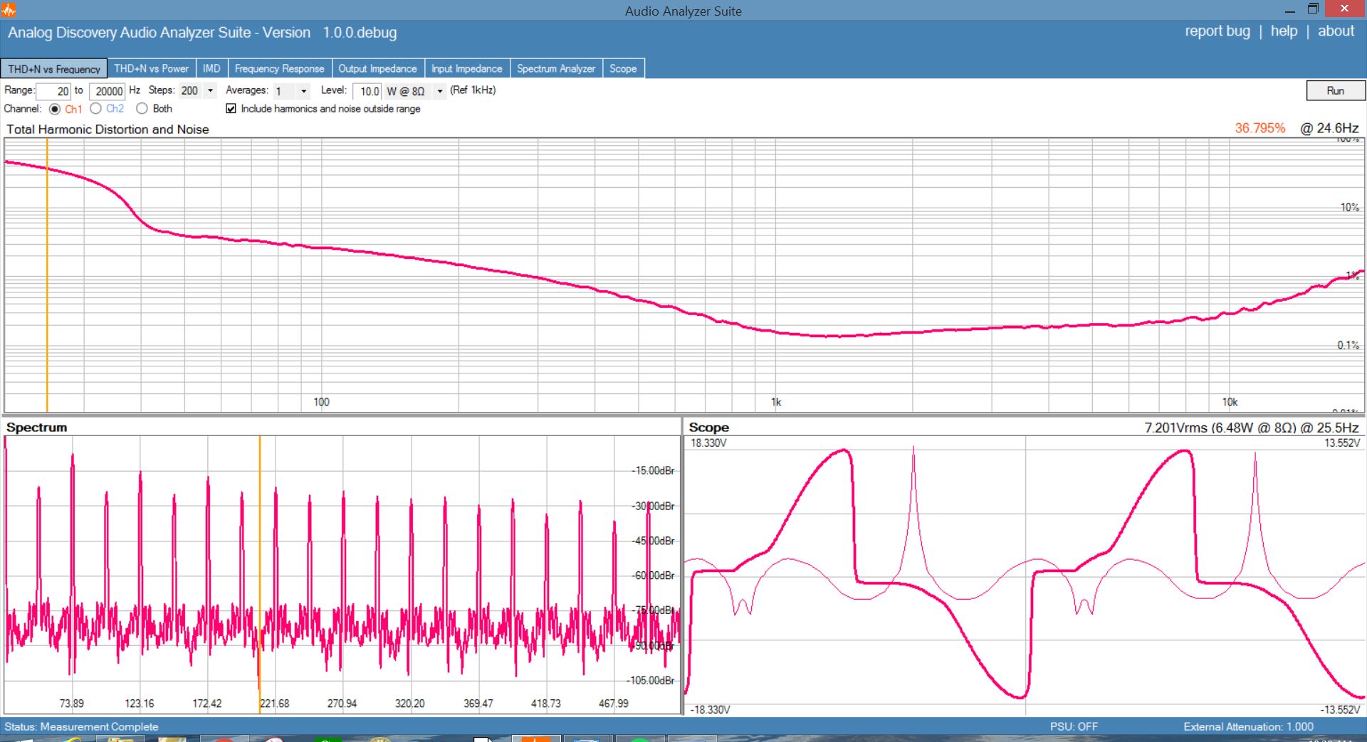

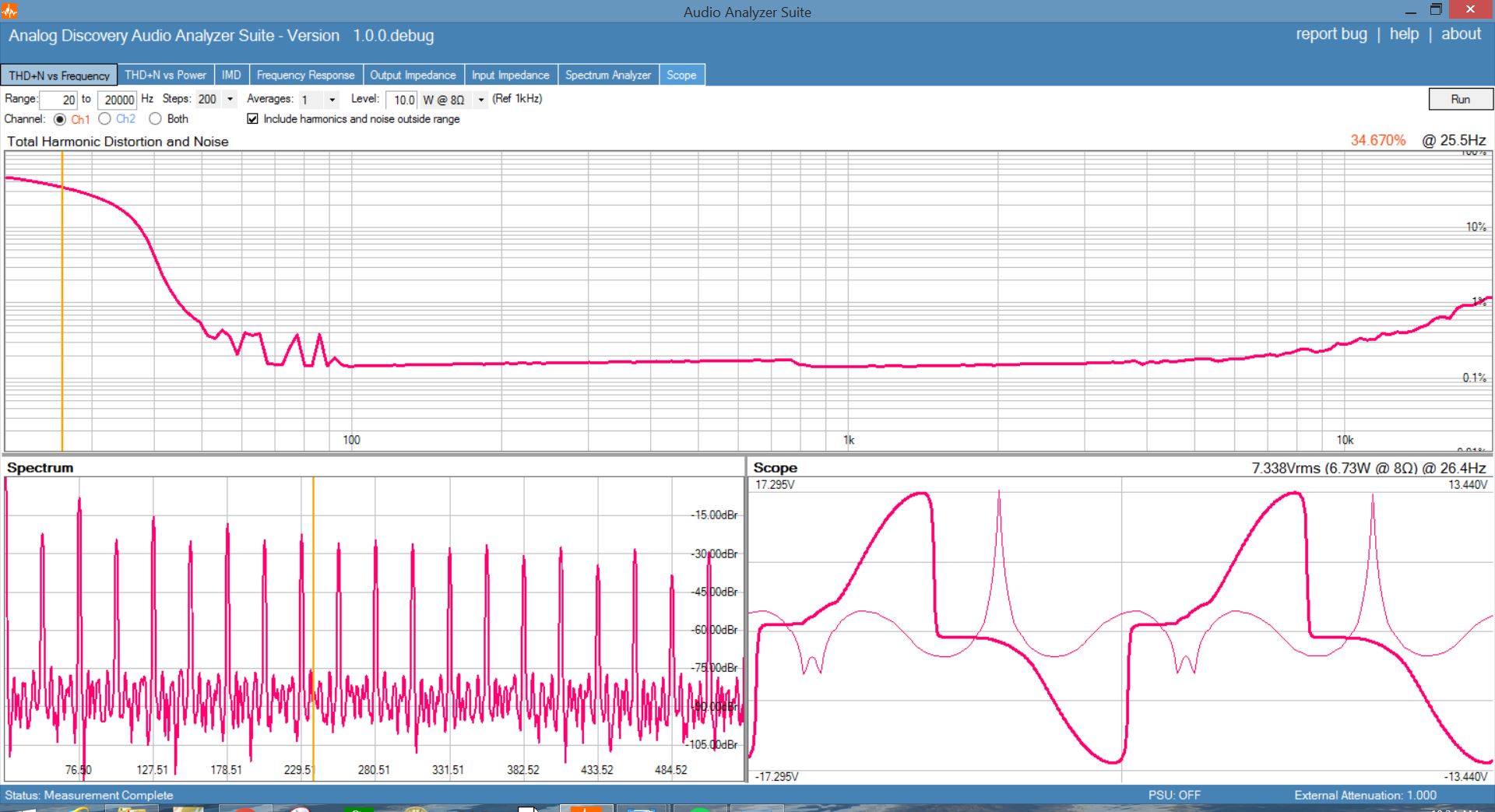

I ran some THD vs Freq tests varying the imbalance between 0mA and 20mA at 1W plus a couple at 10W. I'm attaching the results with some comments. Unfortunately the graphs are auto scaled so it makes it a bit harder to compare them visually, so I am providing some numbers to help.
All tests were at a nominal plate current of 44mA per envelope (i.e. 22mA per section).
0mA - 0.5% @ 25Hz, 0.09% @ 100Hz
5mA - 2.1% @ 25Hz, 0.5% @ 100Hz
10mA - 4.7% @ 25Hz, 1.1% @ 100Hz
20mA - 8.5% @ 25Hz, 3% @ 100Hz, 1% @ 200Hz
I'm also including a couple at 10W output:
0mA - 35% @ 25Hz, 0.15% @ 100Hz
20mA - 37% @ 25Hz, 2.7% @ 100Hz, 1% @ 300Hz
It's interesting to note that at 10W there is considerable distortion below 40Hz that is independent of current imbalance. Core saturation on these toroids?
From your schematic you are using a 9V power transformer as an output transformer. This means that it is designed for 9V on the secondary (about 10 watts into 8 ohms) at a frequency of 50 Hz. With a 10% design margin, the core would probably start saturating at frequencies less than 45 Hz. I have done similar tests with the same result.

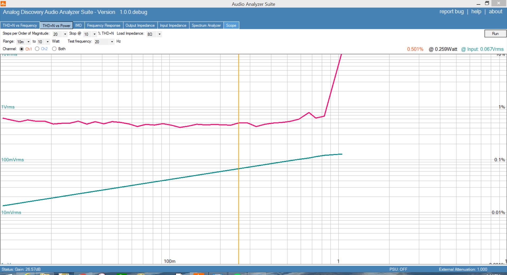

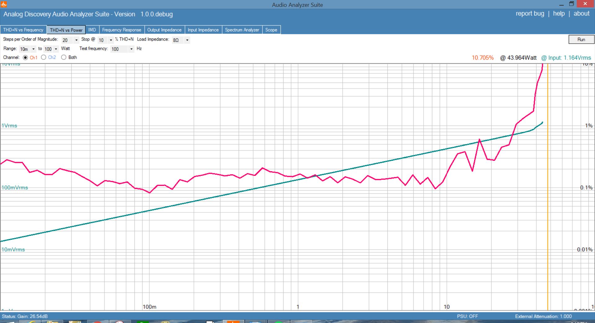

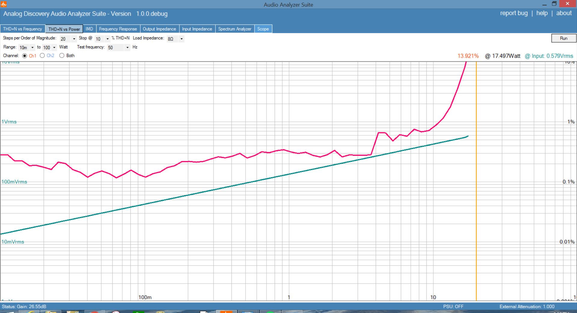

Interesting points. It's a 100VA transformer. I just ran some tests at 20Hz, 50Hz and 100Hz of THD vs power. I'm attaching the results (this is with balanced DC in the OPTs). Note that at 20Hz the THD goes through the roof at about 1W. At 50Hz it makes it to 15W or so before saturating and at 100Hz performance is starting to look like the 1KHz test with decent results up to about 30W.
That all makes sense. To a first approximation the ratio of voltage to frequency at saturation remains the same. So if you halve the frequency you can only have half the voltage before saturation, or quarter the power. Conversely at double the frequency you can double the voltage, or four times the power up to the point where amp clipping becomes the limiting factor.
The VA rating of the transformer doesn't really come into the picture. For a higher VA mains transformer the wire is thicker with a corresponding larger core allowing more current. The larger core allows for less turns per volt so of course the manufacturer takes advantage of this to save copper and the core still saturates at a frequency just under the design frequency (usually 50 Hz) and design voltage.
Thanks for the analysis - what you say makes sense now. I can see that if the transformer is designed for 8V at 50Hz on the secondary (which translates to 8W into 8 Ohms as an OPT) then at higher powers and lower frequencies I can expect to run into core saturation.
