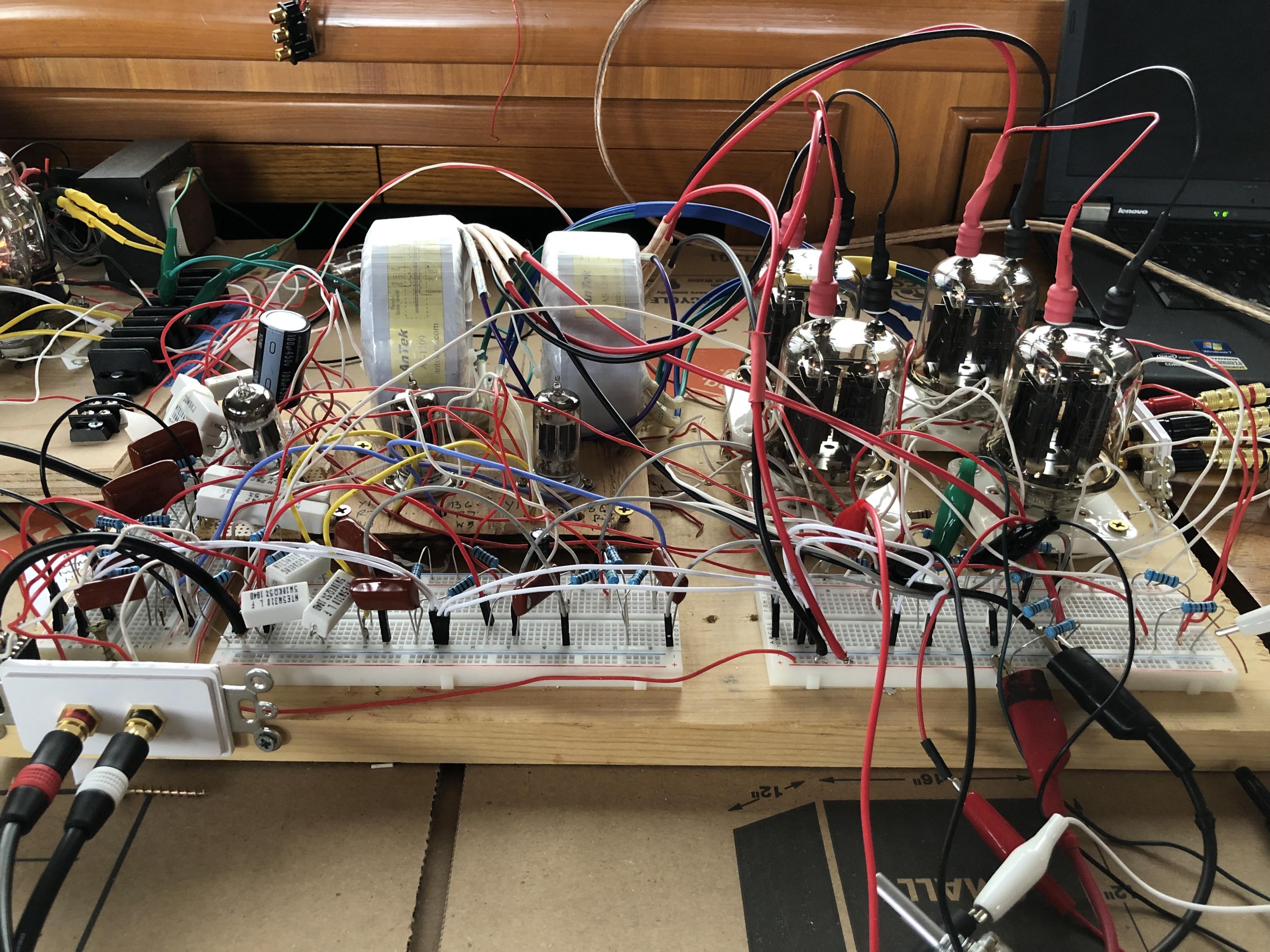

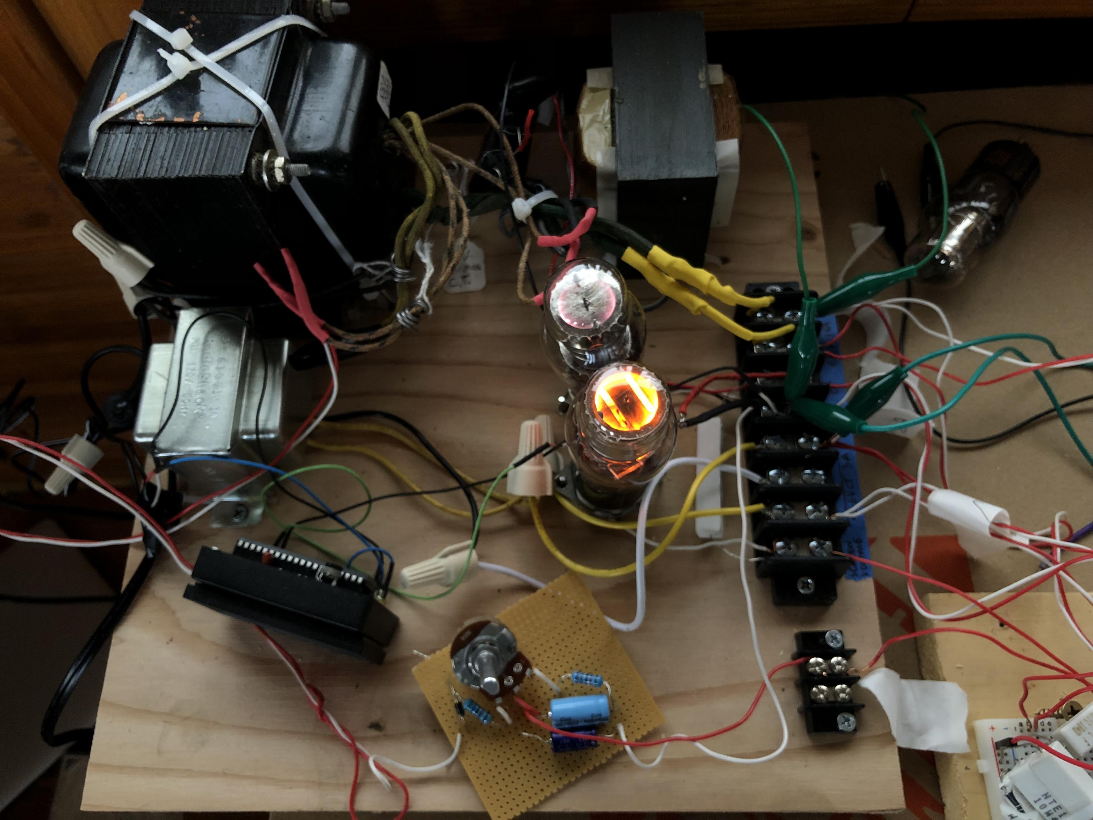

Got it - balancing the cathode currents should get the desired outcome. Given mine is a parallel push pull design I could use both sections of a single envelope together, and then use the cathode current. However, I ended up having a push and pull stage in each envelope.no, just that cathode currents is in direct relation to plate currents,
you are correct to measure plate currents instead with the 832/829b tubes...
if using two bottles, that means 4 plate current monitoring resistors and 4 grid biasing adjustments....per channel...i dropped the idea of making this amp, i have my sights on the bigger tv tubes instead, like the 6hf5/6kd6's....

You could do that. However I am treating the paralleled sections as a single tube - not trying to balance the current between them. As you can see I am using a single pot to balance the bias between the two halves of the push pull. So that means two current sensing resistors and one bias balance pot per channel. I also have one overall bias voltage adjustment since I don't feel the need to balance the channels that precisely.

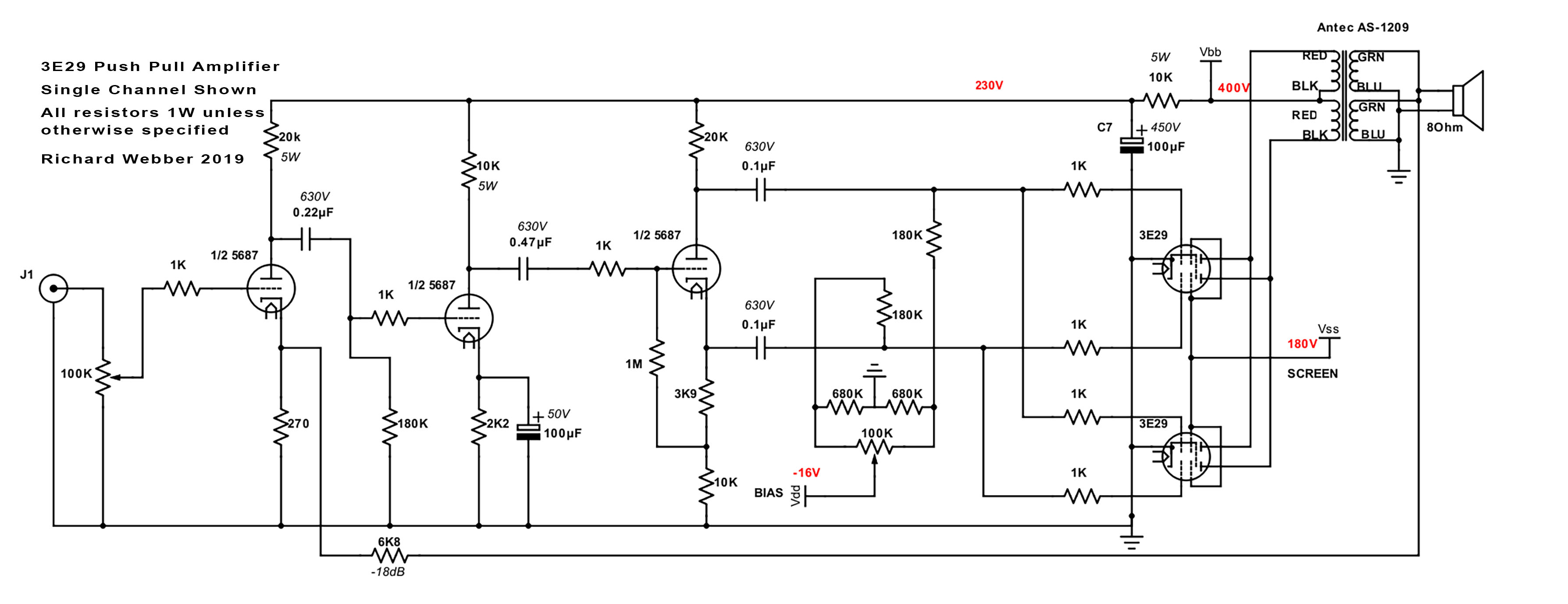

From your schematic you are using a 9V power transformer as an output transformer. This means that it is designed for 9V on the secondary (about 10 watts into 8 ohms) at a frequency of 50 Hz. With a 10% design margin, the core would probably start saturating at frequencies less than 45 Hz. I have done similar tests with the same result.

I have a bunch of 3e29s and 829bs I picked up at Nearfest in NH a few years ago. Im just getting into instrument amp designs and am breadboarding a 12AU7 preamp with MerlinB's excellent Tube Preamps 2nd edition as a ciruit tutorial. I also contest and chase cw and digital dx with over 150 countries confirmed.
I will take the time to look at your postings to see if I can make something useful out of all those NOS pentodes. Did you use 3e29s or 829b in the amp for which you posted the schematic? I was wondering about the much higher max plate of 5000 vdc on the 3e29s, and whether that implied more drive than the 2.5w the 12au7 offers.

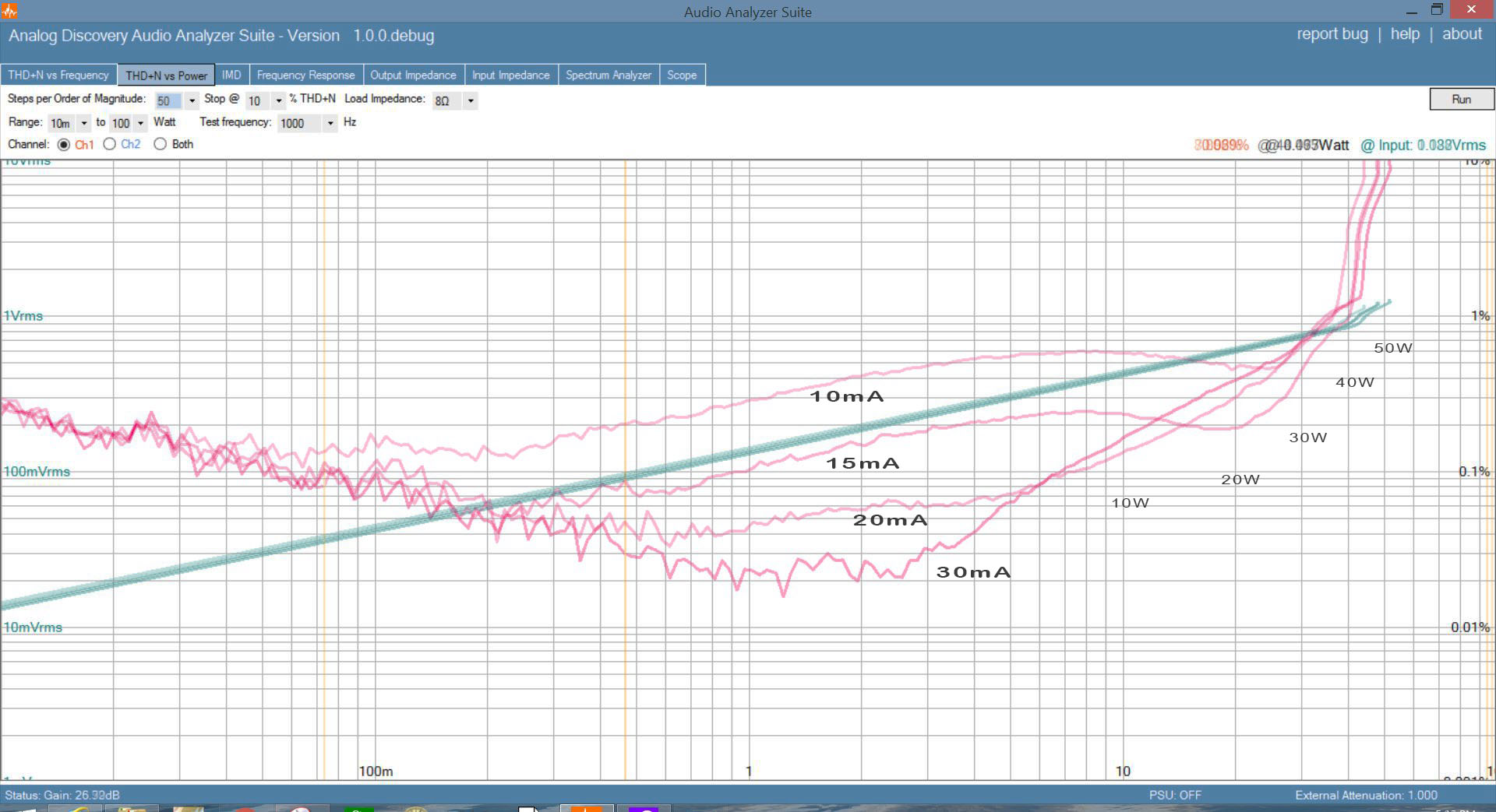

Interesting points. It's a 100VA transformer. I just ran some tests at 20Hz, 50Hz and 100Hz of THD vs power. I'm attaching the results (this is with balanced DC in the OPTs). Note that at 20Hz the THD goes through the roof at about 1W. At 50Hz it makes it to 15W or so before saturating and at 100Hz performance is starting to look like the 1KHz test with decent results up to about 30W.From your schematic you are using a 9V power transformer as an output transformer. This means that it is designed for 9V on the secondary (about 10 watts into 8 ohms) at a frequency of 50 Hz. With a 10% design margin, the core would probably start saturating at frequencies less than 45 Hz. I have done similar tests with the same result.
Thanks! I built mine with 3E29 tubes (as per the schematic) and haven't tried it with 829Bs yet so can't comment. The toroidal power transformers I am using as OPTs are commercial - the Antek AS-1209 wired with the two 115V primaries in series and the two 9V secondaries in parallel (see my original post.)I have a bunch of 3e29s and 829bs I picked up at Nearfest in NH a few years ago. Im just getting into instrument amp designs and am breadboarding a 12AU7 preamp with MerlinB's excellent Tube Preamps 2nd edition as a ciruit tutorial. I also contest and chase cw and digital dx with over 150 countries confirmed.
That all makes sense. To a first approximation the ratio of voltage to frequency at saturation remains the same. So if you halve the frequency you can only have half the voltage before saturation, or quarter the power. Conversely at double the frequency you can double the voltage, or four times the power up to the point where amp clipping becomes the limiting factor.
The VA rating of the transformer doesn't really come into the picture. For a higher VA mains transformer the wire is thicker with a corresponding larger core allowing more current. The larger core allows for less turns per volt so of course the manufacturer takes advantage of this to save copper and the core still saturates at a frequency just under the design frequency (usually 50 Hz) and design voltage.

I've always had better results using triode connection. The lower rp seems to improve LF performance. This is why I'm using 6P45S in triode with 320V B+ and 120mA / tube into 2 250VA coils in parallel. Also, I've never used anything by Antek, just Triad, but I get way more clean LF out of them than you seem to be getting. Too many variables to pin point it without more testing though.
Thanks for the analysis - what you say makes sense now. I can see that if the transformer is designed for 8V at 50Hz on the secondary (which translates to 8W into 8 Ohms as an OPT) then at higher powers and lower frequencies I can expect to run into core saturation.That all makes sense. To a first approximation the ratio of voltage to frequency at saturation remains the same. So if you halve the frequency you can only have half the voltage before saturation, or quarter the power. Conversely at double the frequency you can double the voltage, or four times the power up to the point where amp clipping becomes the limiting factor.

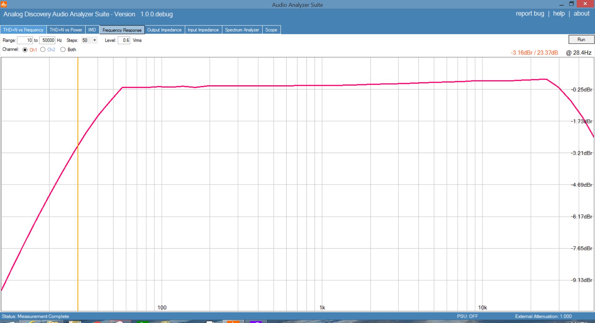

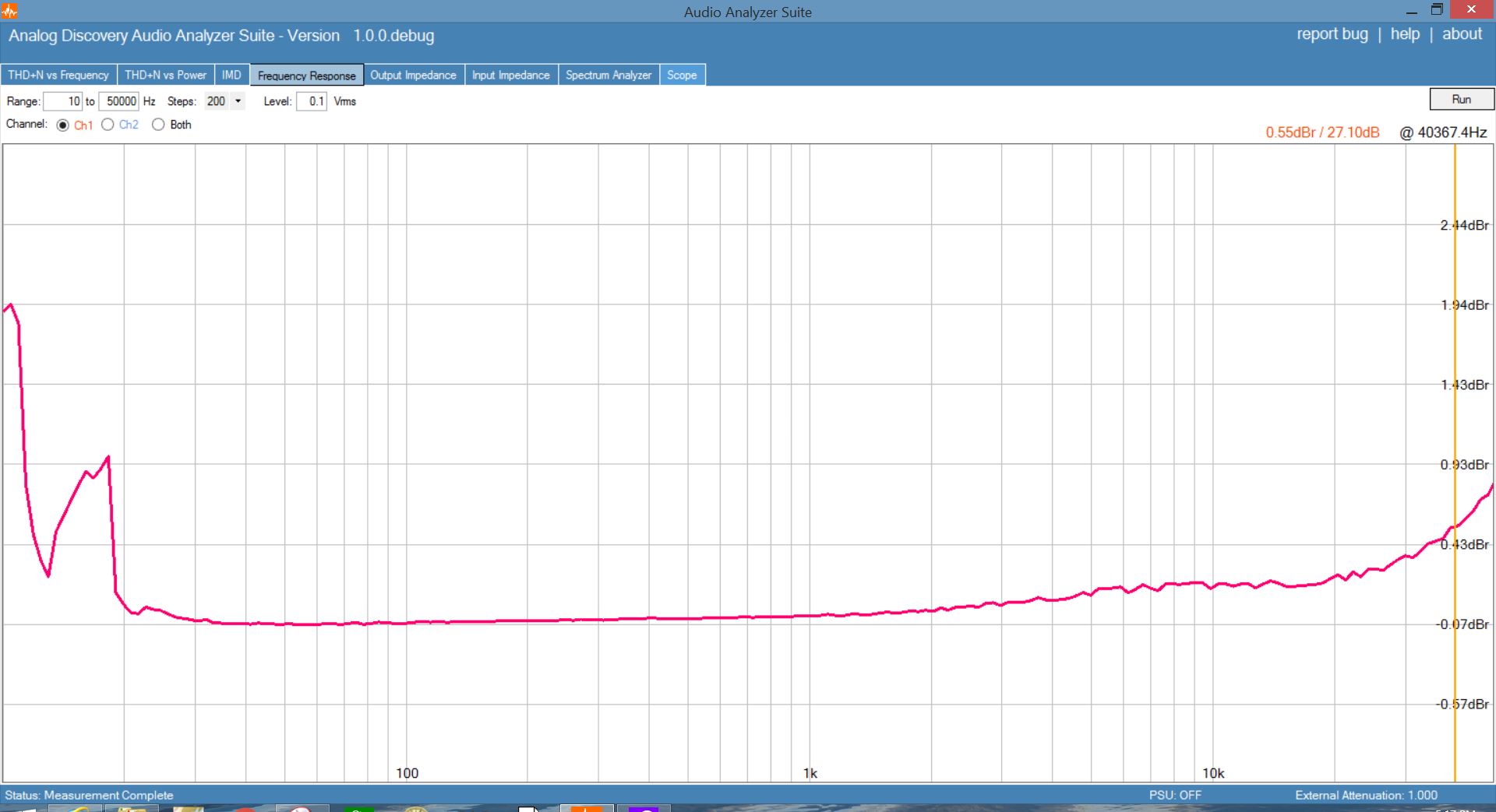

Today I did a few inductance measurements on a cheap(about 10 British pounds) 50VA toroidal transformer available from Rapid Electronics:
35V AC excitation 166H, 6V AC excitation 140H, 1V AC excitation 84H, all at 50 Hz mains frequency.
I have seen doubt expressed as to the suitability of mains toroids at low signal levels; these measurements seem to remove doubt for this particular transformer.
Just a reminder, the grid leak resistor of each half of the 829b should be less than 100k or less than 50k if you parallel the two valves together. The 829 wants to oscillate badly so neat construction and short wire lengths are of paramount importance.
Kobamx, i now use 190 volts for the screens and everything works better without oscillations, i did tried 220v but it was too much for my liking. BTW the sound is excellent, i am rediscovering my old music again.
