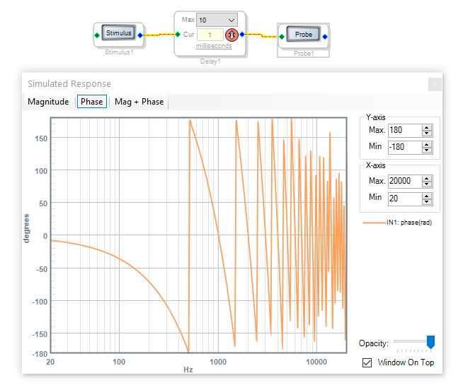

I found a rather shocking bug in Sigma Studio.
When there is a fixed time delay like 1ms or 1 second in audio signal across the board from 20 to 20kHz, the phase response graph should show a declining straight line,
as 20ms at 20Hz is:
0.02 / (1 / 20) x 360 = 144 degrees or 2.513 radian
20ms at 400Hz is:
0.02 / (1 / 400) x 360 = 2,880 degrees or 50.26 radian
20ms at 800Hz is:
0.02 / (1 / 800) x 360 = 5,760 degrees or 100.53 radian
and 20ms at 20kHz is:
0.02 / (1 / 20000) x 360 = 144,000 degrees or 2513.3 radian
But below is the phase response graph of a 20ms delay on Sigma Studio Version 4.6 Build 0 Rev. 1812:
The line on the graph appears as a declining curve instead of a straight line because the X axis scale is logarithmic, which is correct. But despite the graph indicating "radians" on the Y axis and "IN1: phase(rad)", the Y axis unit obviously is Degrees and not radians, as you could see by comparing the above calculations to the graph.
Apparently this simple but serious bug has been there since 2018:
SigmaStudio Probe phase units: Radians or Degrees? - Q&A - SigmaDSP Processors and SigmaStudio Development Tool - EngineerZone
Shame on you, ADI.
Moreover, the circled area in red on the graph is totally wrong as:
20ms delay at 1000Hz is:
0.02 / (1 / 1000) x 360 = 7,200 degrees or 125.7 radian, not even close to about 5000 indicated on the graph.
In any event, it is important to remember that a fixed delay across the board 20-20kHz appears as a declining straight line (or a declining log curve on a log scale), which does not degrade the sound quality.

The delay control in SigmaStudio certainly has some bugs. I’ve managed to work around most of its problems if I follow these steps:
-Drag the control on the schematic field. Immediately change from “Samples” to “milliseconds” and then set the maximum value. The drop down maximum value list should be from 1 to 43 milliseconds (this may be sampling dependent, I’m sampling at 48 KHz). Then set your delay time and wire it to your schematic.
- If the max value ever goes blank (as in your post #68) the control is messed up. The only way I can recover is to delete the control, save the project, reopen the project and start over.
- I always get the wrong response the first time I click the Stimulus (first attachment). The second time I click I get the expected response (second attachment).
A few notes:
1. I’m not sure why I get degrees while you get radians for phase. I’m using Version 4.5, Build 0, Rev 1779 dated 10/28/2019.
2. In the second attachment each phase wrap (-180 to +180) trace should go all the way to the edge of the graph. The “Probe” control doesn’t plot at small enough frequency steps to catch the exact wrap frequencies.
3. The third attachment shows the same delay with phase unwrapped.
Hope this helps…

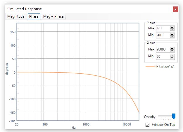

Yes, indeed. Thank you for the tips. In trying the tips, I found the radian vs. degree option, too, but was struggling how to screen capture it. Did you use keyboard shortcut keys?
I got the following after clicking Stimulus twice and selecting degrees, and clicking for the 3rd and 4th time did not change it at all:
Note: Apart from the odd scale automatically selected for the X axis, it says "IN2: phase(rad)" and 'degrees' indicated on Y axis.
So we need to keep in mind phase areas of Sigma Studio are riddled, or at least sprinkled with bugs.
This goes back to the question, "How reliable are these figures/graphs?". I guess I need to rely on my ears to be the judge.
I used the Windows snipping tool. I set the delay for 5 seconds, clicked on New and then right clicked on the graph and then selected Phase options. At that point wait for the delay to time out.
Your phase graph is correct for the 1 Hz range (279 to 280 Hz). Just change it to 20 and 20000 Hz. I also noticed that the IN2 legend always says "phase(rad)". Small nit if the graph is correct.
