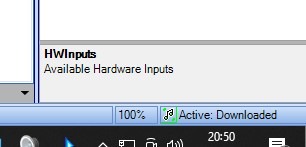

Dear Yiba, I have a 21489-based board, it works fine with the proprietary software, but when I go to sigmastudio, even though all seems correct (USBi green, active downloaded ...) I always obtain 0 cells and 0 algorithms in the link project tab. No errors in the error/output tab. Do you have suggestions to solve this problem?
Thanking you in advance
Antonello
