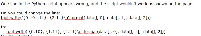

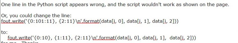

:cop: Moderation Edit the string in the code tags is still incorrect. Something odd going on with the forum handling of this.
For now see image in following post.
By changing TEST_RESPONSE on the 3rd line in this script to your file name, saving the above as whatevername.py in the directory where your file is, and running it as a Python script (by entering 'python whatevername.py' into a Python enabled shell) converts the REW file into Sigma Studio format, and saves it as yourfilename_MLSSA.txt in the current directory. Running a Python script is easy for Linux users(make sure you have numpy installed), and not so easy for Windows users.

:cop:
The text seems to change as I refresh the page. Make sure you use what is shown in the image below. The forum software handles interprets a certain sequence of brackets and letters as 'Strikethrough' I am told.
Text string should read as follows:

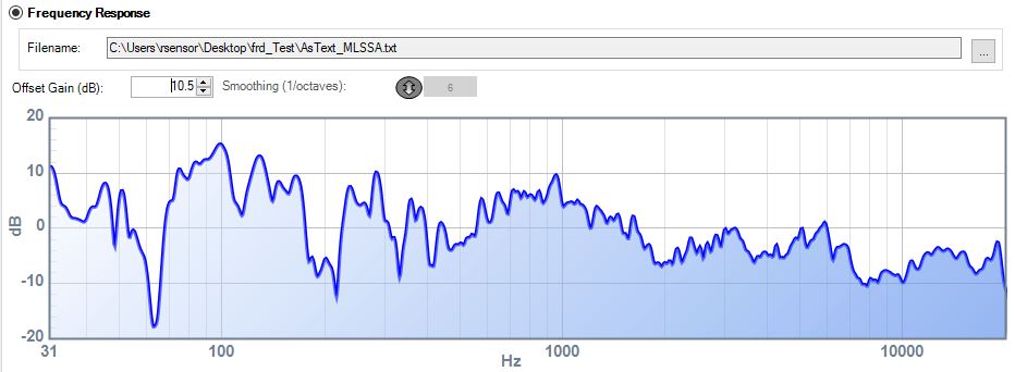

Could you post the .frd file that doesn't work with frd2mlssa? I can certainly look at it.
Also, I think the AutoEQ control has some (unstated) maximum number of data lines that it can handle. I once imported a file that went up to 96 KHz: it seemed to import OK, but the AutoEQ control would constantly throw exception errors when I tried to do anything.
Sure, but .frd is no longer supported by REW.
Did you code frd2mlssa? If so, you may be the solution!
The only export options available on REW v.5.20 are .txt and .frq, and .frq is a MLSSA binary format (SigmaStudio should accept this, but it does not). So I'm stuck with .txt.
On the left is .txt as exported by REW v.5.20, on the right is the output of frdmlssa.cmd.
The conversion looks nice and neat, but nothing shows up in AutoEQ graph of SigmaStudio, although it does not throw an exception/error when this AsText_MLSSA.txt is loaded.
I don't know what the data length limit on AutoEQ is, but I have always followed 3eAudio instruction of 96 PPO (points per octave?) which results in 900-1100 lines in the file depending on the measured frequency range. I have never had problems with this resolution with the Python conversion.
Yes, I wrote the frd2mllsa file. In REW choose the "Export Measurement as text" option. From there you can save it with any name and file extension (.txt, .frd, etc.) you want, it just defaults to .txt. REW writes the file in FRD format, regardless of the file extension used. So feel free to post the .txt file.
Oh this is great.
Sorry, I misunderstood what you meant by 'post', I thought I did post it above (my english bad, ©drMordor). I'm attaching 3 files:
AsText.txt - File created by "REW>File>Export>Export measurement as text"
Python_MLSSA.txt - Above file converted by Python
AsText_MLSSA.txt - Same file converted by frd2mlssa.cmd
The difference between the Python conversion and the frd2mlssa.cmd conversion may be clear in the following capture of Brackets editor. On the left is the file that works in AutoEQ, on the right is the frd2mlssa conversion that does not work in AutoEQ:
I don't know if ".frd format" is loosely defined, ADI interpretation is different, or the format was changed at some point in the past (and the Python code followed the change?). But in any event Python_MLSSA.txt is accepted by SigmaStudio, and AsText_MLSSA.txt is not. Your help will be much appreciated.
Well this is getting strange. I downloaded your "AsText_MLSSA.txt" file and it loaded into the AutoEQ control without a problem. See the attachment. I'm running Windows 10 Pro and my SigmaStudio version is 4.5, Build 0, Rev. 1779 dated 10/28/2019. Maybe someone else can try loading it into the SigmaStudio AutoEQ control.
I don't do anything with the end of line characters in FRD2MLSSA. I checked and the downloaded "AsText_MLSSA.txt" file has CR-LF (Hex 0D, 0A) to terminate all lines.

Hmmmm, strange indeed.
As my SigmaStudio is Version 4.6.Build 0. Rev. 1812 dated 12/28/2020, I thought THIS must be the difference. I tried loading AsText_MLSSA.txt one more time, and nothing appeared on the AutoEQ graph. Since there is no "Error occurred loading..." message displayed, "not accepted by SigmaStudio" may be a wrong statement. "SigmaStudio accepts it and fails to convert the data into an AutoEQ graph" may be more accurate.
However, with my "not trusting" attitude stronger with your input, I tried loading another .dspproj with different components/blocks, and AsText_MLSSA.txt loaded fine into AutoEQ and the graph appeared! Aside from the different blocks, the two projects are different in system sampling rate fr-, 48kHz on this project that displays AsText_MLSSA, and 192kHz in the project that doesn't display the graph.
This really is weird. We may be talking about a bug in SigmaStudio. I can't remember where I got the "end of line must be LF" info (may be Arduino folks), but you're right CR+LF works.

REW alone can show us frequency response of our audio system and the listeningroom in easy-to-understand graphs. AutoEQ can tell us what is theoretically best to counter the dips and peaks in the graph. Only when a good DSP is combined with the two, we can actually experience the sound quality difference in a variety of 'corrections'. And this combination is what's now available to us as discussed so far.
My recent experience in applying elaborate AutoEQ filters with strong boost levels up and down, and many number of filters that are often overlapped in frequency ranges to achieve what's best according to the extremely clever calculations, tells me that "as close to being flat as possible" does NOT give me the best listening pleasure.
But the ability of ADAU1701 to apply such strong corrections without making the sound feel artificial, distorted or unnatural is truly amazing, especially when the DSP system sampling rate is set to 96kHz and above.
