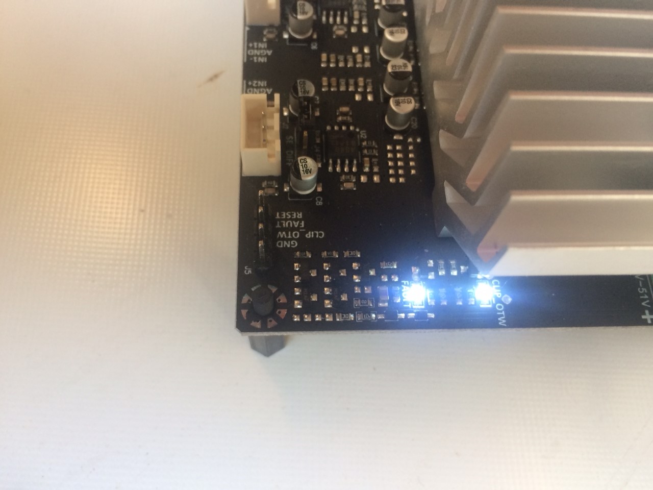

Hi all. I had a problem testing my system - All went well with the set up but just as I was about to pack it up and clear my table before my other half came home it stopped working. Fault light and clipping light came on! I tried connecting reset to ground then fault pin to ground but to no avail. Don't know what I did, the only thing I was playing music (quietly) bot only one speaker connected ( I did read somewhere you should have a load on the amp when on) so don't know if that has anything to do with it? I turned it off at the mains for 10 minutes but just came back on with the faults lights on. How do I reset it or have I somehow screwed it? Help?

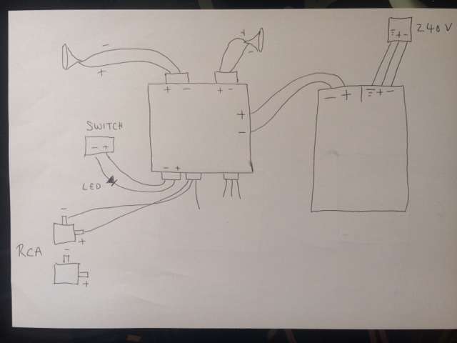

Before you do anything else, get a pen and some paper and draw a schematic of exactly what you have hooked up to it. If you need further help, post it here...

Diagram of wiring at the time - can't wire it back up again until tomorrow but will try as you say and see what happens. (My fault to ground was only for a moment so hopefully didn't do harm)

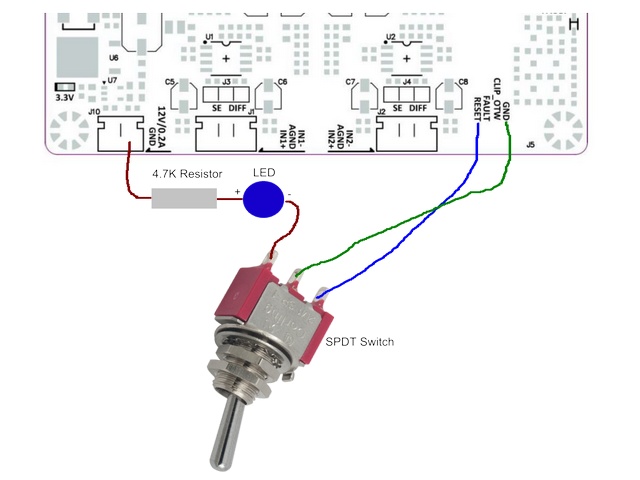

For the record previous to this I had the rest pin and ground pin hooked up to the switch (DPDT) which all worked well so was very pleased thanks for that idea Doug). I disconnected that side of it and was making a cuppa when it went quiet and fault came on. Anyway, Looking at spec sheet think it may be some sort of over heating, anyway will try tomorrow and see what happens.
From the drawing and explanation I don't think you have that standby switch sorted. See the thumbnail. It should be exactly that simple.

Hi Doug, thanks for getting back to me - I think my diagram caused a little confusion. I did have it all wired up correctly as per your original thumbnail and it worked perfectly. It was only after that I realised my old toggle switch had a bad connection on on e side ( it is a Double throw as that is what I had) and to be sure I just connected the 12v led side without the reset pin so the amp continued to play music quietly while I used the switch to turn on/off the LED to confirm the switch had a bad connection on one side. After that with the amp on and the switch in the on/led on position I started to make a cuppa when the amp died (hope that is not to confusing.
Anyway, hooked it up again today as you said without inputs connected and it just came straight on with the fault/clip lights on (Boo!). measured input which showed 51v which seemed high as PS was not turned up full (it showed 46v when I first hooked it up) The reset pin was 3.09v. The speaker offset I'm not to sure about - I think it showed 0.0 on one side and 0.3mv on the other? Turned amp off and left it for 20 mins (which may not have been long enough) and turned PS down to 45v before turning it all on again with inputs connected - same fault/clip lights !!! Very disappointed given it had been working so well. Not sure what I can do?

The clip light (Clip-OTW)seems to be due to Thermal warning which confuses me even more as it comes on instantly. I can;t find how you use the fault/clip pins next to the reset pin? Does anyone (don't want to put it all on Doug) know what else I could do to reset the amp board? I'm generally good at working out DIY problems including household appliance electronic etc but with electronics like this I really don't which is really frustrating especially as it had been working perfectly before.
They appear to be outputs for external LEDs.
