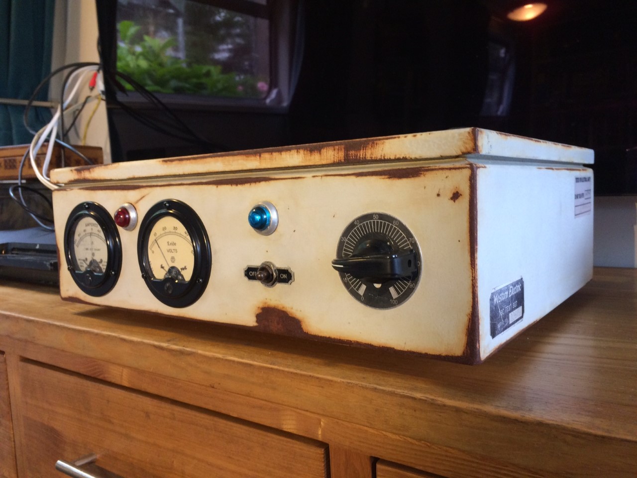

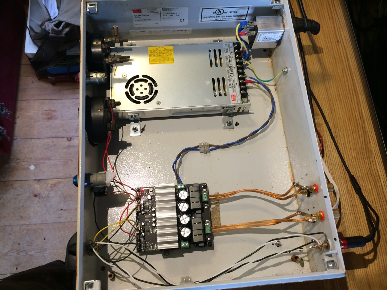

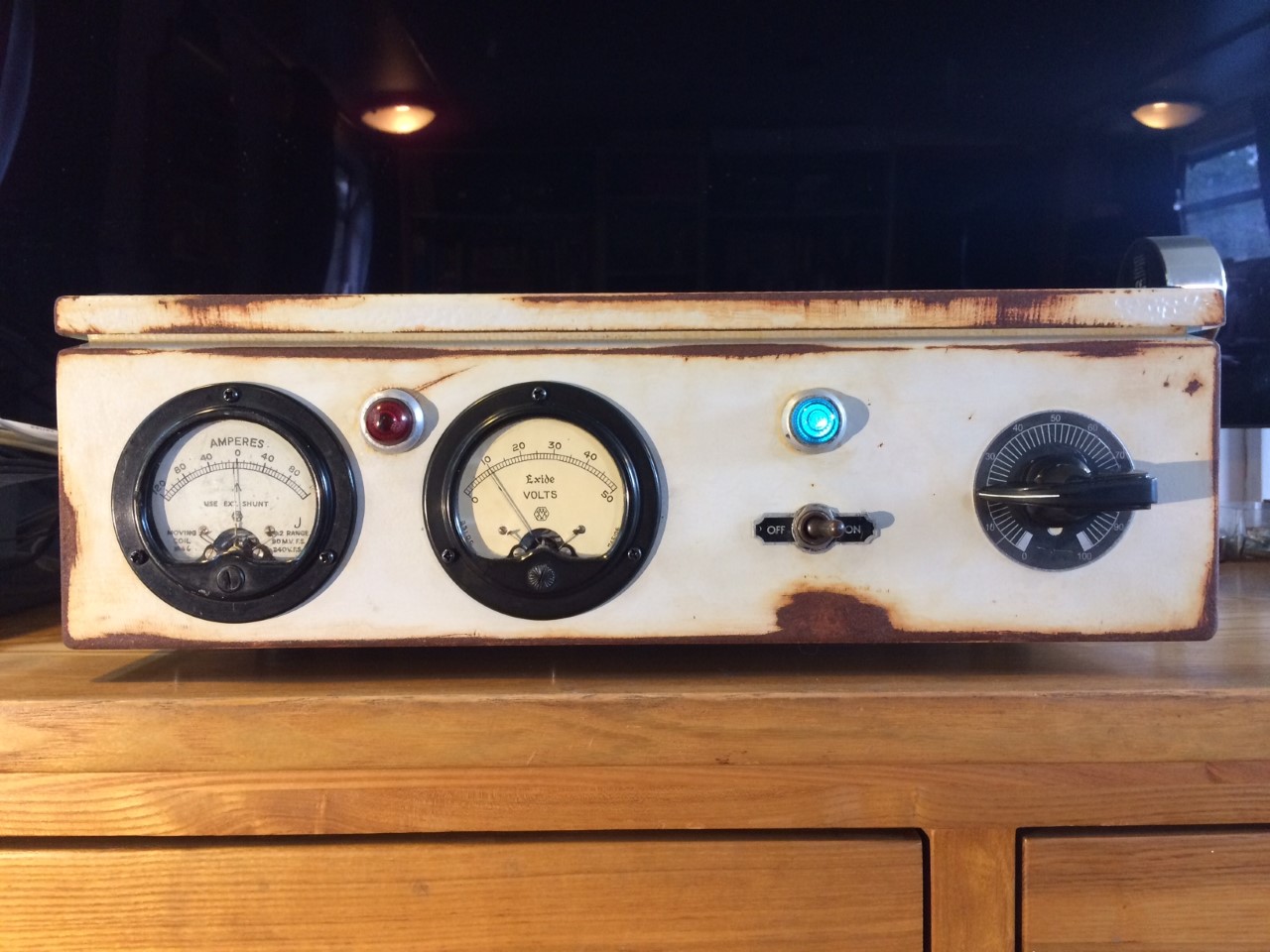

To anyone who happens to read this I got my replacement amp and finished my build. Not to everyones taste but I love the old look so I love it. Thanks again for everyones help.
That is superb! Is the distressing/ageing real, or did you create it?
Thanks. I made it - lots of time during lockdown - got a 'steel wall box', rubbed the paint off parts of it, left it outside for a few days in the rain (kept spraying it with salt/vinegar.hydrogen peroxide mix to speed it up), the meters and switch from fleabay, lights off a 1940s hotrod, sanded down chicken head knob to take the shine off, volume dial is metal, sanded to fade it and a couple of printed stickers and away I went. Certainly grabs peoples attention when they walk in and see it!!!
Thanks guys, haven't stopped listening to it since I did it - was a lot of fun to make and I learnt a lot ion the way - might add radiation icon tomorrow just to make my life complete
