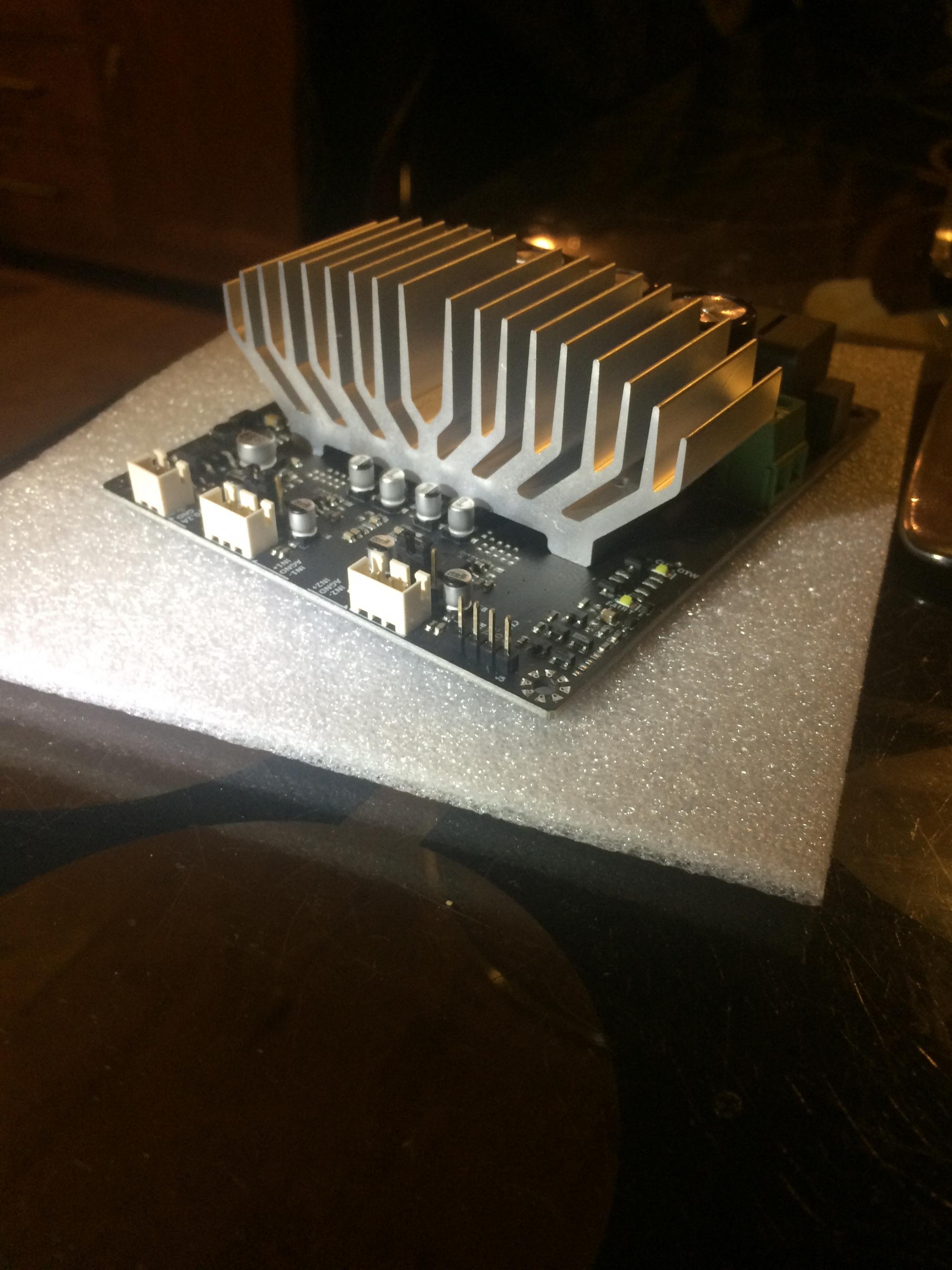

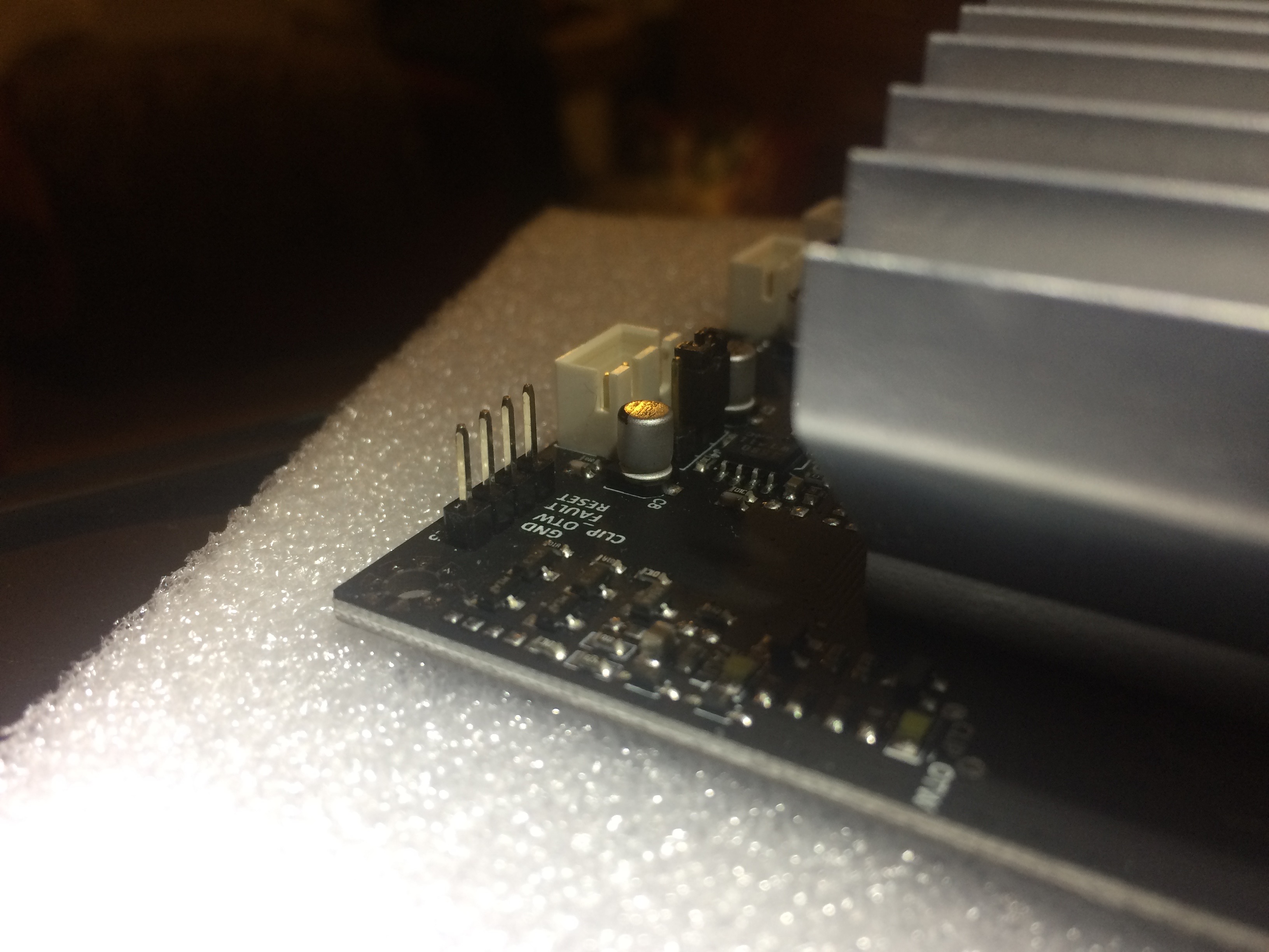

Looking at DrMordor's pdf file it looks like the reset pin is brought out to a single row connector at the edge of the board. All you should need is a SPST momentary push button between the reset pin and ground.
Ah ok that makes sense i think (I'm a beginner at all this!). So the reset pin and the grd pin in the photo?

Looks like it. The PDF appears to suggest it... so go for it.
You will need a connector some wire and a switch.
For the first test just take a mid-value resistor, 2.2k, 4.7k something like that and touch the wires across the two pins... see what happens. If you don't get an immediate lesson in using fire extinguishers, it should be okay.

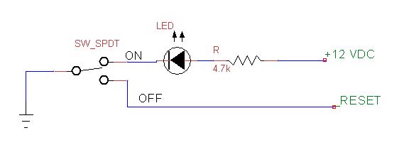

and as the reset carries 3.25v if I get a LED and wire in as per your diagram this should work as the LED will go off when in reset (low/standby) as when reset grounded there is no voltage from the reset pin which will work nicely for me to see whether or not it is in reset (LED off) or in high/working (LED on).
I'd be careful with that... the reset is an input, you don't want to draw current from it. As luck tends to go the LED could/would draw just enough current to make the reset unstable causing sporadic shutdowns and start ups.
It is better to follow my original plan using a SPDT switch and the +12 helper supply to alternately ground the ON led or the reset...

Ah ha, I get the reset idea - I was struggling with it as I said but hadn't realised the wiring of the switch has the ground on one side and either reset or 12v on the other- yep I see how that works now rather than just reset and ground as I had.

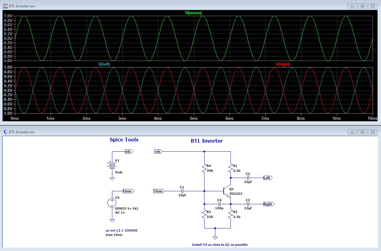

It can be extremely simple, as the thumbnail shows...
That's 4 resistors, 4 caps, 1 transistor ... it could be built about the size of a postage stamp on perfboard and would cost about $3.00 to build. You will, of course, need 2 for stereo.
What it does is take the single ended signal from your volume control and convert it into a balanced signal for the module. VLeft goes to the + input, VRight goes to the - input... easy peasy.

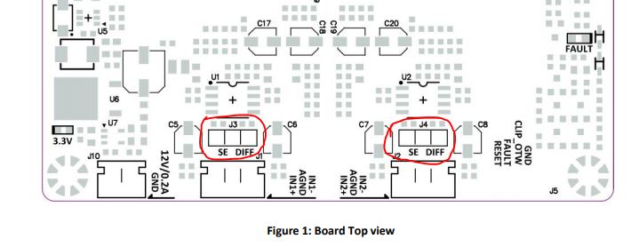

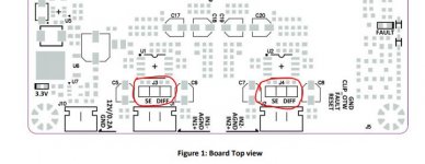

I have the 3e 3255 stereo amp. Jumpers used to select SE or balances input.
I have a passive preamp....dact type volume control and an input select. Works great.
Thanks for that ... I missed it... The PDF doesn't describe this feature, but it is shown on the board picture... so moving a jumper solves the problem. I like that.
