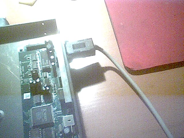

I got that one solved pretty quickly.... the viewframe panels usually come with 3 fans inside each 40mm
you just replace the one that is bad, a matter of eliminating..
you can find them in all computerstores i supose, however i got mine online at www.xoxide.com
i also improved the original design by adding thin rubber washers between the panel and the fans. if you need extra info, i will post the pics i made from the transition.
I also got some new 'filter' material that my wife bought in a dollarstore , it some kind of sponge but perfectly suited...
now i have a panel with a PINK dustfilter!!!!!

amnesia (zwaar weekendje achter de rug!)
ok here are some pics
i took some of the screen i made with the black out cloth
i also took one of the diy projector with the 2 LOA's fluorex lamps but as previously mentioned here, my digital camera is a AIPTEK pen and is not really suited for HQ pics
and then some pics of the panel i fixed
one of the fans was replaced by a new 40 mm one (the thin one in the picture, i placed washers between the body and the fans. the washers are made of a mix of felt, carton and rubber = they eliminate any vibration being transferred to the body of the panel.
also you can see the cable i homemade between pc or tv3000 and panel.
