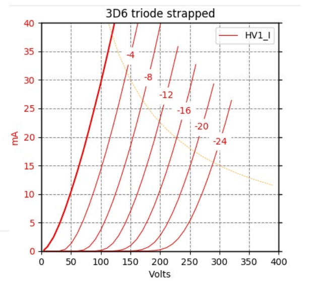

Mu about 9 timesThat’s good to know. Thanks for sharing! What’s Mu of 3D6 in triode operation?
Then plate resistance is close to 4k ohm per tube. I wonder what would be the optimal load? Would it be better to go for higher than 8k ohm for the differential circuit?Mu about 9 times
Minimum load is about 10 K P-P, but the higher the better. Less distortion with higher output impedance, and for headphone power doesn't matter. My output transformer is 15 K two plates to line.

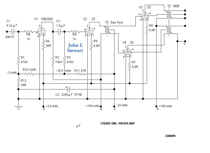

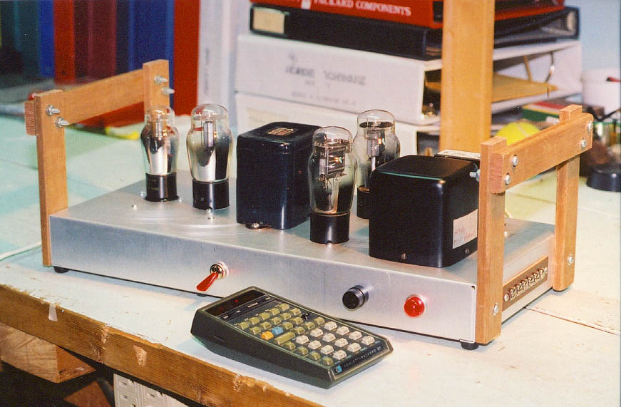

Yes, here is what I did with three of 33s & a 1B5 about 20 yrs ago.Could 3D6 be used in a two-stage amp with another DH tube (let’s say 1J24 or maybe 3A5) in the first stage?
Same thing could be done with three of 3D6 with or without a first stage,
