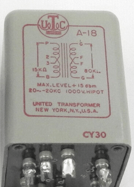

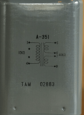

Seems like the UTC A-18 or Tamura A-351 would work for line stage?
- The UTC secondary can be put in parallel for a 20K output, correct?
- And can the Tamura reversed so that the 40K is the primary and 10K secondary? Is 40K too high for this tube? I have 190V on hand for B+
The A-18 is an interstage transformer. High output impedance is unacceptable for a stand-alone line stage.

Would it be acceptable considering this criteria? The question on that one is can the secondary windings be put in parallel, and we'd have 20K out, no?
What about the Tamura? Is 40K primary too high?
