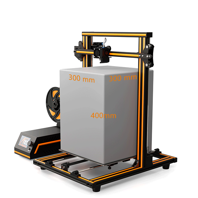

Has anyone made a website with some of these great files for printing some of these ?
I have a new Anet E16 printer that will be setup in a few days and I’d like to start off with some horn prints
This printer has a large print bed. It has a 300mm by 300mm by 400mm tall print bed
Can’t wait to start it up, hopefully my wife will not be to upset about it. I’m a dog here. Lol. I’ve packed it and labeled it as the family present to be opened on Christmas Day
I’ve only told her that it is a gifted for our daughter for her home schooling and for us as well. Lol
We home school our youngest daughter and we want her to do a lot of the out of the box type things. Fingers crossed [emoji1696]. Lol
Any way. What’s a good website that has free or close to free files for printing?
