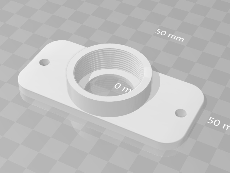

And for the screw-in drivers, I made a small adapter. Be warned though, it fits my no name drivers (it is a 1.375-18 UNEF thread) but it does not fit e.g. EV DH-3).

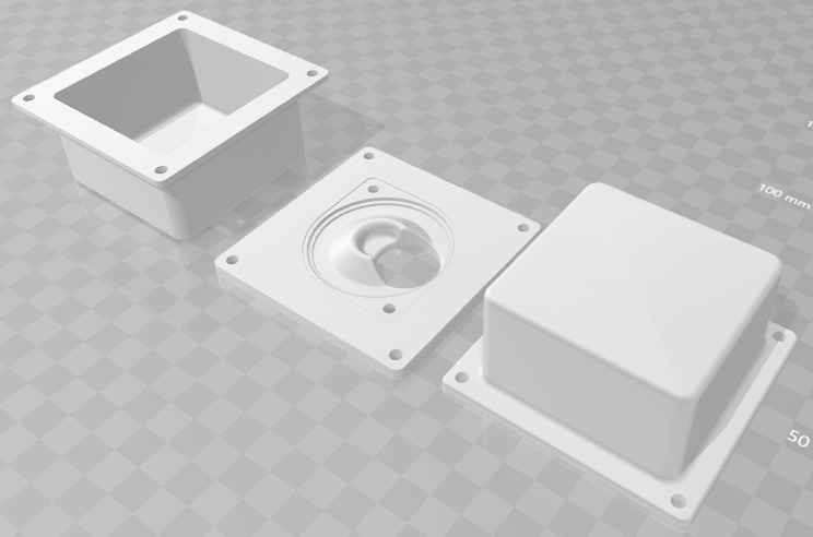

Another teaser - flange and cover for Visaton FRS5X to be used as midrange on synergy horns. Test print made, it needs some small improvements for better mechanical fit (increase tolerances on the flange). Today I will measure to see if this is suitable or not.

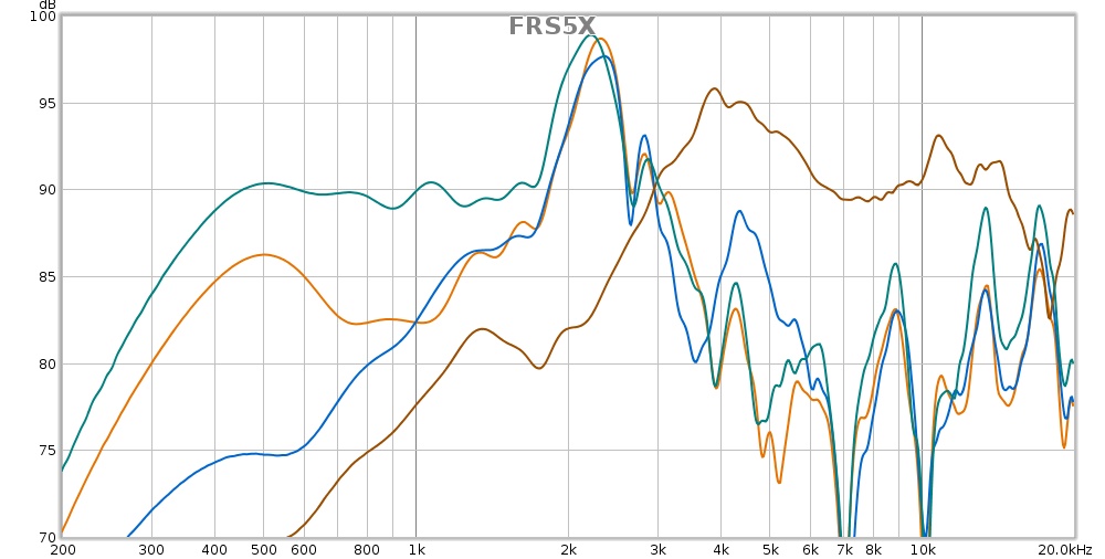

Here are some measurements of the FRS5X, relatively nearfield (ca 25 cm). Only gated, no smoothing.
Brown - free air
Blue - on flange, without back cover
Orange - on flange, with back cover
Green - on flange, with back cover and on corrugated cardboard baffle ca 20 x 25 cm
I wonder where the resonance at 2.3 k comes from - maybe from the front chamber as a Helmholtz resonator? I guess one could get rid of it by attaching it to the wall of the horn - then the "port" is longer and will be tuned lower if I am correct.

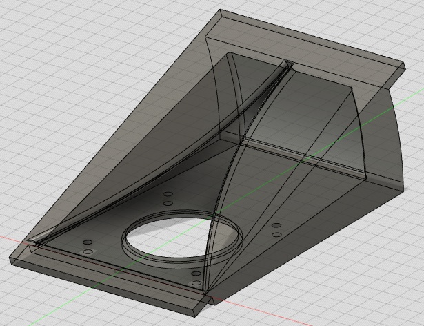

hey pelanj - I'd like to see a print. file for little Karlson suitable to have a mid-tweet using 3FE22. It could be just the front chamber and enough surface to mount the driver. Maybe a 20 degree angle for its baffle - ?

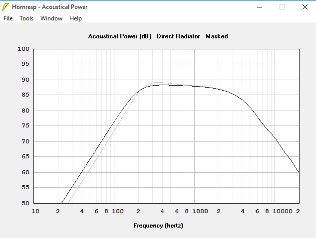

Ok, I get the idea. I need to make a 3D model of a flange attachment for the 3FE22 anyway for my AMT Synergy project. The 3FE22 is a really nice driver, worth exploring a 3D printed Klam or Rocket style speaker (on my to do list now🙂. Hornresp says 0.5 l is good (dark line), 0.3 l seems to be fine as well (grey). So a small 8 x 8 x 8 cm cube should be fine.
I actually also thought about making a K-Slot for the 8PE21 as the "phase cover". On my list as well🙂
Arcgotic, see the attached STEP file in the ZIP. The fit of the driver is a bit tighter than I like, so it needs to shave a few tenths off around the gasket.

So this is a quick try. To make it printable in one piece and with little support, the mounting flange is only on top and bottom. I see this enclosed in a rectangular box made of max 15 mm thick material. The hole for the 3FE22 is most probably not completely correct, the gasket will be pressed a bit as I made only a 3 mm recess and I think it was actually higher - and I am not at home to measure.
It needs some tuning, therefore the STL file is only for the purpose of viewing or for experimenters to print - nothing was double checked on it, nor did I have a chance to print it myself yet.

Cool! so around 160mm internal chamber height? - wonder how the chamber depth effects the response from this angle (20) to say 15 degrees?
I'll ask for a printing quote - don't have a 3FE22 but hope to get one.
Do you think the JBL style slot scaled would do better with 3FE22 than the K-cavity/slot?
