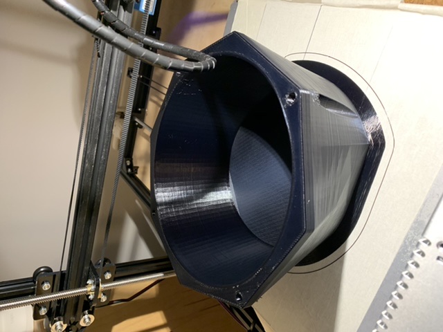

I got into 3D printing and I think I have started already too many threads here, so I am starting this one to share my 3D printed audio stuff.
The first one is a back cover for BC 8PE21. I printed it with only 11% infill to use some leftover filament, for strength I think it would need more. Also, the strength could be improved by adding ribs - especially on the flat part, the sides seem OK. Its intended use is for using the 8PE21 with a RCF H6000 horn or with the 135 Hz midbass horn by John Inlow. It fits the driver fine. For me, making one from wood would be a nightmare. 3D printing is easy:)

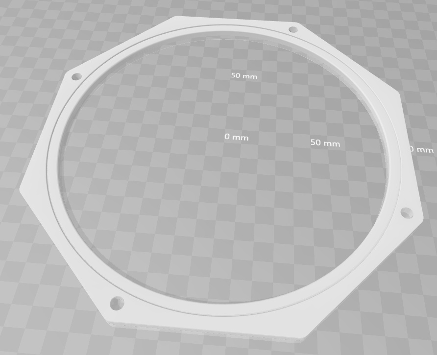

And the last one for today, a 5 mm thick distance ring for mounting the 8PE21 on the H6000 horn. The H6000 are now being drilled and tapped for driver mounting, the ring fits the front gasket really well.

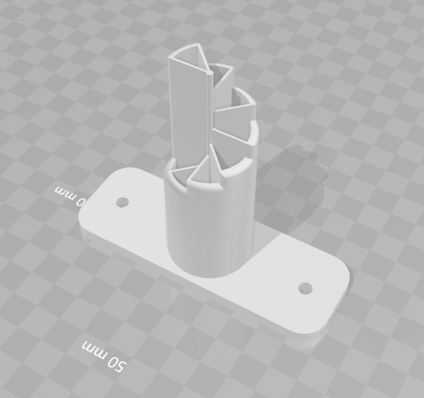

The mini-Klam did not measure too well but maybe it was just me and my not too perfect measurement techniques - and I most probably also measured in the wrong plane - I need to revisit that one day, since DonVK's sims of the K-tube were eye opening. Also, since it is easy to 3D print anything, I would make it round next time. I do jot think that the prismatic shape could bring any gain acoustically.
I would highly recommend the dual slot one - the dispersion was symmetrical and it measured quite well. And you showed me some posts here that a member here is actually using dual slot K-tubes - and I can understand why - but I yet have to print the second one...
I wonder if there could be any gain to have a Paraline-like device with a K-slot or if the K-Tube could be folded flat in a similar way. Or it it was even possible or made any sense at all.
