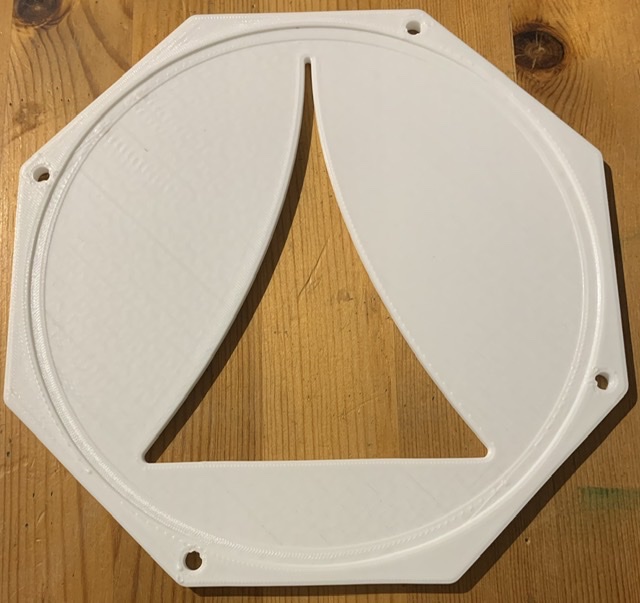

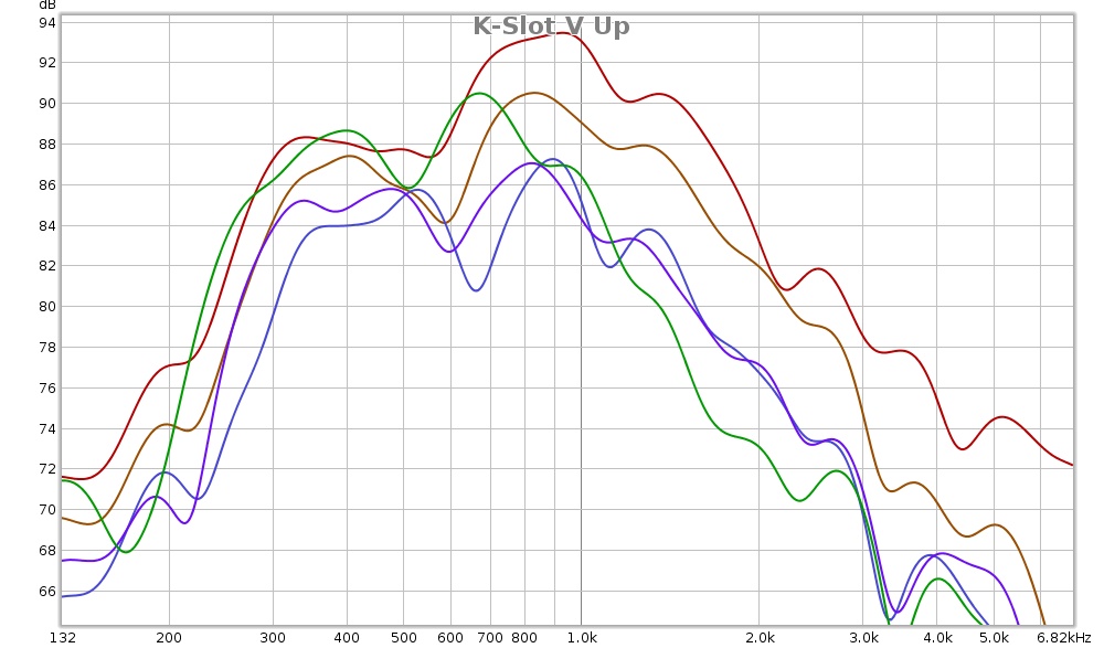

The K-Slot for the 8PE21 is printed. Tomorrow I will try to do some comparison measurements with the JBL slot.

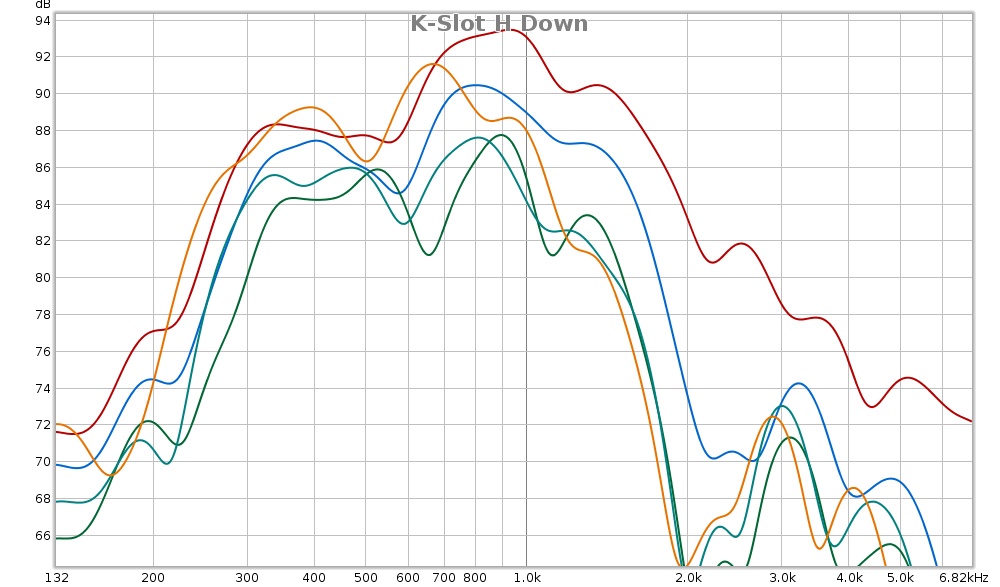

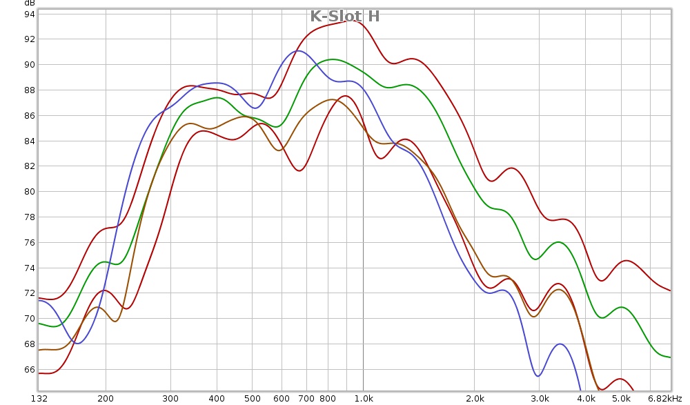

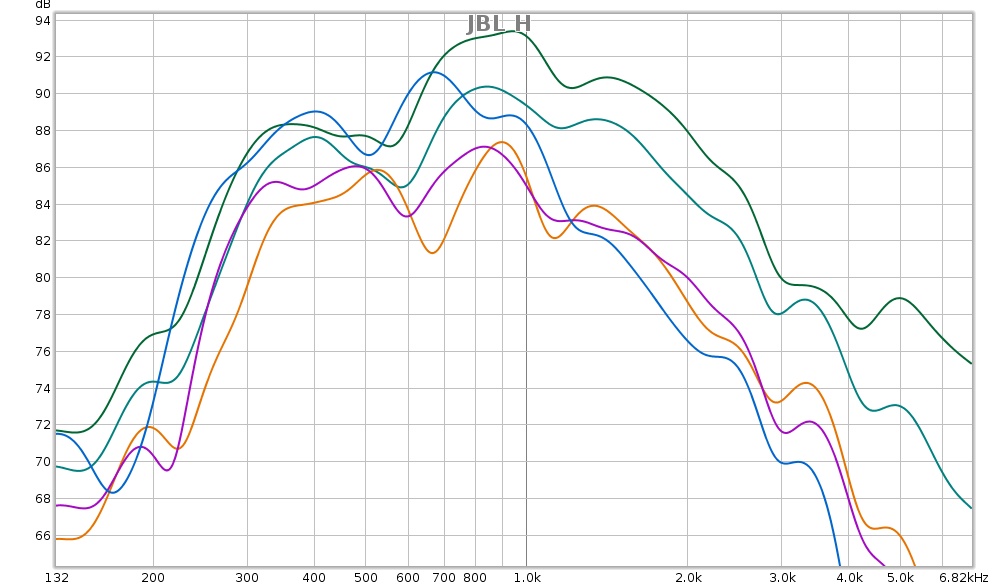

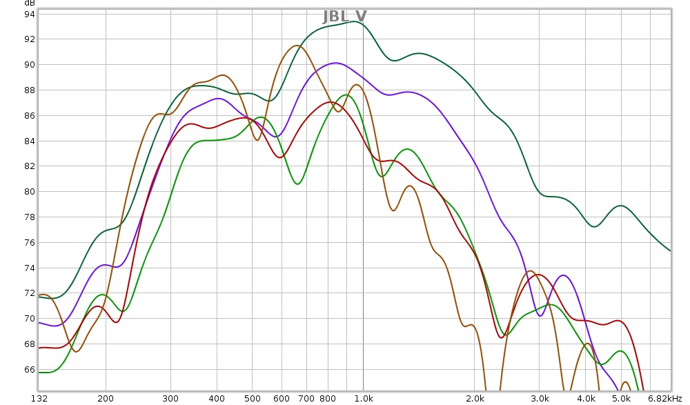

Some quick and dirty polar measurements. Again, the 3D printed back cover was used. The microphone was left in a certain position and the front covers were put on and rotated. I am sure there were some leaks around the edge.
I have vague feeling that a symmetrical star shaped opening should work fine, too. And it seems that this thing works with more or less any shape - and that great results could be obtained by optimizing the shape.
The angles are on axis, and roughly 15, 30, 45 and 90.

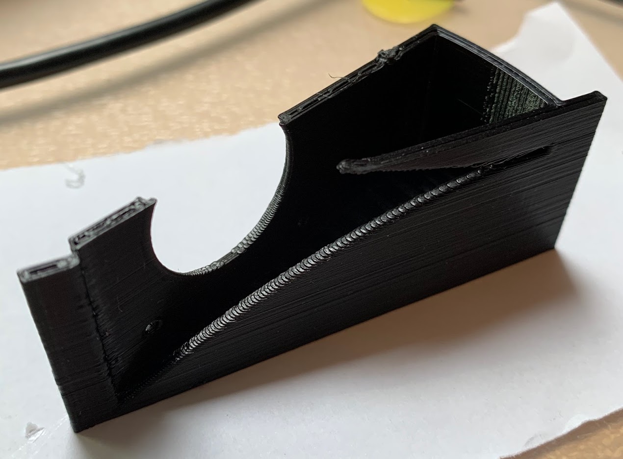

Hi Freddi, I would say it would not matter much if at all. I tried to print a scaled down model on its side - I stopped the print by a stupid mistake, but it seems that a half would print perfectly when on a side and with some supports at the beginning of the K-Slot, it would be actually possible to print it in one piece. That would need some advanced slicer setup for the print. I also discovered there was a problem in the model - an edge, that would actually open, so I added some material and made another one - I added a thin layer into the speaker opening and screw holes and it is meant to be printed with the K-Slot laying flat on the bed. A well tuned printer should be able to print it like this in one piece and without any supports. I will most probably try that in full scale when I have my large printer ready.

This sample was printed with 0.3 mm nozzle and 0.2 mm layer height. On my larger printer, I have a 0.4 mm nozzle and 0.3 mm layer height. 3 perimeters, 3 bottom, 3 top layers and 20 % infill. I tried most of the infill patterns but the difference was mostly in printing time. And all my prints used PLA and I am trying my first spool of PETG with good results. Both printers are cheap Prusa i3 style clones with 20 x 20 x 18 cm and 30 x 30 x 42 cm build volume. After 4 months of 3D printing, I begin to see the weaknesses in construction and I am improving the large one with my own and Thingiverse 3D printed parts:)
