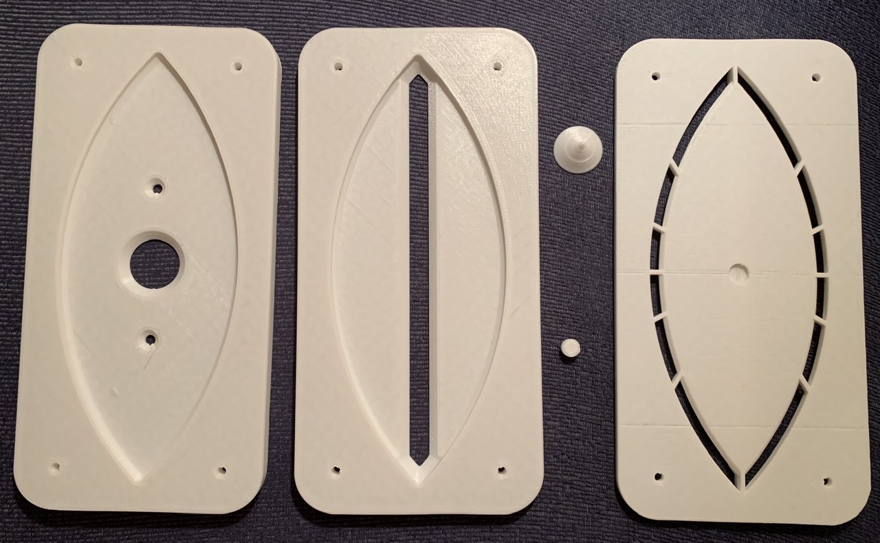

The "eye" layer is printed. It did not warp. I used Hilbert curve infill and that might have some influence as well - the rectilinear pattern shrinks in the two major direction lifting the corners. I got the side edges slightly concave, which does not matter at all.
I see a little design issue - there should be more screw holes around, at least a pair in the middle of the long side.

So the Paraline is printed. It seems to be ok, everything fits together. I will post the STL files later today. Therr is no guarantee these will work acoustically, I need to test them yet.

So here is are the STLs - the cone and joint are meant to be glued to the eye plate. The coverage angle is calculated as ca 51 degrees by Patrick Bateman's Paraline calculator. It is an easy print and with 0.2 mm layer it came out really nicely. I would like to try a "synergized" paraline - maybe it will even fit this one - only a new driver plate would have to be printed. The slot and eye plates will be glued together, but the driver plate needs to stay removable anyway.
Art, I found it here: ~ Sunshine ~ - it should have the correct A and D dimensions, but I used a three point circle through these, so it is not a true parabola as it should be if I am correct.
Freddi, this information should be sufficient for the printing service. The resulting wall thickness is (with my 0.4 mm nozzle) 1.2 mm horizontally and 0.6 mm vertically with the infill inbetween. If I remember correctly, the mounting plate is 5 mm thick in total and the tube walls 3 mm in total. If you specify 3 layer wall thickness, you should be fine.

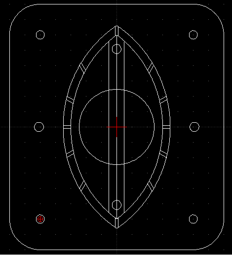

You mean coupling two 2" exit drivers together with two paralines above each other? If you define the thickness, A1 and D1 and mounting pattern, I can make a 3D model quite fast - in the same style as the small one. I guess it will be pretty large and it would need external support made out of wood to hold the weight of the drivers. And if you make a hand drawn sketch, it would be even easier.
Would this work? Two of the mounting bolts would go through all the layers. I wonder what use could such a thing have...and still, I am using a circle which is most probably not too correct?

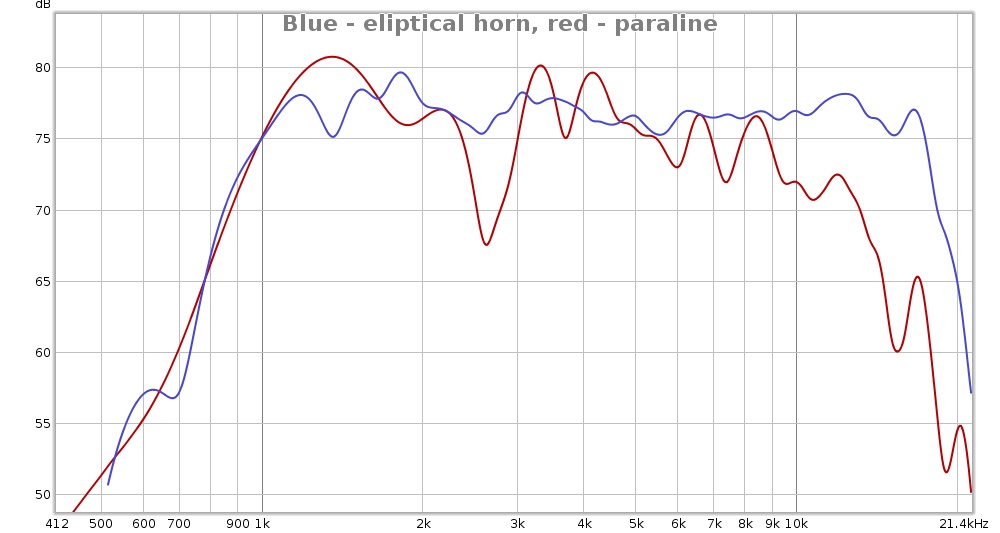

I am not sure if I got the paraline right. I checked the 3 point circle vs a parabola and for these dimensions, the circle is close enough with very minor differences. But the mouth should have been 5 mm wider, now I think I finally understand the spreadsheet. The picture compares the FR in my quick-and-dirty in-room style measurement the same driver (Beyma CP385Nd) in a small eliptical exponential horn (blue) and the paraline. There are some dips at 2.6, 3.7, 6.0 and 7.4 kHz that can be seen as negative group delay in the GD curve. I wonder if one could get rid of these somehow, I am going to try to fill the area below the driver plate by polyfil and compare.
