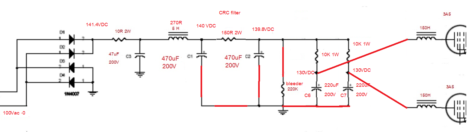

I have referred the PS from Bona's page to give you example how to split last rc combo for left and right channels. The PS itself is not good at all for DHT HP amp.

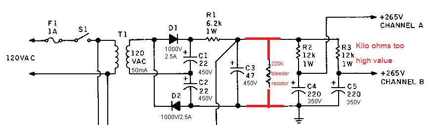

Thank you very much Mr. Minhaj. In this diagram R5 220K act as bleeder but they use 12K both L and R to drop voltage. Is it too high resistors values?
I think use high value resistors to drop voltage in B+ Power supply caused by mistake of too high secondary power transformer (should be lower). The high value to Ground such as 220K 300K should be use as Bleeder Resistors to discharge Capacitors. I only see low value to drop B+ voltage such as 30R - 220R but not in Kilo ohms.

Now I understand how to split B+ to left and right. but should be low value of R not 12K. Maybe 30R - 150R is good, right?

120VAC secondary should get around 170VDC. Why it can produce 265 even has high value of Rs 6.8K and 12K drop??
...It is ok in this context. High value resistors in power supply give better reg and
filtering. I use 1k-1.5k resistors in tube pre.
...It is a voltage doubler circuit that is why.
basic B+ might be like this need to study more.
...Okay as a concept, not very good for DHT HP.

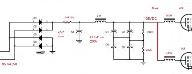

...Personally I don't use sand reg for B+ for tube circuits. Since Chokes and
transformers are not expensive in your country should should go with LCLCRC
or pseudo LCLCRC for B. If power tranny and ist filter choke are not high quality
pseudo route is better. No matter how good the amp circuit is, you wouldn't get good
sound until the B+ is good. The last R and C should be close to the load, the last
capacitors should be high quality film cap 2.2uf-3.3uf is enough.
