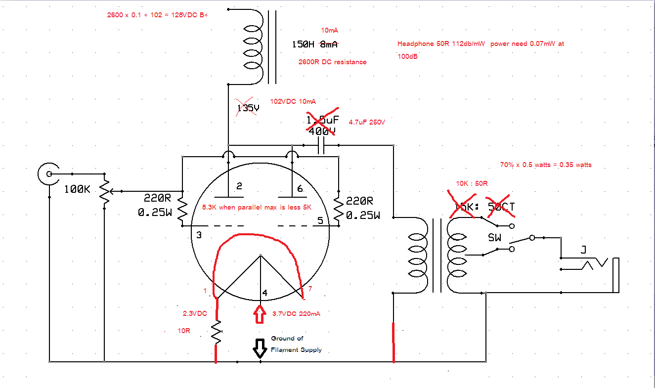

Oh Thank you Mr. Minhaj. my wrong calculation
the correct is 0.01 so 0.01 * 2600 = 26VDC + 102 VDC = 128VDC B+
4P1L PP vocal is just ok but bass is huge!! I prefer 45 SE of my acquaintance. Voice is very good.
Next step need to design 3.7VDC regulated supply. I might go to power supply section in this forum maybe someone had designed 3.7VDC 440mA (220mAx2)
Question is why they use 3.7VDC - 2.3VDC at filament? instead of 1.4VDC
I guess it will deduct 102VDC - 2.3VDC = 99.7VDC as tube datasheet.
......you need 2x filament supply, one for right channel one for left channel. Since filament is the cathode otherwise crosstalk will happen.
Question is why they use 3.7VDC - 2.3VDC at filament? instead of 1.4VDC. I guess it will deduct 102VDC - 2.3VDC = 99.7VDC as tube datasheet.
......No. 3.7 volt is bias voltage, 3.7-2.3=1.4 volt is filament voltage. Explanation and calculation available at Bartola's site.

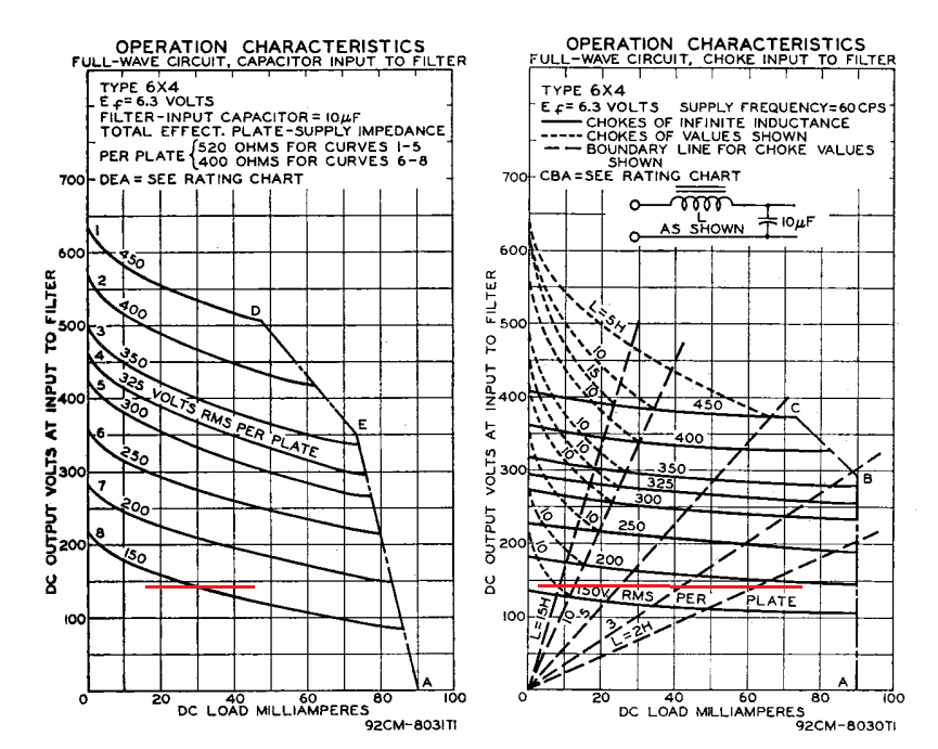

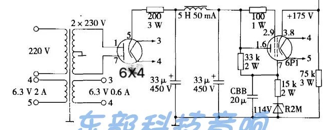

The Chinese 6X4 supply board use 5H but 230VAC per plate will provide about 200VDC 35mA with load of 2 tube of 3A5 preamp get B+ of 175VDC (200VDC-25VDC) assume that pre amp use total 20mA of 2 tubes. so V dif = 25 I = 20mA so R is 1250R
use 1250R as calculation, if I use the same 6X4 with 5H choke if input 200VAC per plate can provide about 160VDC 28mA which is enough for 3A5 2 tubes 20mA. with the same milliamp I should get near 135VDC B+

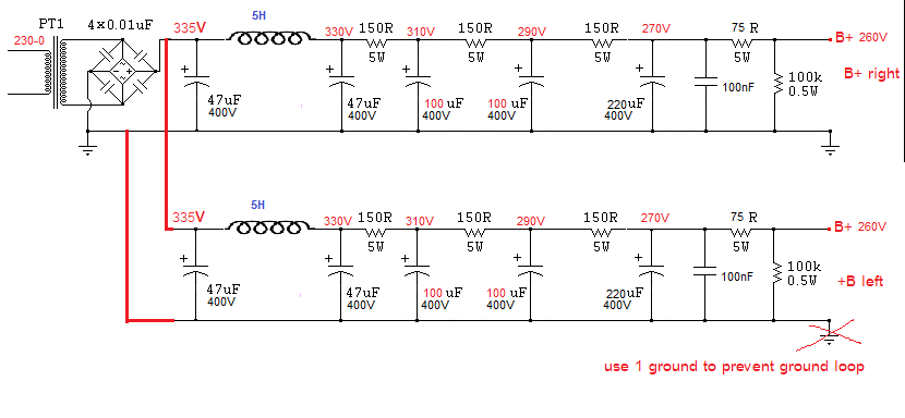

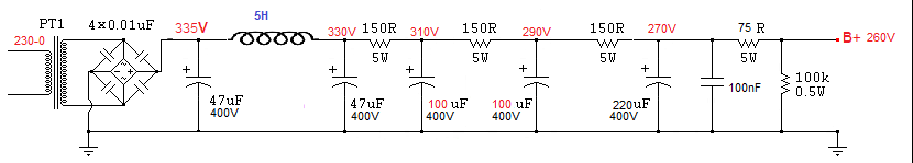

Post 76 and 77 refer to your recommendation of CLC B+, I think I found and example of it and need to modified from it to get around 135VDC 20mA. This is not use any diode tube. May be Power supply of 120VAC will provide closed to get B+ of 135VDC
However, there is no split of Right and Left B+ can you modified this picture to get left and right B+. I don't understand how to split B+.
