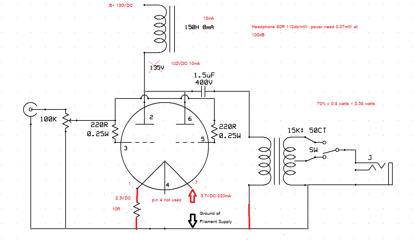

The problem with the 15K resistor is that it's always 15K, regardless of frequency. The 150H choke is about 19K at 20Hz, then that falls off. We can size the parallel feed capacitor to present more impedance as well as that happens to keep the tube lightly loaded. Above 20Hz, the impedance of the 150H choke goes up dramatically, and the impedance of the primary of the output transformer looks more like a constant reflection of whatever is loading it (provided the load isn't too far off the specifications of the secondary).
With the 15K resistor, the load on the tube is always less than 15K. If you wanted to use a plate load resistor, I would suggest a 47K plate load. This will bring your B+ up around 500V I believe. The Hammond 156C is about $15 USD, why not use a pair?

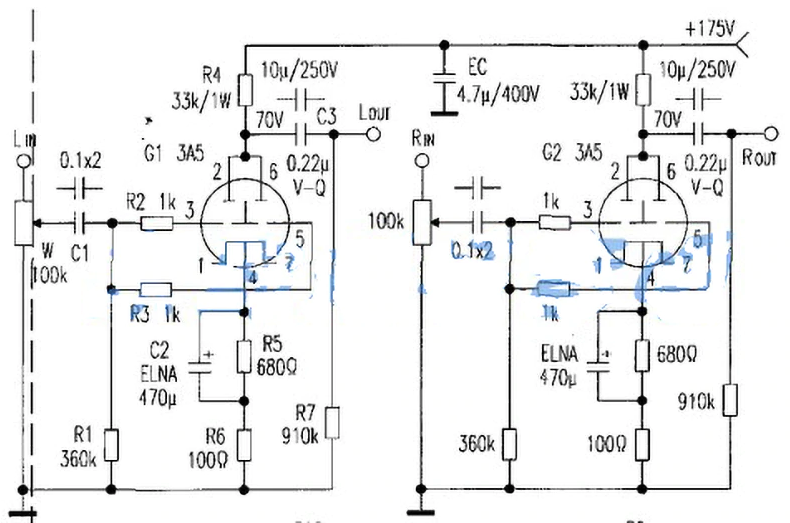

High value of plate load resistor 47K make B+ too high for me to do. I saw schematic of Chinese 3A5 Preamp in Aliexpress use 33K plate load resistor with B+ 175V to get 70VDC on 3A5 anode.

Local shop has 140H 8mA 4360R which should be enough for 130VDC 8mA instead of 100VDC 10mA. B+ will be 165VDC.

3a5 parallel ra is about 4.5k ohms x 3 =13.5k ohms round to 15k ohms
3a5 parallel ra is about 4.5k ohms x 20 henry =90 henry round to 100 henry
A plate choke acts like a reactor, plate resistor does not. Two ate different.

You can do a lot better than random junk on AliExpress.Chinese 3A5 Preamp in Aliexpress use 33K plate load resistor with B+ 175V to get 70VDC on 3A5 anode.

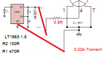

Mr. Minhaj can I see your 1.4vdc parallel filament design of HP AMP? If it is not bothering you.

Post #42 -schematic is for line stage, it can be ref for HP amplifier. Even for line stage you can do much better otherwise, as audiowise mentions.

Post #46 -my filament supply is parellel, two stages, 1st stage is well filtered regulated voltage source followed by 2nd stage high impedance constant current source.

post #48 -wrong schematic please don't try it, you can not bias the DHT this way.

Dear mr. Minhaj so #48 is wrong due to no 680R resistor to ground, am I right?
So if i add 680R resistor to pin 8 and provide 1.4Vdc to pin 1 tied with 7 and ground of DC after 680R. Then tube will work, right?
Sorry pin 4 to 680R not pin 8. I only familiar with 4p1l so forgot that ground of 3A5 is pin 4. 4p1l gnd is pin 8

sorry again not correct. You need to connect pin1 and pin7 with a piece of wire and apply voltage across pin4 and shorted pin 1 and pin7. If we assume DC resistance of plate choke is 4000 ohms and b+ is 135 volt then passing 10ma current plate voltage will be 95 volt (4000x.01-135). 1.5uf cap need to be 4.7uf. 10K:50r will be better than 15K:50R. Why don't you go for a good output transformer such as 10K:50r gaped for 10ma dc current and be happy been simpler!
