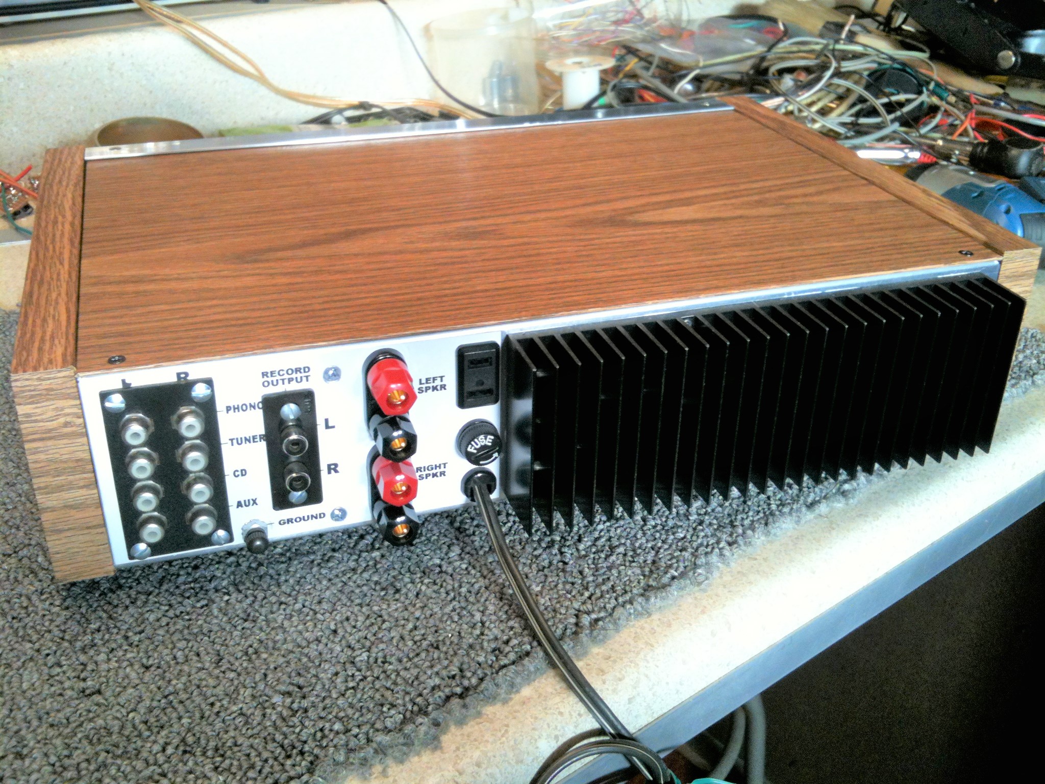

Easy...mark out the rectangle on the metal, then get your metal cutting blade for your jigsaw & measure the depth from the tooth point to the back spine. Then get a drill bit a few mm bigger than this & drill inside the markings in each corner of the rectangle. This allows you to then place the jigsaw in each hole & cut each straight side. Then file it to finish.
That's the way I cut a rectangular hole, but in aluminum chassis.
Only I drill just 2 holes, opposite corners, to start the saw blade from.

Get a scrap piece of metal and give it a try with drills, snippers, and some files.
I could probably do that in 10-20 minutes max…
Oh, if it’s aluminum, then half that time.

Patience, my young padawan. With drills and files, make holes, you will.
What profiles are those in the 2nd picture holding the sides panels and the screws for the top and bottom panels? Thanks, appreciated.
I agree with drill, jigsaw, and files. I've made a nice adapter plate for a twin-shaft car radio out of stainless steel plate using exactly those tools. Two things I've learned are: use new(ish) sharp files, and, scribe the outline with a sharp point. You can't file precisely to a fuzzy line.
I guess a Dremel or grinder with a cutting disc would work, and may in fact be better than drilling holes for starting the jigsaw cuts.
There is a dremel for this job, but it is slow, you break a lot of cutting discs and need eye protection and hands etc. I watched someone take an hour to do it in 1mm steel.
I'd just drill and jigsaw and file.
Take a day or two and drill and file. If you are filing steel, it will be very loud, you might need hearing protection. I have done this many times before, and no special tools are required. Use a round file, it will cut quicker, a flat file can be used to flatten at the end.
