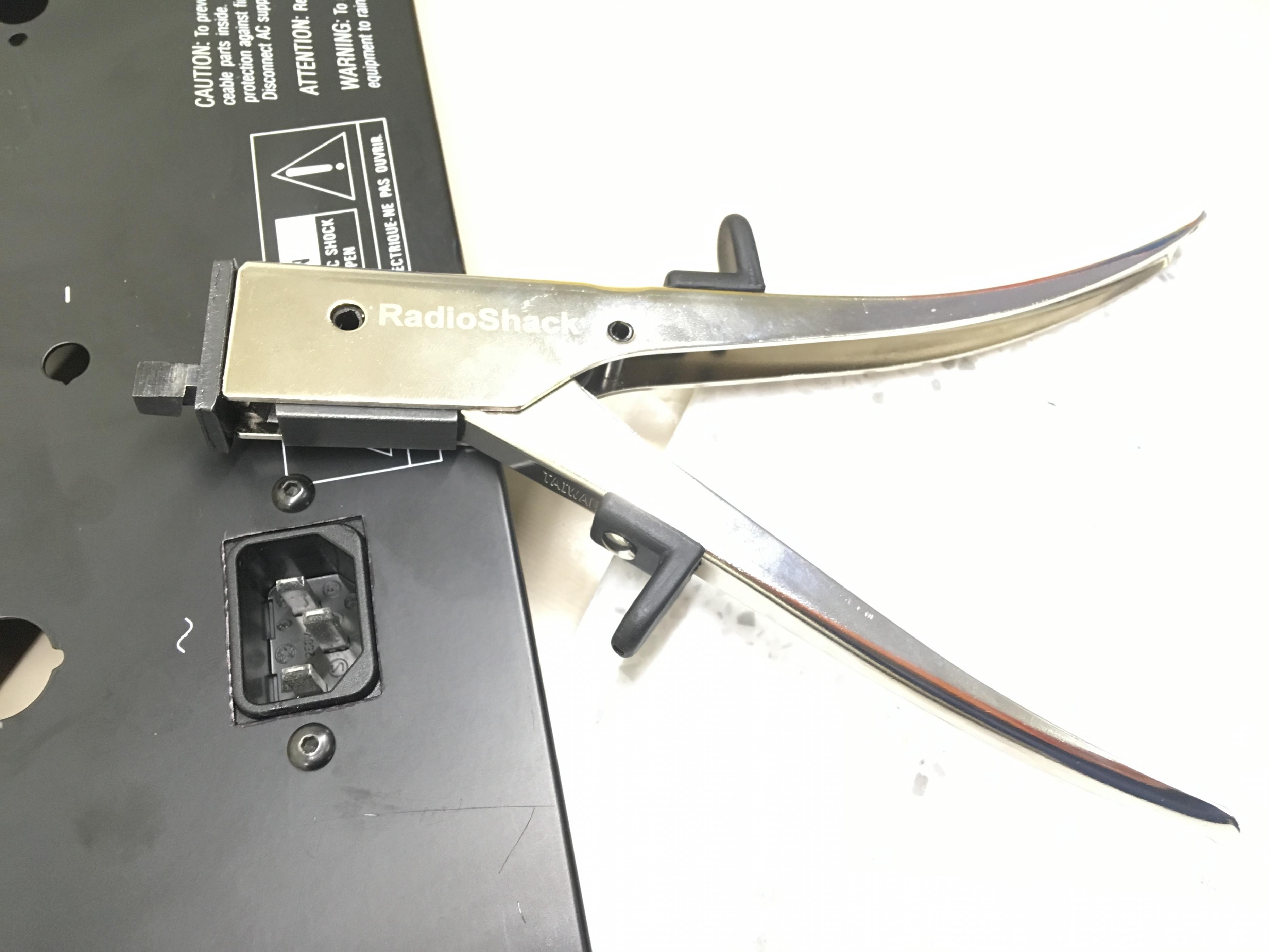

My best tool for sheet metal is a Nisshinbo MAP 500. https://www.gindumac.com/product/nisshinbo-map-500_NL-PUN-NIS-2001-00001
However it is out of almost anyone’s budget.
I have found Dremel tools to be quite light duty. They use a DC motor to get the high speed. Unfortunately as they warm up they have been known to overheat the internal bridge rectifier. That fails by shorting out, sometimes taking out the rotor windings. I am on my fourth one and it is rarely used. It also does not inherently cut square as a nibbler does.
A nibbler does require hand strength and occasional bit sharpening or replacement. It will give reasonably precise square corners and holes. It really is a nice tool and for this application the rear panel is 1mm thick and nicely in the thickness range specified for the Knipex tool.
My best three hand cutters are made by Channellock, Erem and Knipex. They use great steel and make excellent products. The Adel nibbler as far as I know was the first small handheld one. It works well but is not of the quality of the other three. I find the weakness is in the die part of the tool. As a result it does work better on weaker materials. Of course few folks know even with a nibbler lubrication of the cutting surface is still important.
My MAP 500 pretty much keeps the punch floating in oil. Small punches are good for 200,000 holes when properly sharpened and oiled.

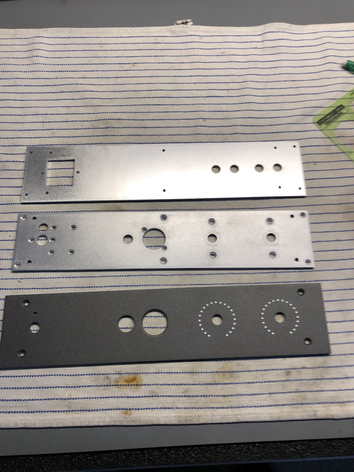

Easy...mark out the rectangle on the metal, then get your metal cutting blade for your jigsaw & measure the depth from the tooth point to the back spine. Then get a drill bit a few mm bigger than this & drill inside the markings in each corner of the rectangle. This allows you to then place the jigsaw in each hole & cut each straight side. Then file it to finish.
That's the way I cut a rectangular hole, but in aluminum chassis.
Only I drill just 2 holes, opposite corners, to start the saw blade from.
This is done when an external heatsink is mounted, so that the output transistors are directly mounted to the heatsink.

Get a scrap piece of metal and give it a try with drills, snippers, and some files.
I could probably do that in 10-20 minutes max…
Oh, if it’s aluminum, then half that time.
I agree with drill, jigsaw, and files. I've made a nice adapter plate for a twin-shaft car radio out of stainless steel plate using exactly those tools. Two things I've learned are: use new(ish) sharp files, and, scribe the outline with a sharp point. You can't file precisely to a fuzzy line.
I guess a Dremel or grinder with a cutting disc would work, and may in fact be better than drilling holes for starting the jigsaw cuts.
Take a day or two and drill and file. If you are filing steel, it will be very loud, you might need hearing protection. I have done this many times before, and no special tools are required. Use a round file, it will cut quicker, a flat file can be used to flatten at the end.
