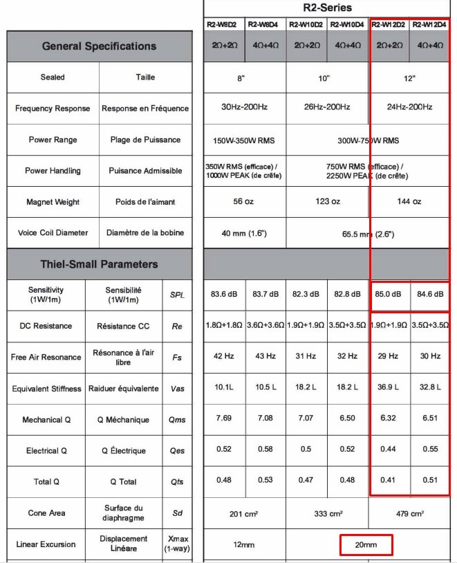

Alpine makes some 12" with similar TS parameters to the LAB 12, this cabinet would be a better fit than the SS15 for that type of driver.

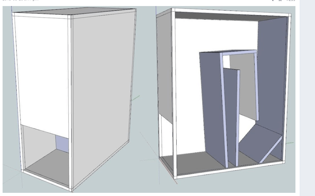

where the most flex will happen? see the pic below
Remove the corner reflector. It takes away from the modeled volume. See jbell's Single Sheet Tapped Horn thread. He discusses how he tested his enclosure with and without corner reflectors. There is a loss in dB's with them, unless you factor in the volume they take in the actual build.
Can i use 1/2" ply instead of 3/4" , maybe add some bracing on the bigger panels , if the deflection of the wood only takes away 1db or less ,i think the weight loss gain is justifiedRemove the corner reflector. It takes away from the modeled volume. See jbell's Single Sheet Tapped Horn thread. He discusses how he tested his enclosure with and without corner reflectors. There is a loss in dB's with them, unless you factor in the volume they take in the actual build.
The LAB12C impedance minima in cabinet is near the DCR of 3.11 ohms.with the volt meter on the driver to what voltage i set the limiter so to not damage the LAB12

Long term limiting should be set to around 28volts, 250watts, half the AES free air rating.
Peak limiting of 1000 watts, around 56 volts.
HP at 30Hz BW24, LP around 80-100 Hz depending on top cabinet response.what are the LP and HP settings,
As a guess, 20 volts at 20Hz in free air should reach Xmax, the driver would be broken in in a few hours.also, how do you break in the LAB12, play a 20hz test tone with the bare driver for 24 ? 48 hours ? and at how many volts
If weight savings are more important to you than sound quality, no problem, though the casters may punch through..since the LAB12 is not a 4kw driver, can i use 1/2" ply ?
On the largest unsupported panel widths.where the most flex will happen?
