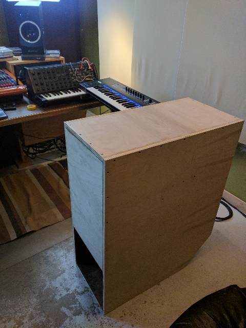

Finally got one assembled!! It's shaking the glasses off my studio shelves.
I didn't precut the handle and terminal openings, still have a bit of work to do. One side is screwed but not glued.

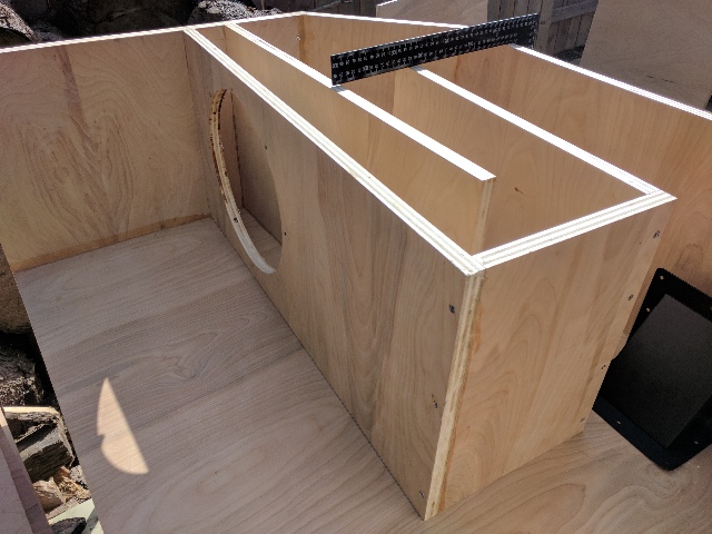

Working on box 2, cutting handles & terminal cup opening.

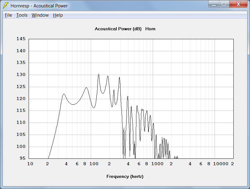

So for some reason my new computer from work, does not allow me to even download/install Hornresp.

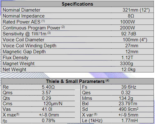

Can someone please quickly help me out and check if this driver would work in the PAL12 design? I am especially curious to see the SPL response graph.
Thank you!!
Thank you!!
Eg = 40 volts.
