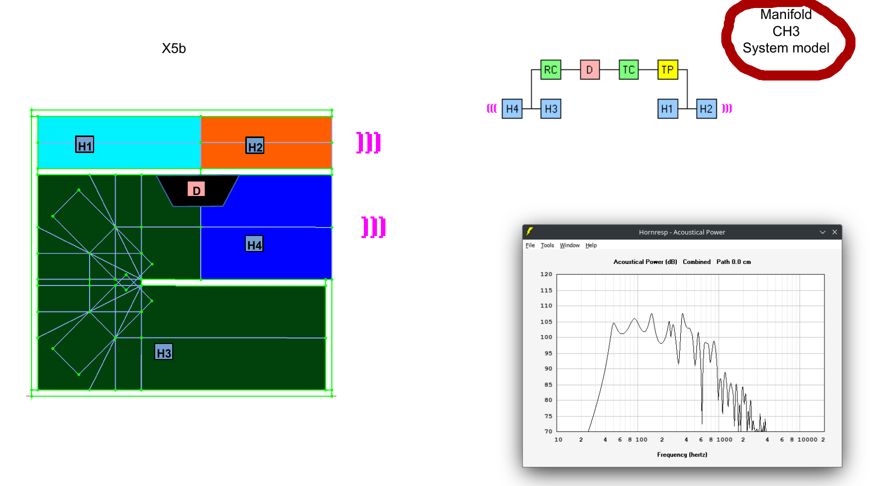

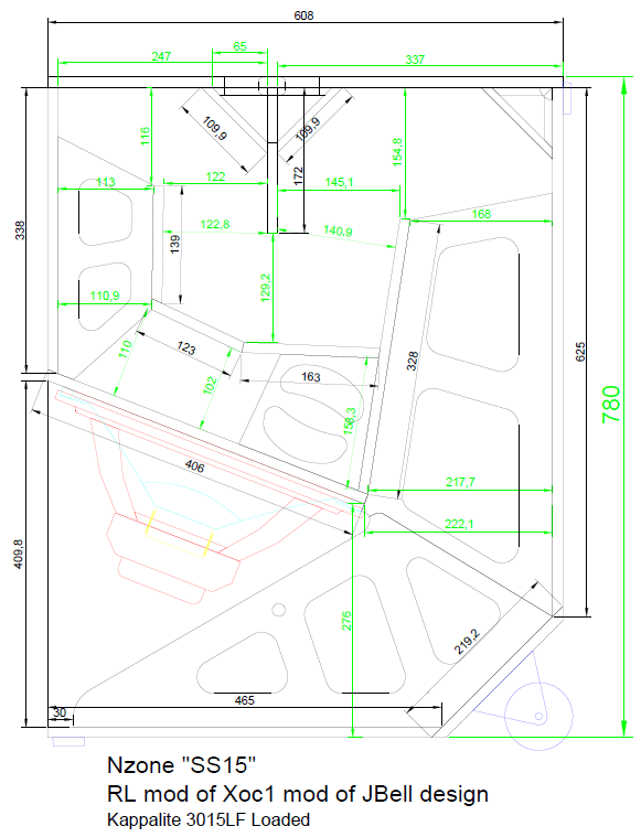

where you put the driver on the x5b ?
Maybe it's better to create a different thread to discus the x5b.
The driver is placed where the color changes, the driver placement are defined by the models available on Hornresp, in this case it was the CH3. Check attachment #1 and remember always to check System Model.
DL for doing sims

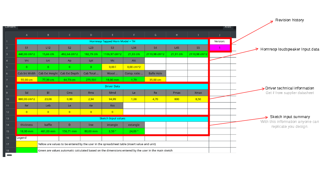

The sim output are available at the spreadsheet page inside the CAD files that you download, the user can also export the TXT file to hornresp with all automated options available.
Check the 1st image from Tips and tricks session or attachment #2
is kind of strange that the NZONE SS15 is 224L vs the original SS15 that is 230L but the NZONE still hit lower
maybe the diferent panel layout inside
Width play an important role for volume, mine are wider for instance.

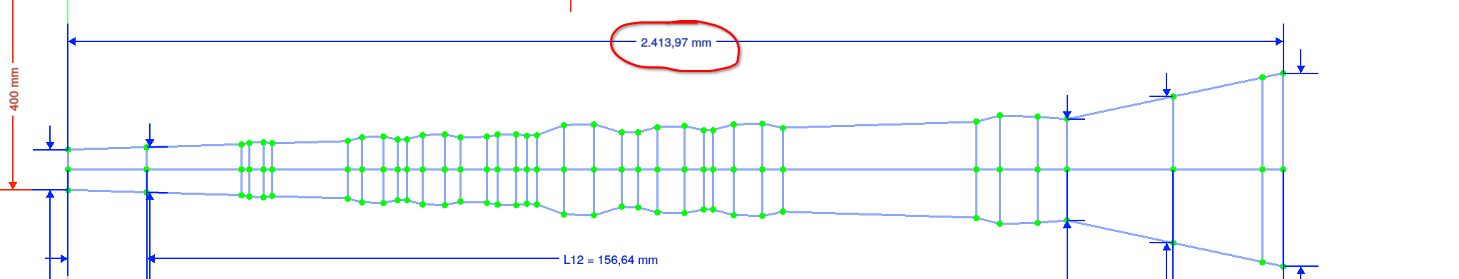

The FreeCAD model for the THSS-1 is the model I built.

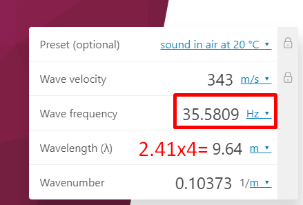

What counts for low frequency is the horn length not box volume. Volume will contribute more to SPL.
You can create a matrix in a excel sheet, slowly you change the design and plot the response, overlay the responses and then you will see the changes that improve the response and the other that don't, in this way you can converge to a better result.

Hi @LORDSANSUI, I've been having lots of fun with your Freecad models, thanks! I have watched your instructions videos and have been trying out Manifold, SS and THAM models with SB audience 15" drivers. 🙂 May I ask a potentially ignorant question about the parameter spreadsheet? I notice the yellow cells which are adjustable include the driver TS Pars, and some adjustment for cab internal width and baffle hole. Is it possible however in these models to adapt other values like the height and depth and the horn path length and see the result in Hornresp? It's possible this is covered in the videos but I just missed it sorry.
Hello rrobot,
I happy you liked the tool and it's useful for you.
You can adjust some design parameter in order to better match the loudspeaker layout and distentions for a specific driver. Inside the spreadsheet you can only see current values for the dimensions you can change and they are indicated in the group "'Sketch Input values". In order to change their values itself, you need to go to sketch edit mode by double clicking over Sketch in the model tree. Editable parameter are RED colored and they have the same names as the cells in the spreadsheet.
In the website, when you click over any model, you will see their sketches with those red colored dimensions.
Let me know if this is what you was looking for.
Note: While editing sketch dimensions, I suggest to do it by small step, sometimes the CAD software go crazy and breaks the model without any reason. For instance, the current dimension is 400 and you want to change it to 500. It may worth increasing in steps of 25 or 50, it depends model by model.

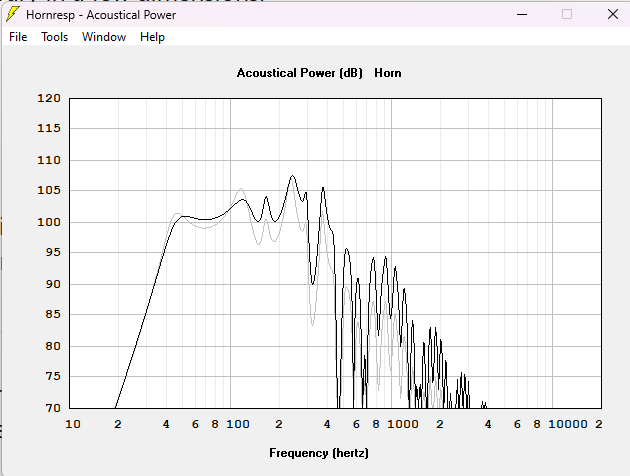

Amazing! This is fantastic, and easy to understand now you've explained it so clearly. 🙂 I'm off to try out some changes to the dimensions in various models, especially in the Manifold model using the SB Audience driver I've input ... seems to have a falling response after the second resonance peak at 145hz (Manifold is slightly off topic sorry). In any case, the SS sims great and I should hopefully be able to output the 3d model to fusion360 and add the bracing from there if my rudimentary cad skills permit. lol
Open a new thread where you can discuss the manifold design and your findings, there are people that are interested in that cabinet layout, it is simple and looks very promising.

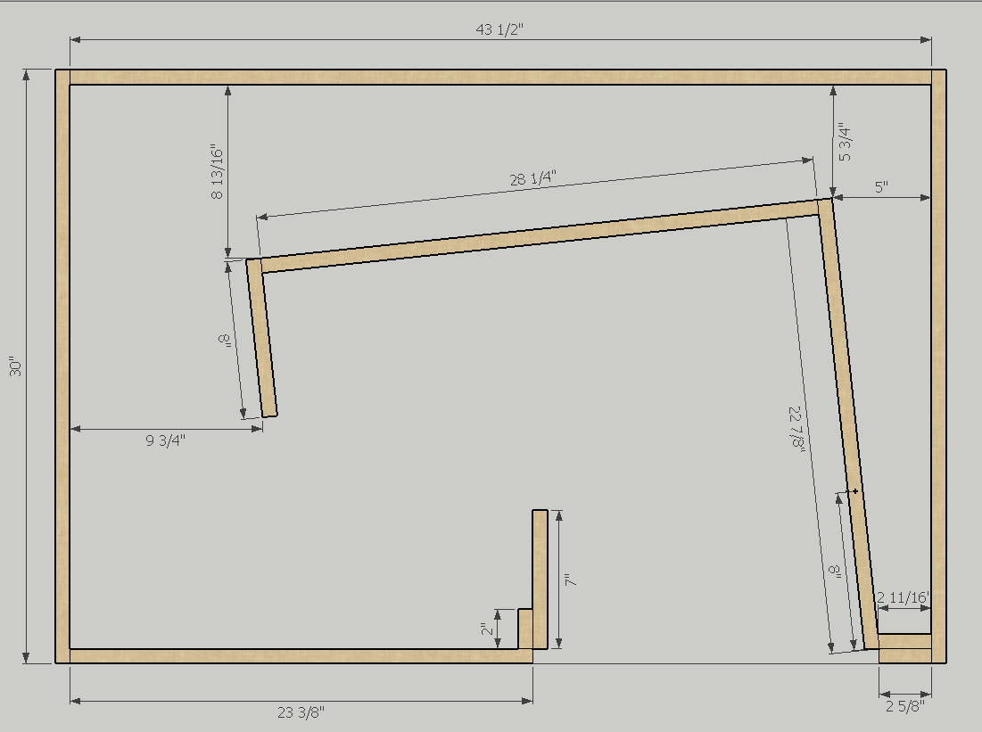

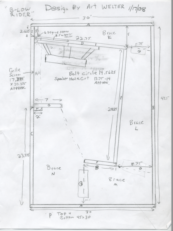

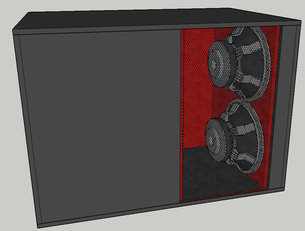

Below is Art Welter Dual 15" TH for peavey low rider designed in 2008, he called it
B Low Rider
from this
to this
Reactions: rrobot
