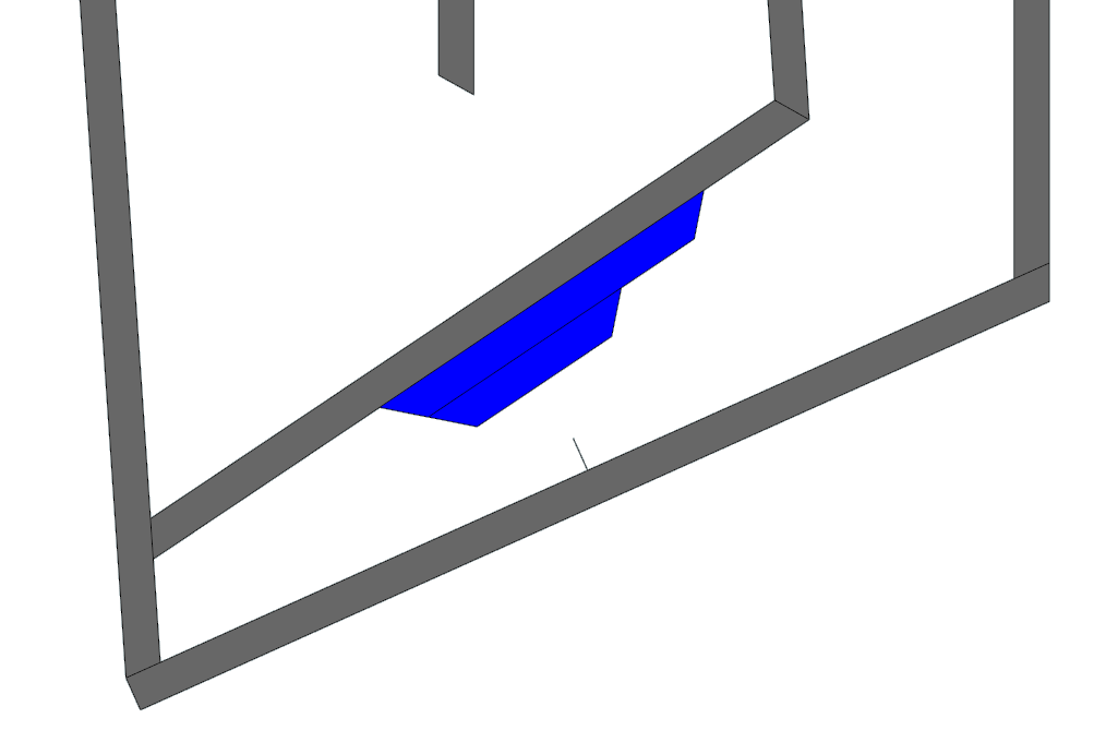

I don't remember all advantages, but one is to improve the higher frequencies. It also shift a little the shape of the SPL curve once you are changing S2, and depending the way you introduced it you can change S1 too, all that allow more freedom to tune the design and improve frequency response. If I'm not mistaken it helps to reduced cone excursion too.
You can check it on Hornresp, try to let all input parameter fixed and only change S1 and S2,
The tuning needs to be done according to the driver you are planning to use because changing S2 will change compression ratio, all the gains mentioned above will generate as side effect: higher load in the cone witch will lead to more distortions, audible or not, and it will increase cone fatigue leading to reduced life.
There is no general rule that will make one feature always better in all cases.

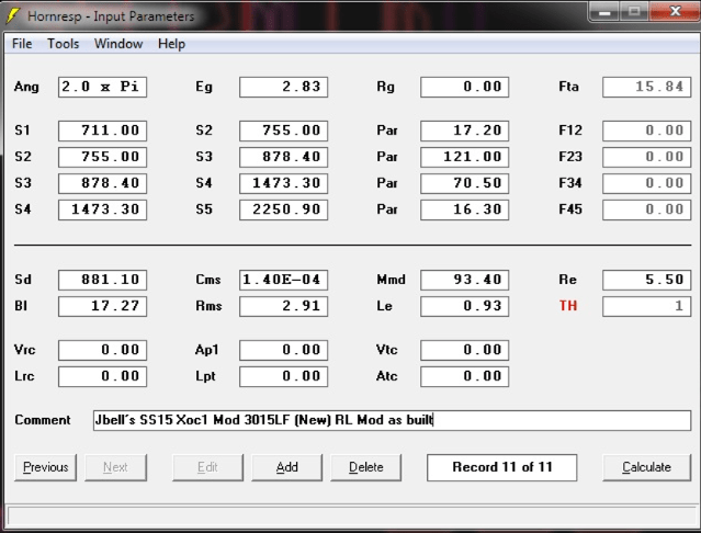

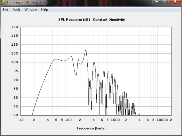

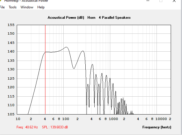

with the above HR input screen i simmed a PRV 15SW2000 with better results than the 3015LF
at least that is what HR says
, only thing is that NZONE used 12mm ply for the cut sheet, and metric system

PRV 15SW2000
NZONE XOC1 mod JBell SS15
3015LF have 9.6 xmax 17BL 3" voice coil 450w AES
15SW2000 have 12.5 xmax 23.2BL 4" split voice coil 1Kw AES
@900 watts
12.5 xmax
4 cabs

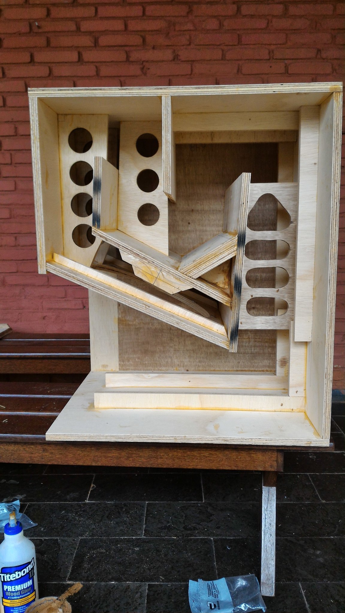

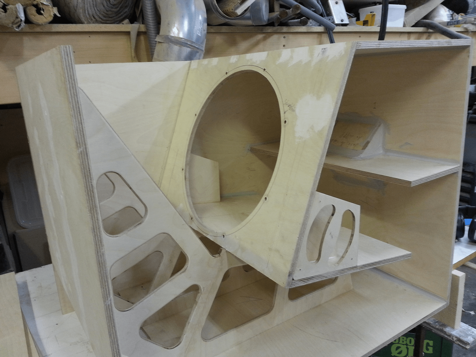

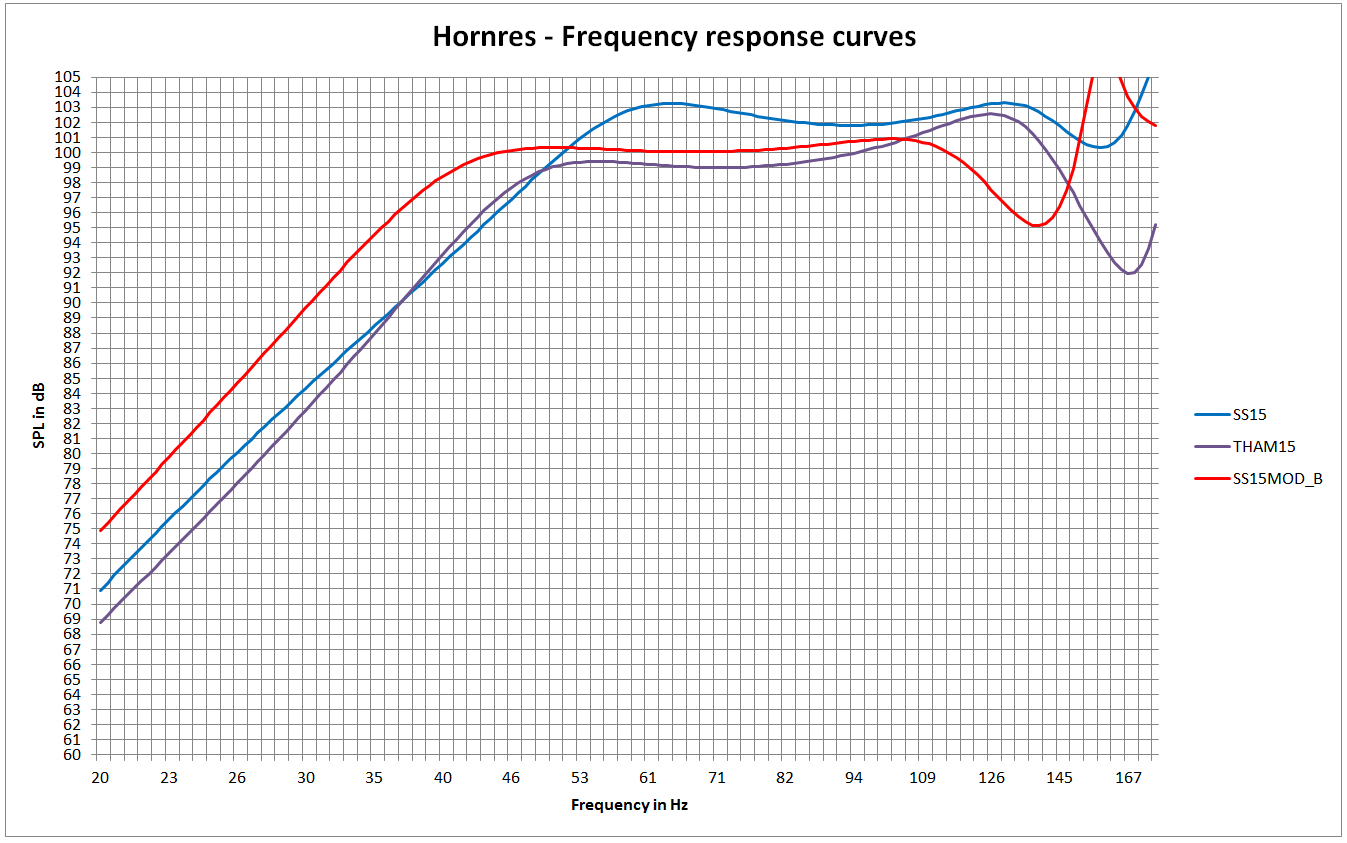

I also build TH SS15 with modified dimensions to better work with my driver.
There was a thread as you can see below, but unfortunately the images were loaded into another website that are no longer available :/
https://www.diyaudio.com/community/threads/th-15-flat-response-to-35hz-3db-by-lordsansui.299036/

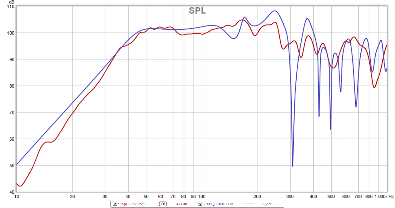

Attached you can see some details from the build, simulation vs measurements, benchmark vs SS15 Jbell and THAM15, cone correction and other.
My Mod has 293L
SS15 Jbell 230L
THAM 187L
I remember to see those pics in the long SS15 threads do you still have the plans for your SS15-B?
None of the pics on your thread show , this forum can host pics now 🙂 no more external free hosters , the NZONE version that XOC1 helped or did almost all, use the same single sheet but was tweaked a bit inside so the Fs shifted to hit lower , with the Brazilian driver it hits 40 clean , in groups of 4 looks better , no EQ You need (insert Yoda voice here) 😂
So I stick with this one or try yours ?
I know is bigger, how many sheets of ply? 1 1/2?
Adjust the design is very simple and now automatic, each driver behavior differently, there are some that works better with higher compression ratio, other with low compression ratio. Internal and external expansion angles can be adjusted also and will affect the result, I made more then 60 simulations to find the best option for me and even so at maximum power the driver exceed Xmax but not Xmech, but my amplifier will not delivery max power so I'm ok with that.
You can create a matrix in a excel sheet, slowly you change the design and plot the response, overlay the responses and then you will see the changes that improve the response and the other that don't, in this way you can converge to a better result.
I'm the automation level available today in Freedcad, all the simulations that took me a lot of days could be done in less then 1h.

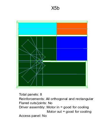

Today I like more the Paraflex C and Manifold, both can deliver better response considering the same volume and they are easier to build, etc.

Check the link below the post # 1 attachment #1, OPT 1 = Paraflex C and OPT 2 = Manifold, manifold gives even wider bandwidth
https://www.diyaudio.com/community/...nifold-mtb-be-better-than-tapped-horn.391782/
Check also post #18.

where you put the driver on the x5b ?
and on your webpage what is the files to DL for doing sims
i tried the x5b and the paraflex c on the sims but they end with more box volume
right now the SS15 Nzone mod is the one who can hit 40hz with the 15SW2000 and135L
volume
