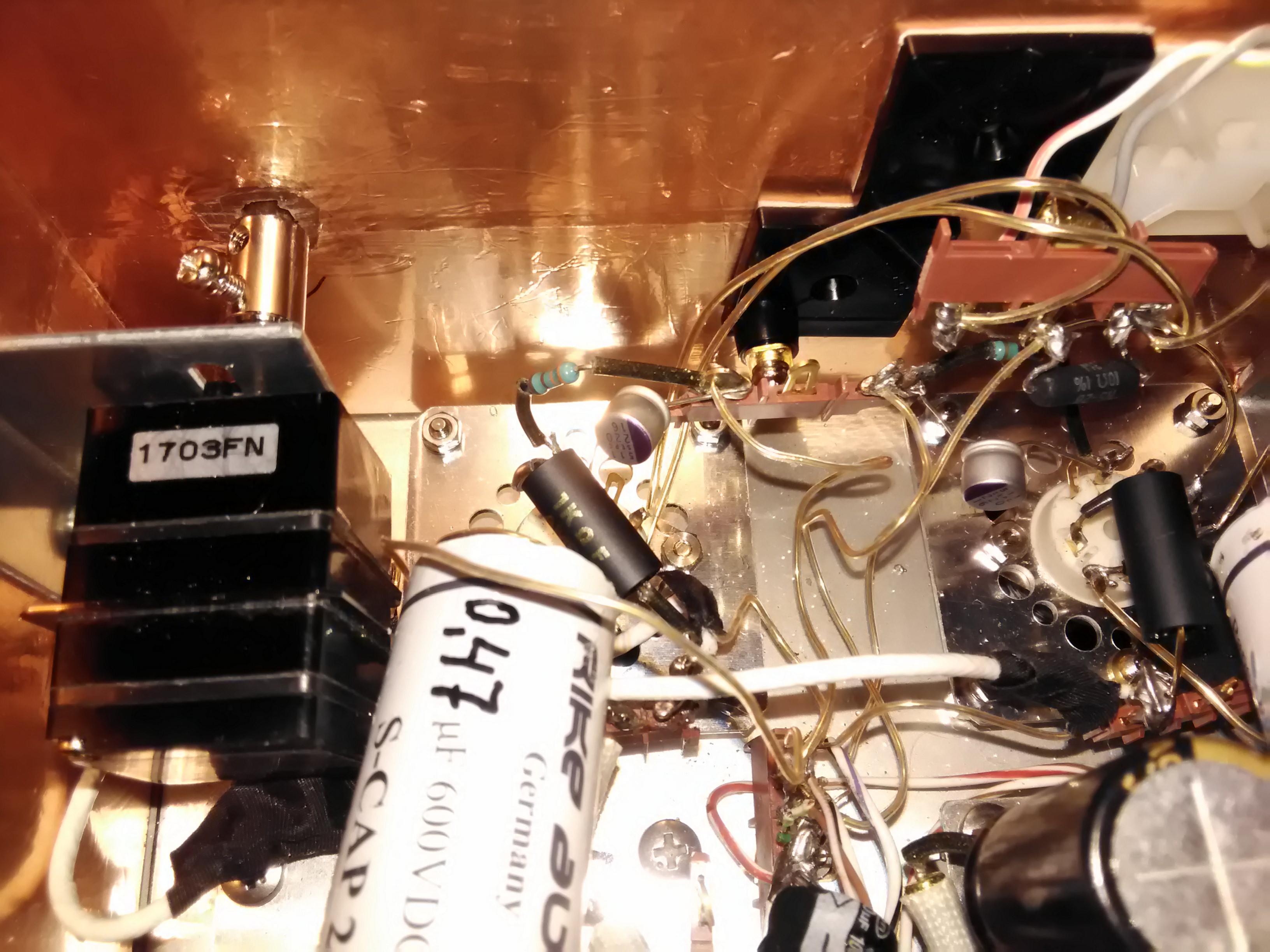

I have tried some resistor for grid stopper. After some experiment,carbon resistor on 1st stage worked well. Sound is quieter and smoother now. Grid stopper to 300B seems too much so I leave. I have also changed cathode bypass cap to Sanyo oscon.
Thanks deafbykhors. I had no experience with tube amps and I didnt know even 300B or something like OPT mechnichs. From my small research,I chose from 3 of those inexpensive OPTs. ISO, Softon Rcore OPT Softone RW-20 Single-Ended Audio Output Transformer Toei-transformers ???????????????? Some Review says ISO has punchy sound with low frequency. Softon is clean sound,Toei is famous for low-priced and good sound Toei products are mostly hilite core (one oriented hi-b core).Its cheap and always good review from professional engineers.It is said that price comes from company owners honesty since 1958 in Akihabara. Finemet core transformers has best reviews but costly.
