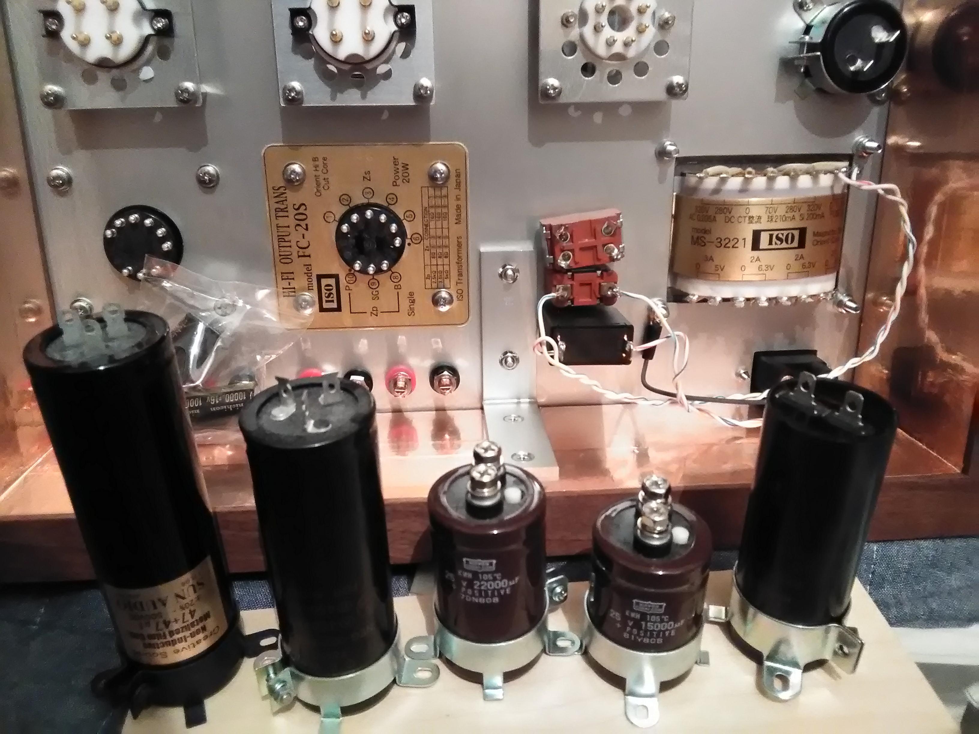

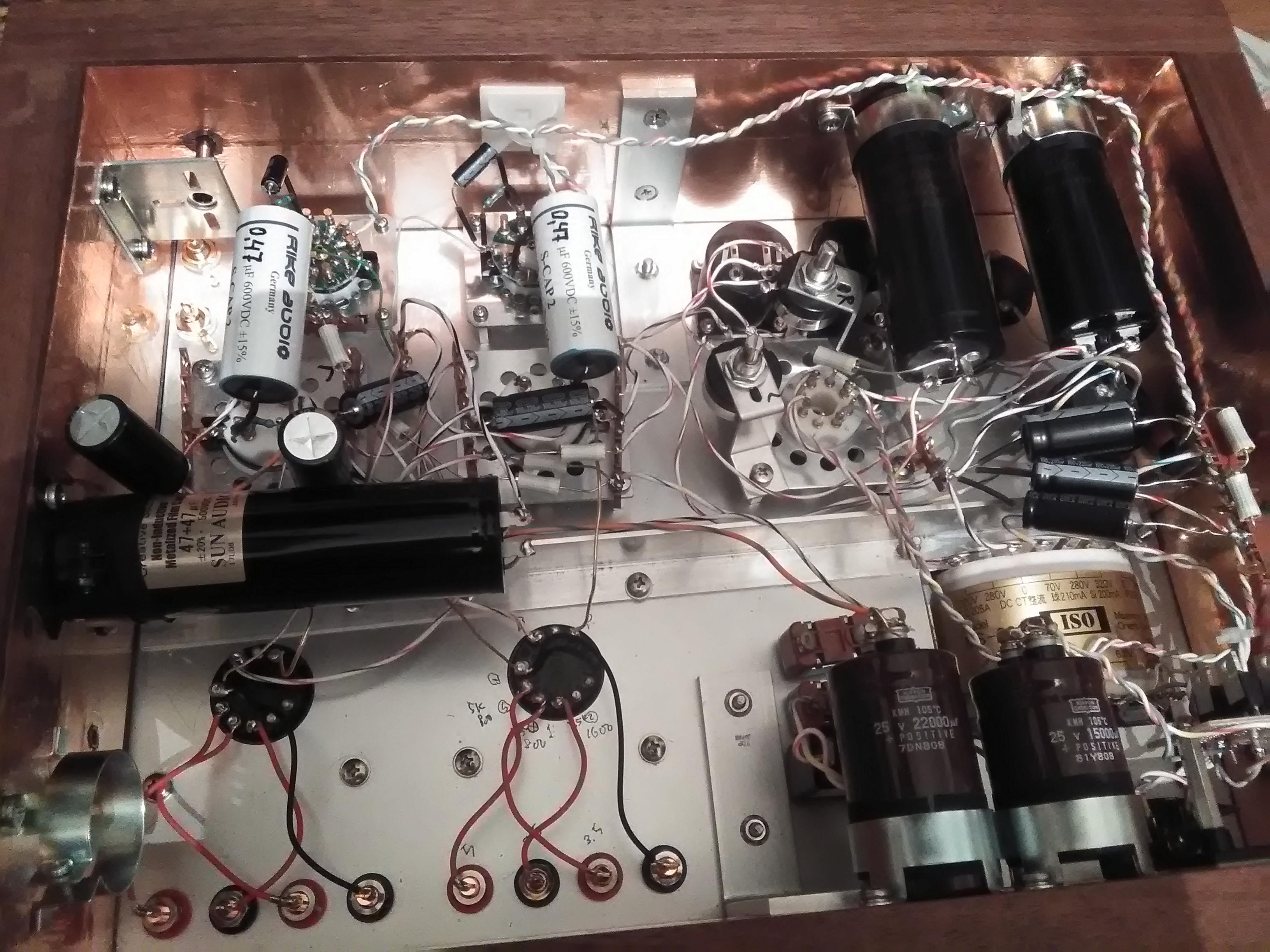

I have tried some resistor for grid stopper. After some experiment,carbon resistor on 1st stage worked well. Sound is quieter and smoother now. Grid stopper to 300B seems too much so I leave. I have also changed cathode bypass cap to Sanyo oscon.
