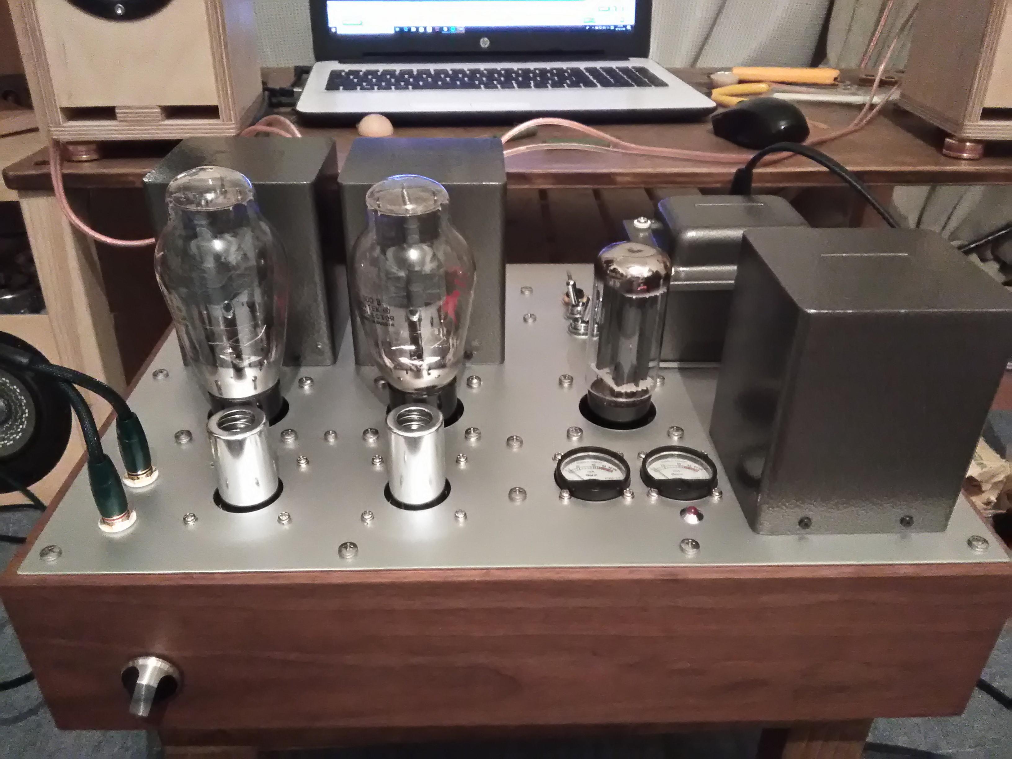

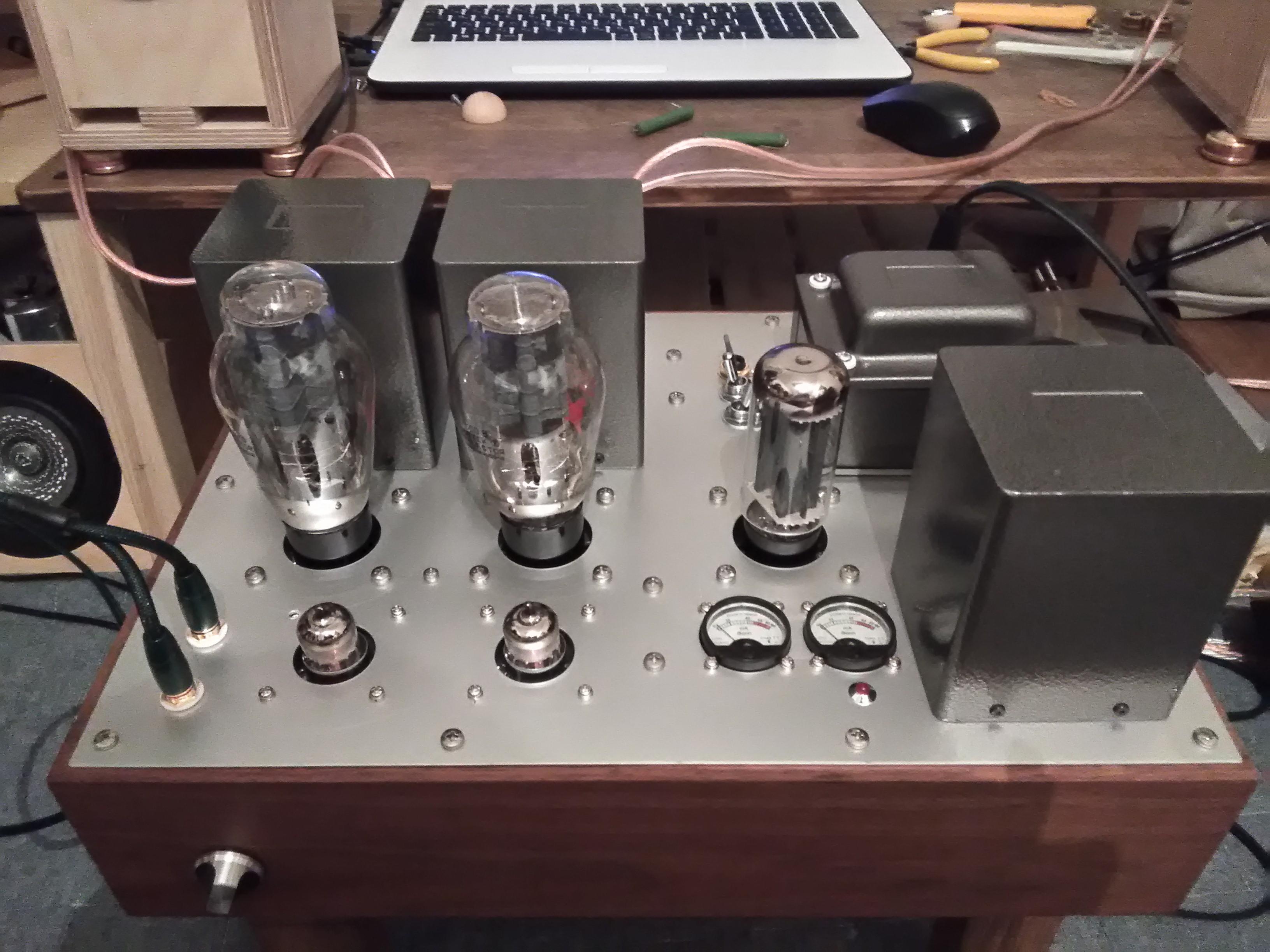

Awesome, you're off to a good start. The copper tape is good shielding.

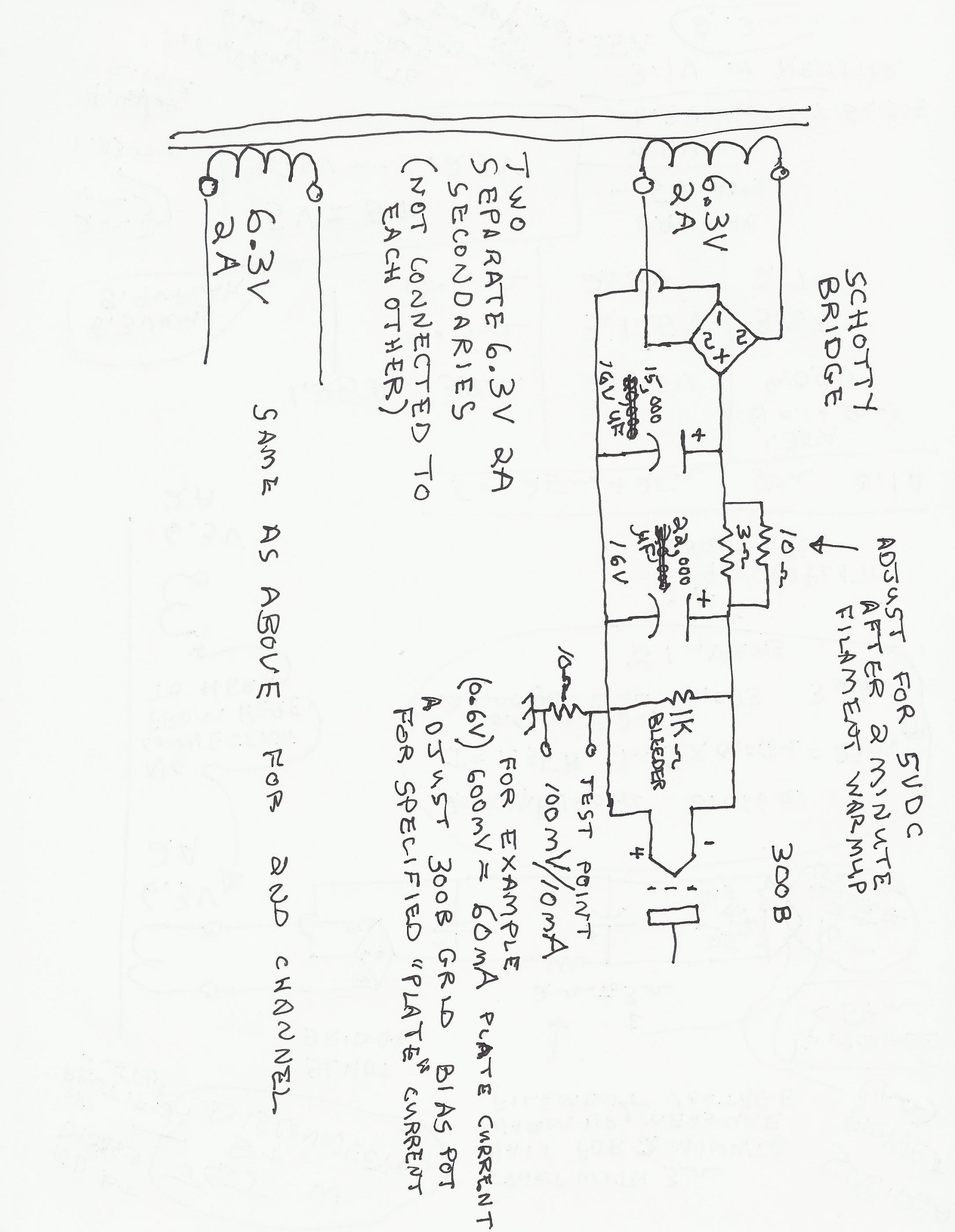

tamra,
I am attaching a schematic for separate 300B filament supplies.
The ripple of the supply is low enough that you will have less than 200uV rms (200 microvolt rms) hum at the output transformer secondary to the loudspeaker (that is caused by the small filament supply ripple). You will have to work hard to get all the other contributors to hum that low.
I included a 10 Ohm sense resistor, so you can properly set the grid bias to get the plate current you want (I did not see what the schematic called for plate current, 50mA, 60mA, or how much?).
You do have to adjust the dropping resistor that is in parallel with the 3 Ohm resistor. The warm up of the 300B filament is long until the voltage stabilizes. You want to adjust the 10 Ohm parallel resistor until it and the 3 Ohm give you 5V across the filament after a 2 minute warm-up.
You may choose to change the 1k Ohm bleeder to 100 Ohms. If you are testing the power supply, and do not have a 300B installed, the filament voltage will rise to about 8V or more. Then, after you power the amp down and plug a 300B in, the 5V filament will get a 8V transient, if the bleeder did not yet bleed the voltage down.
Also, there are no bleeders on the B+ supply. A pair of 25k Ohm 5 Watt resistors in series, will help to reduce the B+ voltage after you turn the amp off, and then open the cover plate to work on the amp. Safety first.
I hope for many happy listening hours for you.

300B plate current is 70mA 350V. I checked 300B filament voltage from previous schematic. One is 4.65V and other one is 5.3V. It looks much better to change separate. Separate filament supply you show me,looks I need 10Ω for connect earth and - of filament pin right?
The 10 Ohm resistor that connects from ground to the Negative 5V filament supply is for two reasons: 1. It passes current from ground (which is also the B+ ground) so that electrons pass from the filament past the grid, and on to the plate. It increases the plate resistance by less than (<) 40 Ohms (700 Ohms + <40 Ohms); not a problem. Do not forget, the Negative terminal of the B+ supply is connected to ground. 2. It is so you can easily measure the current from the filament to the plate. 70mA through 10 Ohms will give 0.7V (700mV) from ground to the Negative 5V. Set the 300B grid bias pot until you get 0.7V across that 10 Ohm resistor (with the 300B tube warmed up).
The Other 10 Ohm resistor, the one across the 3 Ohm resistor . . . it might need to be 8 Ohms, it might need to be 12 Ohms, 10 Ohms, etc. It is adjusted so there is 5V DC across pin 4 and pin 1 of the 300B (when the filament is warmed up, it takes a little time). The variables are your power line voltage, your power transformer, your Schottky Diode Bridge voltage drop. Shoot for 5V DC, when your power line is at its average voltage.
For example, my power varies from 117V on a cold winter day with me and the neighbors using electric heat, electric water heat, electric stove; Then on some days and nights my power is at 123V. I wait for a day of 120V, and set the value of that "10" Ohm resistor until the filament voltage is 5V from pin 4 to pin 1.
The heat that is dissipated in your 300B is: A. 5V x 1.25A = 6.25 Watts And, B. 350V x 0.75A = 24.5 Watts That is a total of 6.25 W + 24.5W = 30.75 Watts. This is a Class A output stage. That power is constant for no music and also essentially for music that is not near clipping. The principle is: all that power is in the 300B with no music, and then some of that power is sent off to the loudspeaker when music is present. Surprising, isn't it.

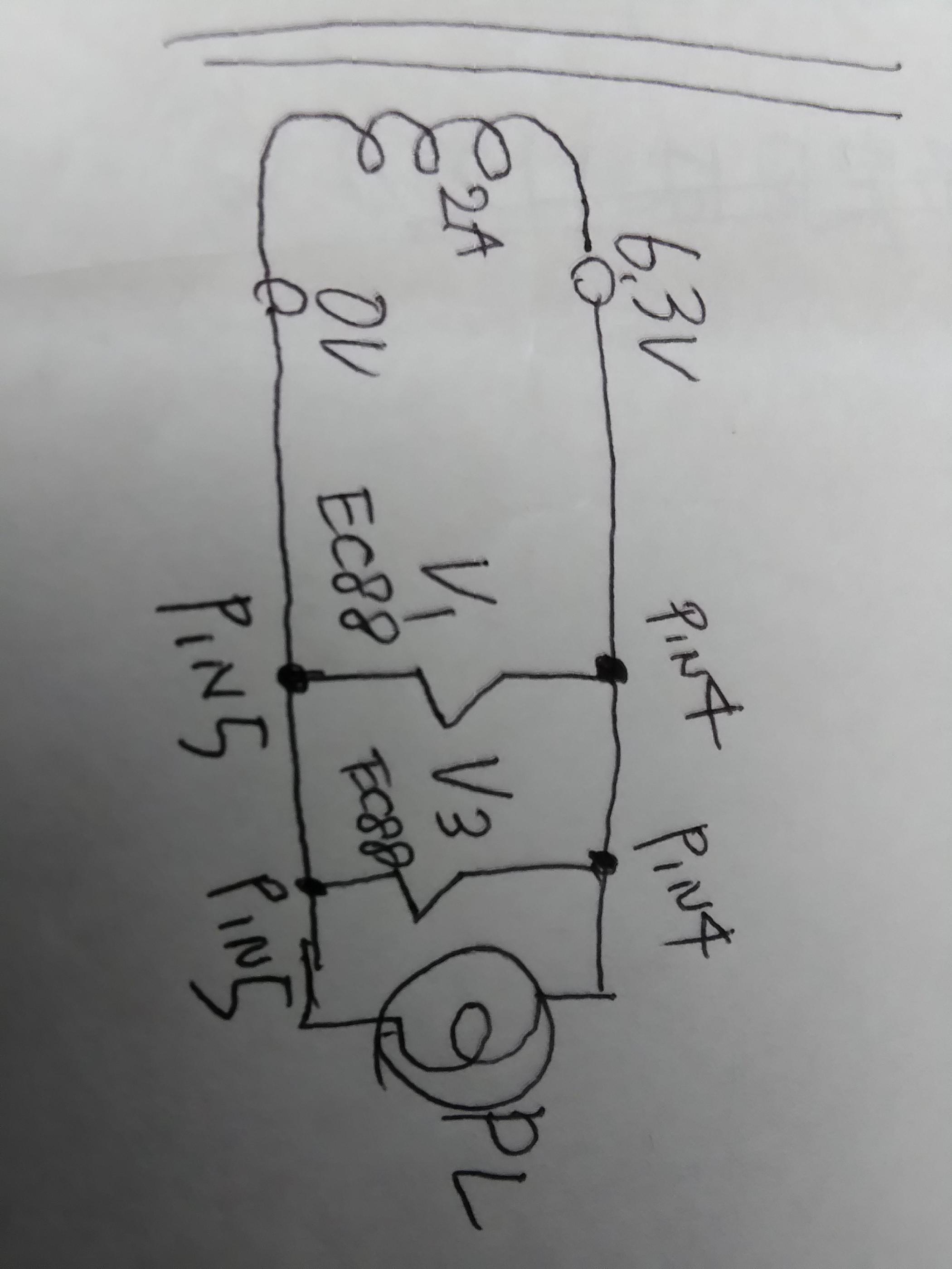

Thank you for detailed instruction. It is really helpfull. Do you also add resistor with first stage tube filament wire?
tamra,
Good question.
In my opinion, I would prefer not to connect the V1 and V3 filament winding directly to ground, as is shown in Post #1. Instead, just use a couple of 50 Ohm resistors, one from one end of 6.3V to ground, and the other 50 Ohm resistor from the other end of the 6.3V to ground.
That balances the voltage just the same as if you were using a 6.3V Center Tapped winding with the Center Tap connected to ground.
That means that each end of the 6.3V is 3.15V away from ground, instead of one end at 0V from ground and the other end at 6.3V from ground.
Good question.

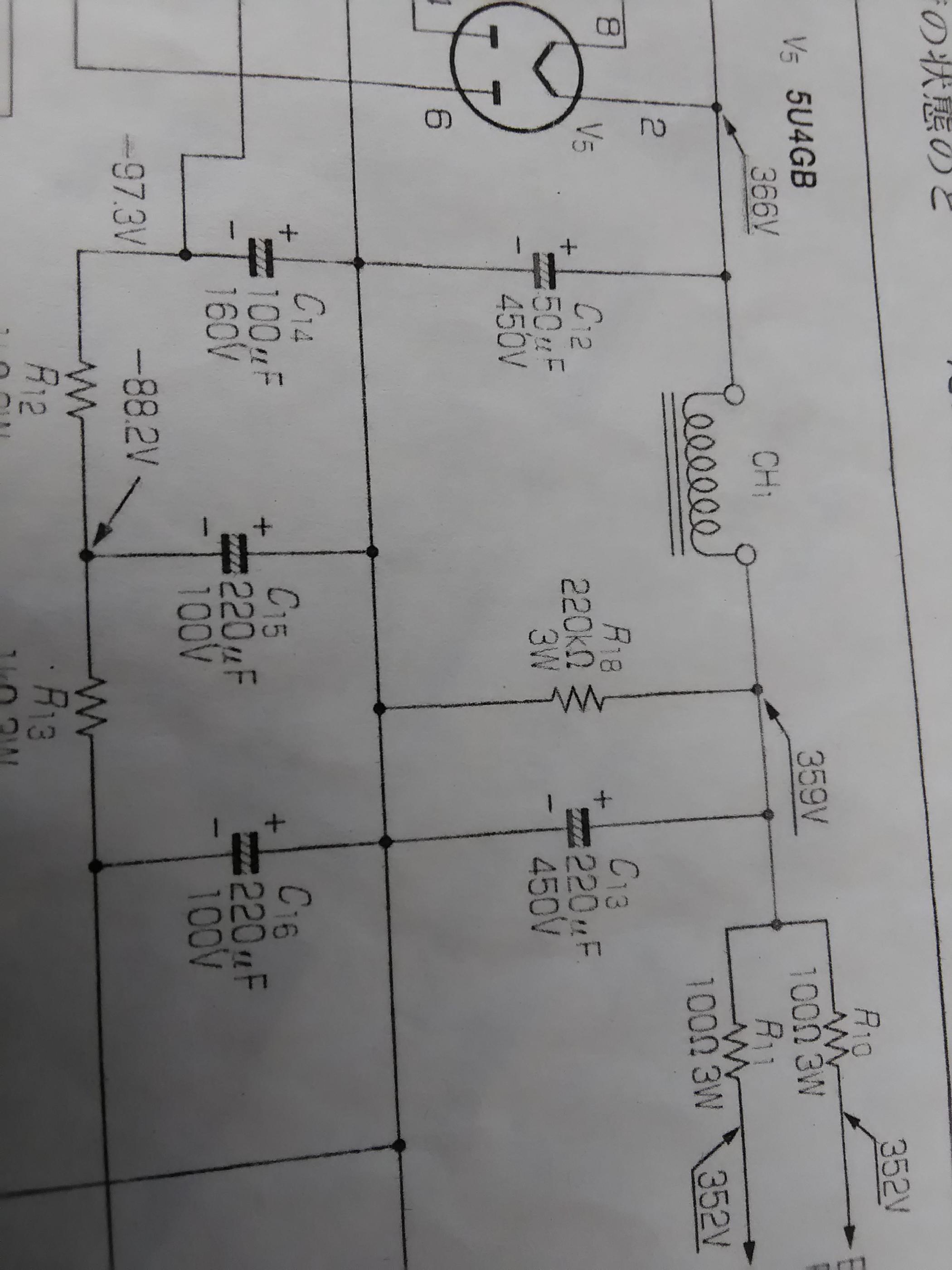

Thank you so much. Allensoncanon, sorry for my explanation. Plate at 300B is around 350V but ec88 had some voltage too. I have checked wiring many times but nothing wrong. I have no experience at all for tubes so I am afraid but I will wait to warm up. Thank you 6U3sUMMER I will check with multi meter what you suggest.

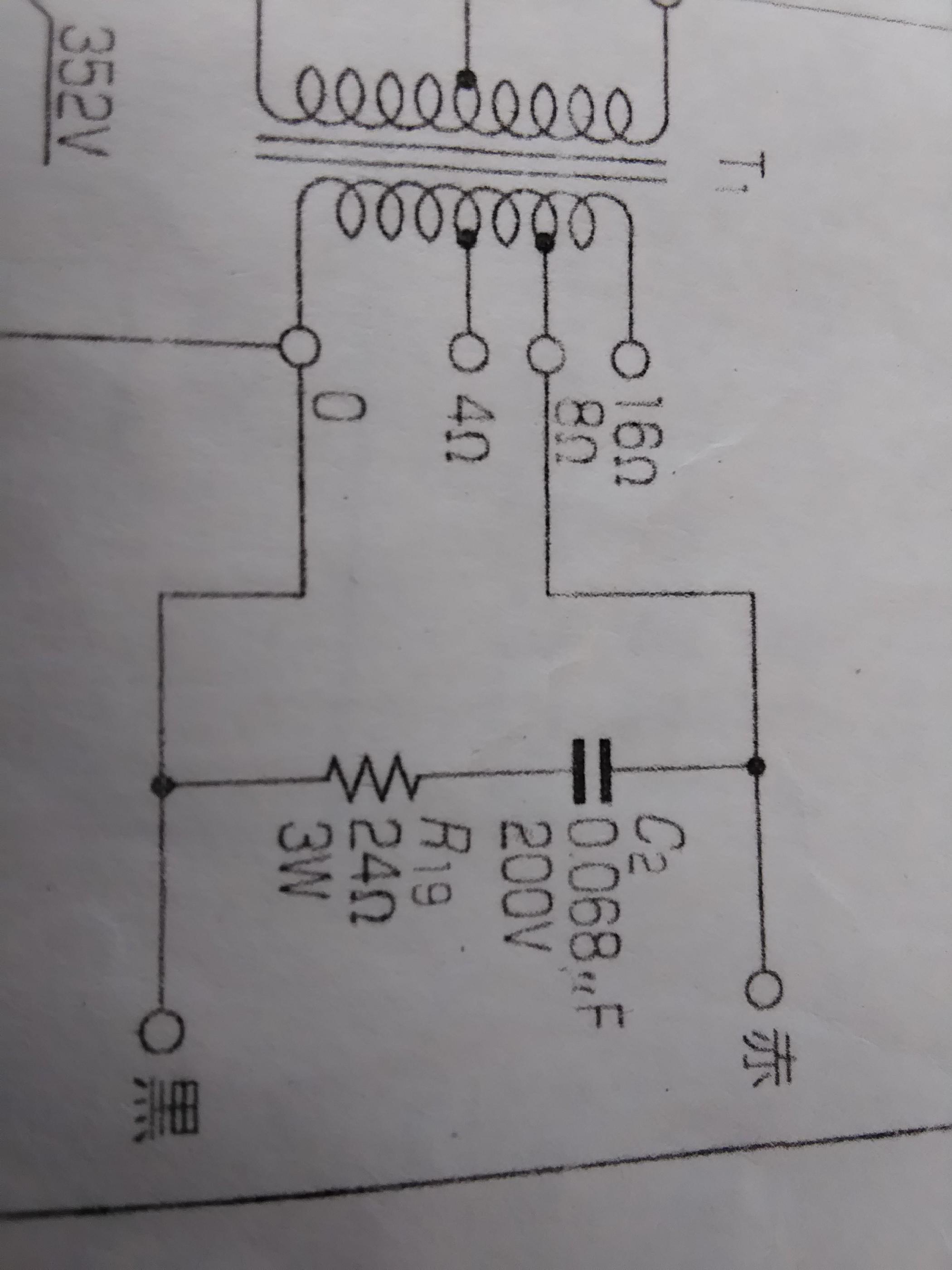

This book says he add 220kΩ to C13 for B+ bleeder so I will add. He also add 0.068uf and 24Ω on OPT to fix oscillation at 10kHz. I am not sure it works because this book use Tango FW-20s, mine is similer OPT from new ISO FC-20s. I have add type 50kΩ volume pod so it might be ok. TOKYO KO-ON DENPA WEBSITE Tokyo ko-on and Tokyo cosmos sells good quality volume pods,I saw many good reviews.

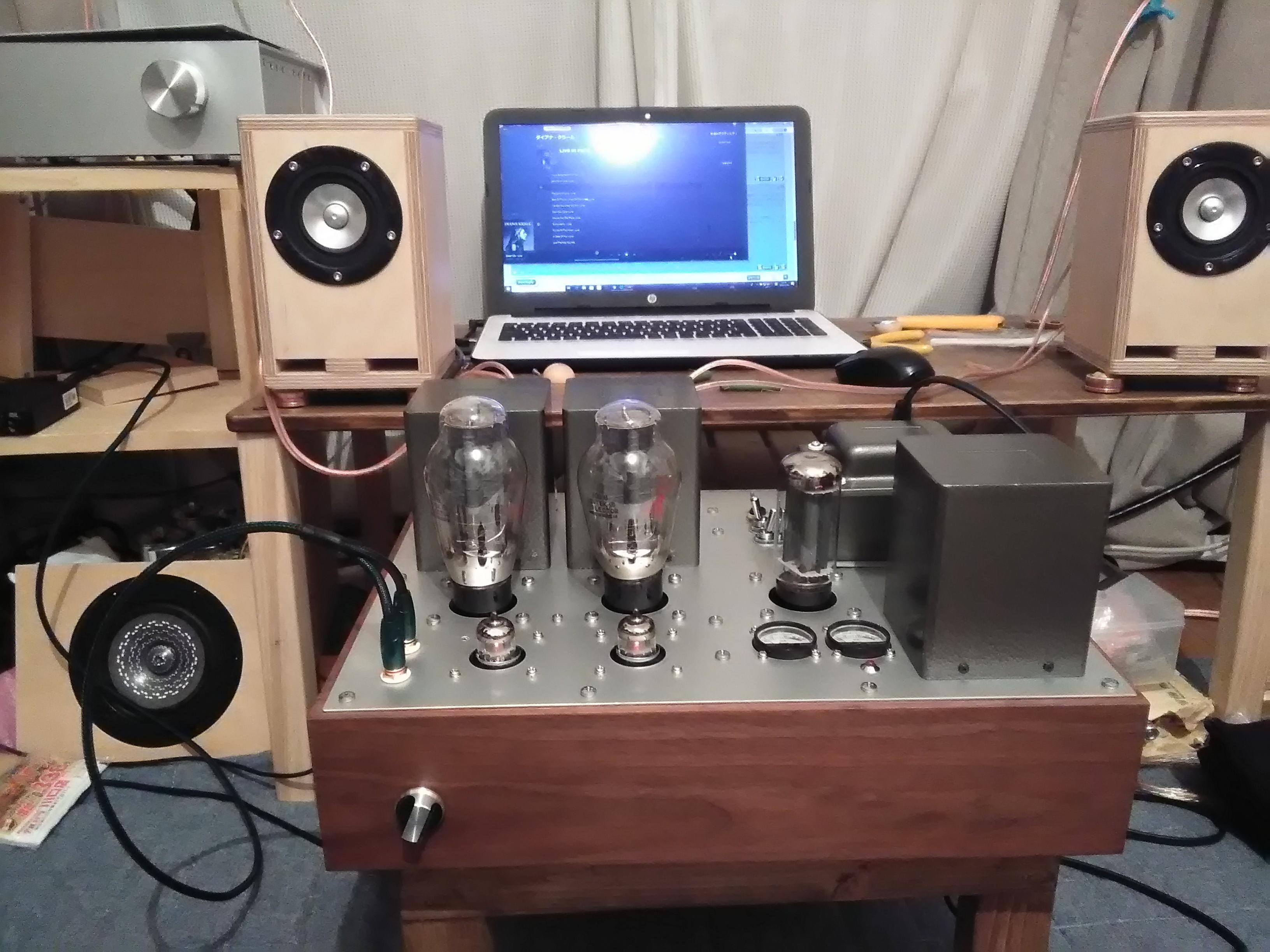

Yes!! surprisingly good sound!Its tight sound which I did not much expected! Thank you all for suggestings. I took out ES88 heater GRN but I will connect with 10Ω sooner. There is no feed back here but I can try later. Tubes are pretty hot. I am little scared but seems ok.
I would like to try gridstopper. I did not find any info from Japanses books or web.Only for guitar amps. Dose grid stopper connect between grid pin of 300B and C3,8 coupling caps? And how much Ω?For the EC88, it still is a good idea to use a grid stopper for each triode. Those are UHF RF tubes.
And do not forget to use resistors from the input tube 6.3V secondary connections to ground.
Is there any negative feedback?
I did not see any in the schematic post #1.
The shield of 6dl4 tube (aluminium cover) makes sound bad like spongy so took out. I also try to use 5AR4 instead of 5U4GB. I think I can use adjusting bias voltage. Adding bleeder resistor makes less plate voltage so It might works.
I am so excited that this amp sounds great. Thank you everyone and diyaudio forum!

Very nice build!
