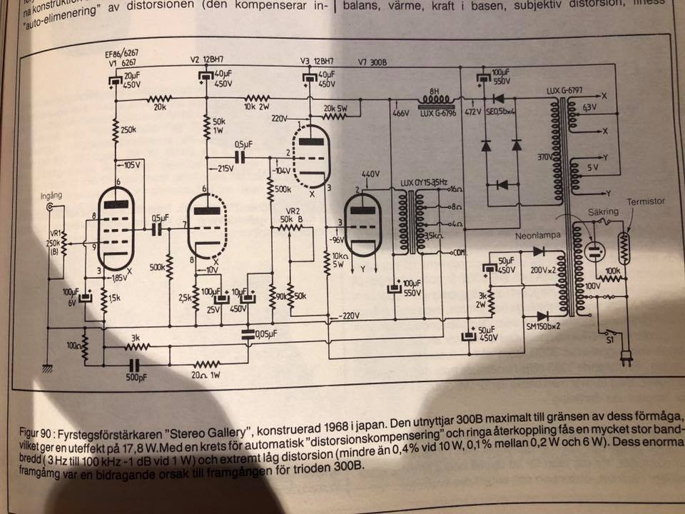

So my idea would be something like the JE Labs Circuit but with a DC heated 300b - I found the idea on the German webside frihu.com and attached the schematic.
I also contaced tubelab for a TSE-II board - but I would prefer a point to point layout and the sharp voltage regulator is also a problem.
Felix

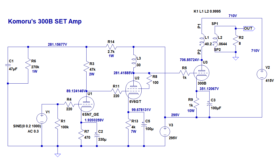

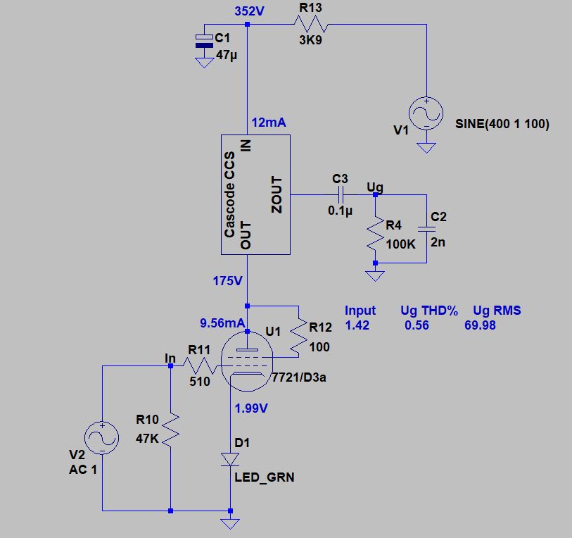

First, I heard both the original "Flesh and Blood" amp and Komoru's all-DC-coupled SE 300B amp at the Fi store in NYC, back in the day. I heard the F&B at a friend's place many times after that. I thought Komoru's amp sounded much better. I found the F&B kind of 'thin' sounding. I absolutely loved Komo's amp. That's a great one for a simple design, but it had stacked DC supplies, with >700V DC to ground. Could be dangerous.
If you took Herb Reichert's "Flesh and Blood" circuit (which is as simple and straightforward as it can possibly be) and improve on that, you should get a pretty nice intro to tube amp building, with a high chance of success.
What would I change?
Well, first, I would load the second stage plate with a plate choke, so that it can swing beyond its B+ (the choke stores energy). However, the 6SN7 has too high a plate resistance (rp) for almost any plate choke, so you'll want to change that tube to something with much lower rp, perhaps a 6N6P or 5687, or a triode wired 6V6 or EL84 type of tube. Or go really low rp and use a triode-wired EL86 (or Russian 6P43P). Komoru's 300B amp used a 6V6-triode with plate choke. The second stage is the one with the big voltage swings, so will be the one requiring most careful design.
It would be nice to DC-couple the 2nd stage to the 300B, which would again get you closer to Komoru's design. But that's more advanced stuff. You'd need to 'stack' the power supplies, which gets you into truly high voltage territory (>700V DC). One oops and it could be all over. Probably best to RC-couple the stages, keep the max DC voltages to <500V.
The input tube can be almost anything you like. It won't need to give you much gain. You could use the other half of the 6N6P or 5687, or you could use something like an EF86, 6SJ7 or 6AU6 triode wired. Or you could use a 6J5 (again, like Komoru did). You could even try a nice vintage low-mu DHT like 26 or 01A. But then you'd have to worry about getting rid of the filamentary hum. Maybe triode-wired 2P27L?
As you can see, even if limiting yourself to a 3-stage RC-coupled all-triode topology, there are lots of choices of tube types. Perhaps...
6J5GT (Russian 6S2S) RC-coupled to 6V6GT-triode (Russian 6P6S) with plate choke RC-coupled to the 300B.
Easier to lay out would be...
6N6P RC-coupled to 6N6P with plate choke RC-coupled to the 300B. Same idea, different tubes, only two required per channel.
All of the above tubes have Russian equivalents, so you could breadboard with cheap tubes and once you're happy with your design, search out fancy vintage tubes (if you want to).
Anyway, that's an idea.
