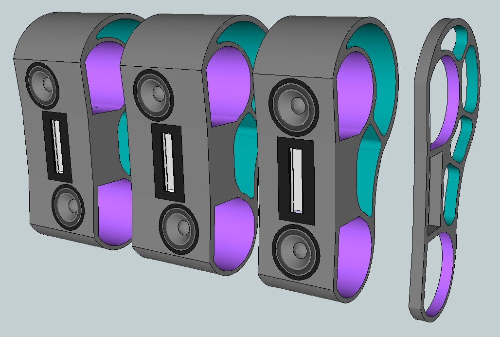

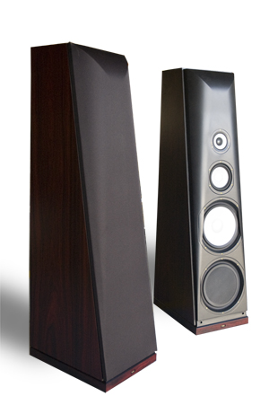

what about my concept baffle then where it changes in size for each driver? its like a varying baffle step. it will effect tweeter mid and woofer differently because of the arch type shape (varying baffle step)
sound waves arnt square, ok some are, but.....
Bit limited by only being able to use one driver shape at a time, but very educational all the same.
I was always under the impression that lining them up down the middle would be best, but that looks to almost be the worst thing to do...
I think the diagonal like the first photo would probably be easiest.
Edit:
Just had a play with the baffle shape WaVeInFoRm is playing with, and it can be simulated you just need to add more corners and drag it to shape.
Can't seem to find a way to curve the front face like I want to do in my design.
well got me 2 25mm 8x4 sheets to work with... cost a fair bit, and they weign 60kg each!
also i have found a broken sign made from some strange but very bendy material, so i can play with the 3d baffle idea i had. the idea being to provide some load to all drivers by changing the distance like a triangular semi waveguide that gets bigger as it goes down the speaker. also the angle from top to botton would change from steep curve at the top to shallow long curver at the bottom, to match frequency shapes. in theory. gunna be fun regardless

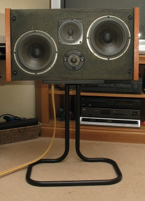

As you will find out, in later time, they are not "diagonal" (or should not be). The tweeter is in the middle... keeping with a vertical alignment as you can verify from the second good example. They are just offset, to the side, for a better baffle/driver relationship as you can find using "The Edge" or others softwares that modulate the front baffle. Because the woofers work much better out of symmetry positions or resonances/peaks at fixed frequencies. There's this classic speaker that was much praised here in diyAudio the Gales. You can find that mid and tweeter are trying to keep a vertical alignment.
Yes upon closer inspection I can see now that they are not diagonal.
