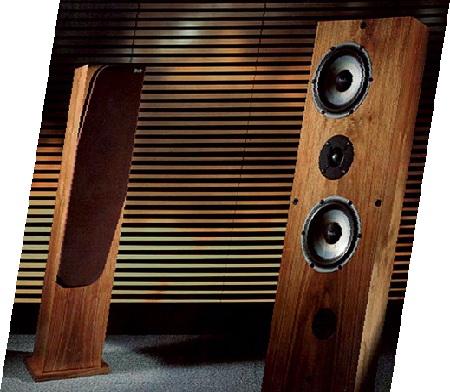

You could consider this series cross over. Especially if you don't intend to measure/simulate. You can't biwire etc., but crossover points tracks each other, and tweaking is quite easy (sorry it's in danish but I think you can understand anyway)
understand anyway)
That's dragging out something from the past. Its a 2.5 way not
a 3 way and it is not suitable for a 10" bass and 5" midrange.
rgds, sreten.

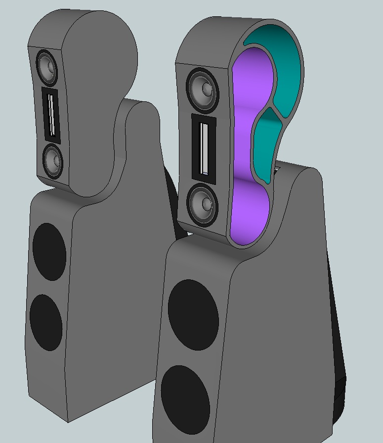

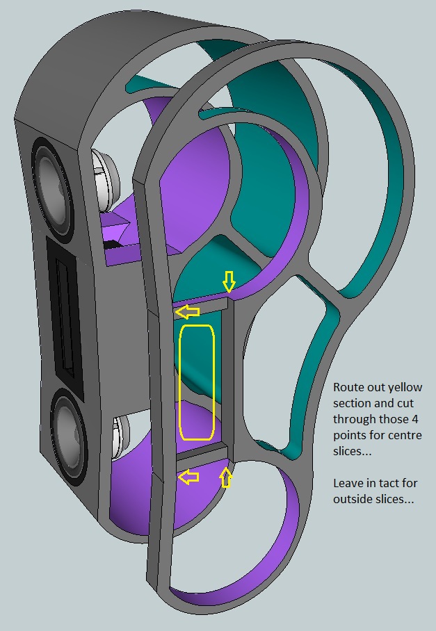

While researching the Raal tweeters I came across this website that uses a flat baffle to mount the tweeter and wondered why he chose such a wide baffle...
Edit:
More recent version with centre section more rigid and reduced volume...

Ok I was going to ask if you meant to offset the drivers for the sound or the cabinet. I was almost envisaging something like this...
Offset in the cabinet but still horizontally lined up.
So what are you are trying to achieve by offsetting the drivers???
1) To help distribute sound reflection inside the cabinet, by causing uneven pressure waves?
or
2) Helping break up a linear sound from the driver output?
Guessing from the examples you just posted number 2???
