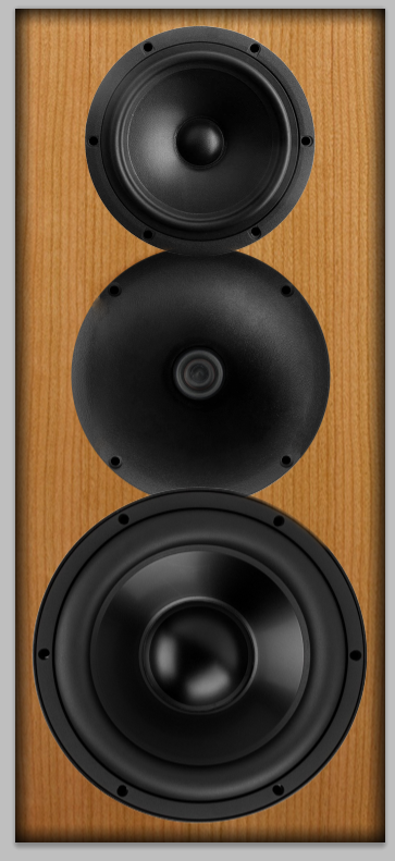

I'm currently working on a project for a 3-way monitoring system for mixing and mastering and I'm looking for some advice.
I mix and master mainly acoustic and classical music. I currently work with lipinski 707 + diy subs that I will keep, but have to go surround and 3 more lipinski are out of my budget.
The speakers will be amplified with hypex fusion amp, so crossover will be very flexible, and I have the possibility to do measures in a well sounding room.
I've build successfully two different designs from Troels Gravesen that turned out well, so I've some little experience.
My budget is 700€/speaker maximum. I would like to have sealed speakers, I'm used to this kind of sound.
The driver that I've selected are:
tweeter: Scan-speak R2604/832000 with modded WG-300 waveguides (adaptors and cut to have them 1cm closer to the mid unit)
low-mid: Scan-speak 15W/4424G00
woofer: Dayton audio RSS210HF-4
I'll start experimenting on crossover at 250Hz and 2.2kHz
The internal dimensions of the enclosure will be 50x20x23cm
There will be a separation that gives around 15 litres for the woofer and 3 litres for the mid.
Drivers, heavy bracing and plate amps take the rest to reach the 23 litres total.
I’m thinking at a WTM configuration, primarily for the reason that’s is simpler to separate de enclosure for the midwoofer and maybe for less diffraction.
What are your opinion on this choice?
Would it be a good idea to do an asymmetrical or particular shape of internal mid compartment to minimise resonances and back reflections?
Do you see any problems on this design?
Images are front panel design, and W and M drivers with the volumes i'd like to use.

I used to own L707. It was a bit soft sounding for my work, but I'm sure it should be great for classical music!
I have never seen commercial WTM small monitor like this. Anyone makes something like this?
I came to L707 from PMC IB1 and after the first shock I began to like them a lot. I run them with 2x12" diy subs (Evidence LAB12, 45l, sealed, used as stands).
Never seen WTM in studio monitors, but I can't see any problem for it....

One possible problem for near field monitor is, would it be more sensitive to vertical ear location than conventional design. Should be fine for midfield, though...
i see your point, it will be midfield by the way.

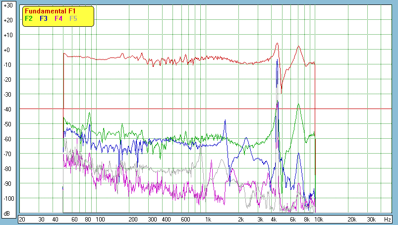

What's wrong with the resonant peak? Of course it has a resonant peak it's a metal coned driver, what's new?
The issue is where is the resonant peak?
With this driver it's at 4.3kHz. The associated harmonic distortion peaks occur at the highest of 900Hz with the 5th harmonic. Clearly this is going to be well attenuated by any proposed crossover. The target of 250Hz was a good one and would work well.
Yeah the driver is insensitive, but it goes deep in small boxes and has plenty of excursion to back this up. All you need is power. If you've got power then no problem!
Direct from Zaph's website, the sub driver is impressively clean up to 900Hz.

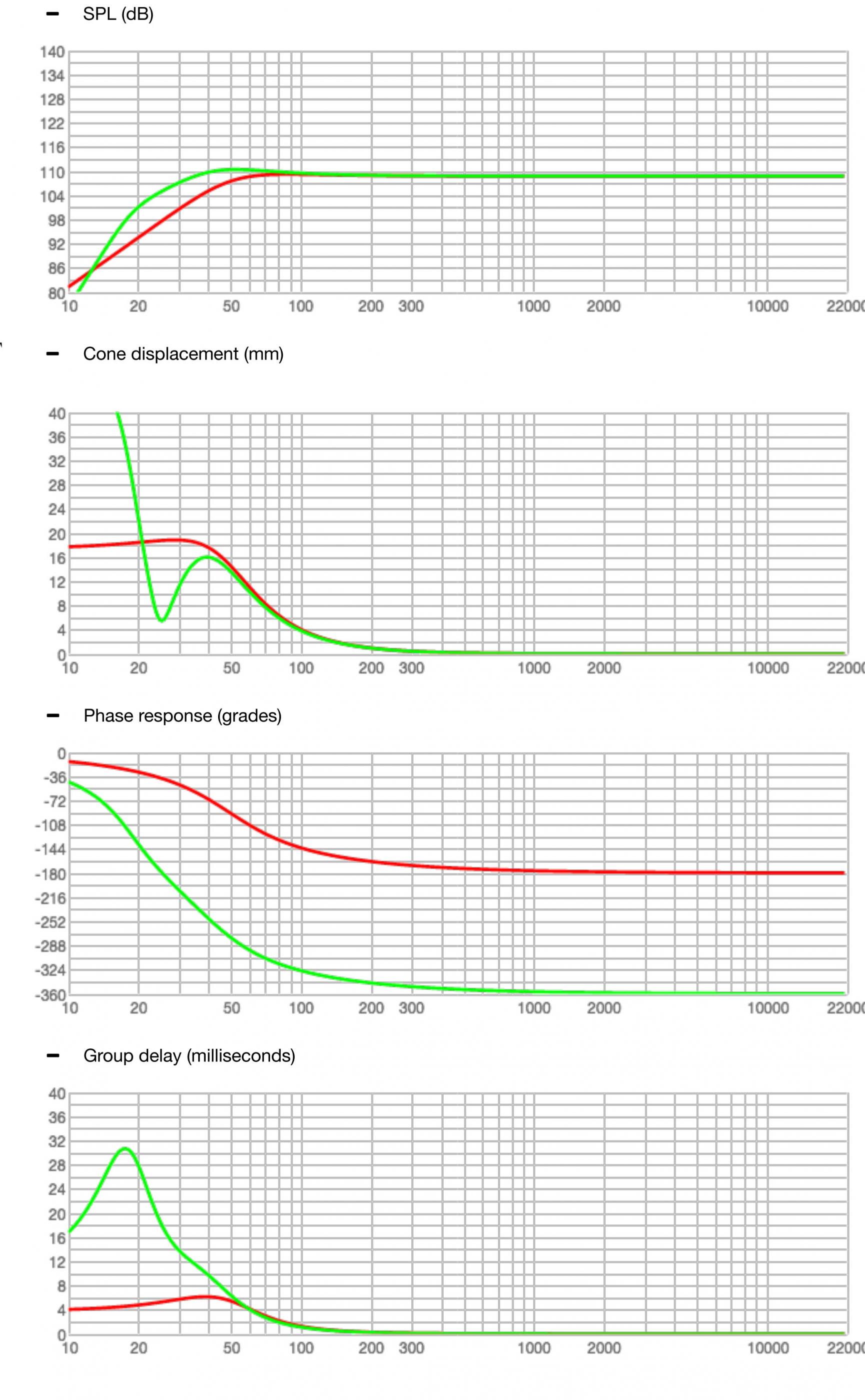

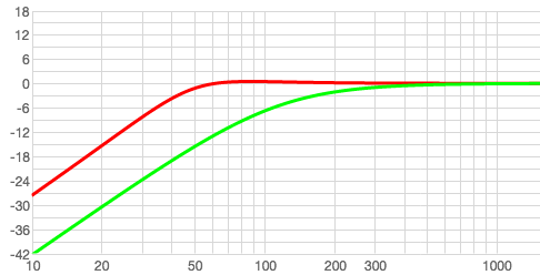

For the RSS210 the amount of power is no problem, but what scares me is the low xmax (9mm). Quite odd for a sub driver with such suspension. Should I read +/-9mm?

Yeah it's absolutely +-9mm for the Dayton sub.
I suppose another option could be the UM8-22. I don't know how this sims but it's a beast of a driver and has copper in all the right places.
Yes, I considered that monster.
FR looks similar to the RSS, it sure can play louder but it need a LOT of power due to its lower sensitivity. I also think it will be slower cause the diaphragm is quite heavier. I think I'll go with RSS.
Main issue is the sound. I tried the Dayton in combination with a Seas Coax and it had big problems with male voices. I even purchased a second pair woofers for comparison.
In the German magazine HobbyHifi, the Dayton RSS 210 HF was impressively clean as well. Obviously its impossible to measure everything that counts.
