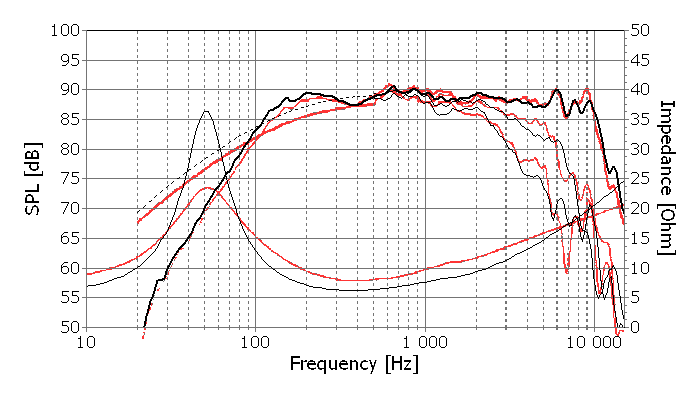

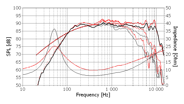

That seas unit certainly looks good on Paper Moondog, has decent power handling and the price is good. Interesting that the seas graph (in the pdf) is quite different (better) to the madisound one...
Always a bit tricky to compare 2 charts with different "sizes"
Here are the SEAS data (red) vrs the Madisound straight up and then the same with the red level shifted.
dave
