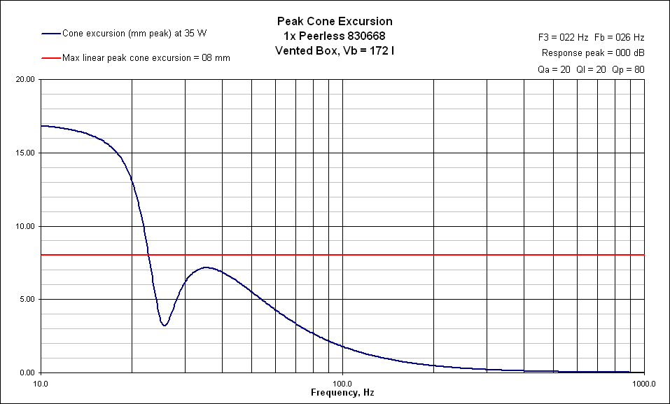

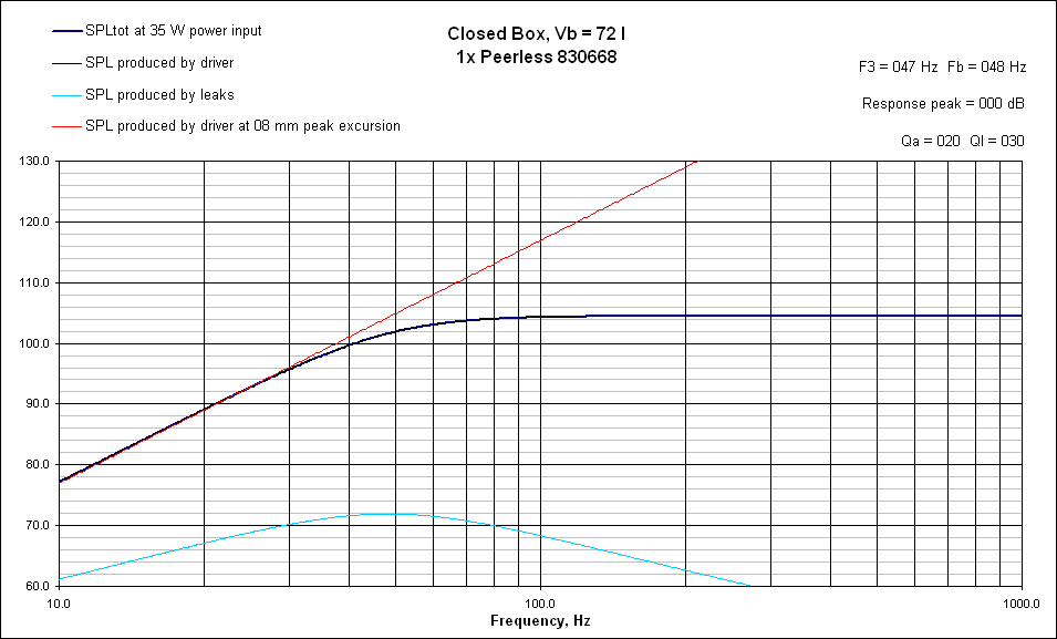

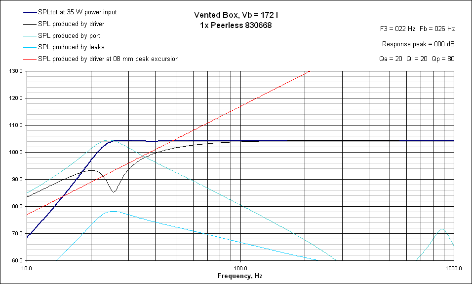

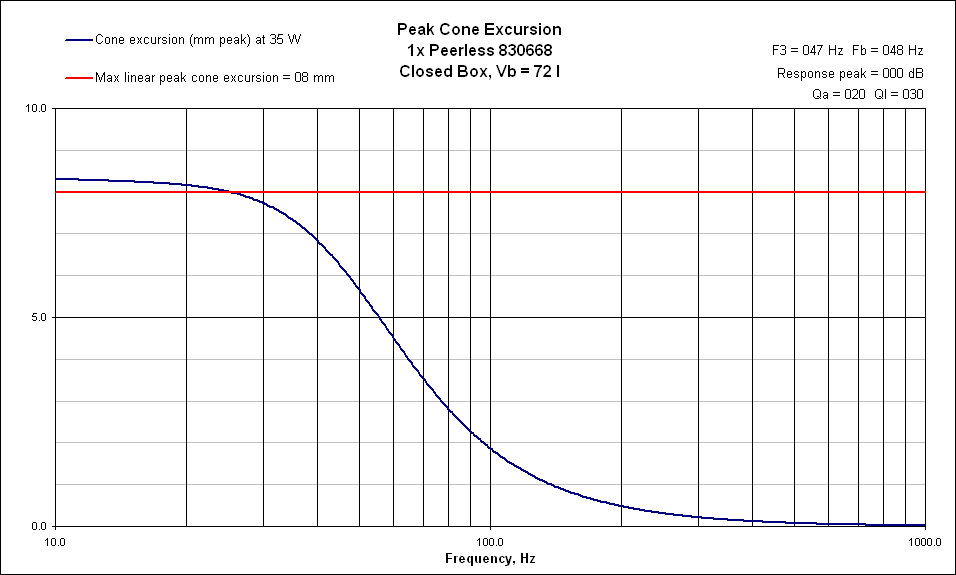

Which woofer Moondog? I modeled the peerless 830668 but didn't post after rabbitz mentioned he would steer clear of peerless....
It doesn't look too bad in a 72L box (modeled with unibox) but it isn't going to break any records for powerhandling... keeping it at or below 35W will allow decent extention without going too far out of it's linear range, according to the model. F10 appears to be around 28Hz...
72L is pretty big (It is what I currently have my Vifa 10" drivers in) though that is ported... Sealed is certainly better from a simplicity point of view but vented may allow a smaller box (depending entirely of course on the woofer in question).. This peerless is definitely not suited to vented..
anyway attached is the unibox model at 72L
Although Unibox doesn't recommend vented (I suspect that it only recomends vented up to qts 0.5), I modeled it anyway 172L box is pretty flat down to 25Hz (something fishy going on me thinks) with an F3 of 22Hz and an F10 around 18Hz... Well within linear excursion limits to 22Hz at which point it goes off the chart... However a) 172L will be too big I think for most people, and b) a model and real life may be quite different
Tony.
Tony.

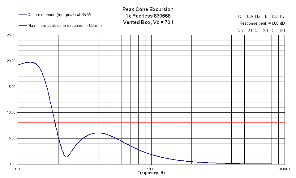

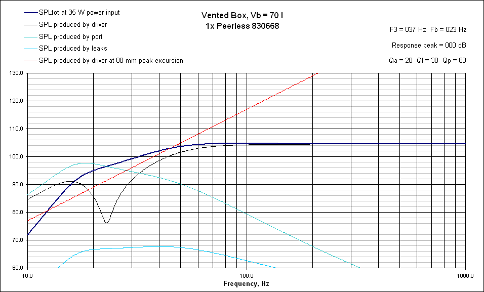

ok I just decided to play around with the modelling... not using any normal alignments and got an interesting result with 70L vented tuned to 23Hz... Whether this would work in reality however I don't know... certainly not a perfectly flat response, but a peak of 0.24db at 92Hz isn't that bad.. very interesting response rolloff for a BR box... I've heard of tuning below driver resonance to get this kind of effect but have not tried it... Just putting it out there, this is in no way intended to be a suggestion!!!
attached graphs.. F3 around 37Hz F10 around 19Hz.... but don't give it a signal less than 20Hz or mechanical failure is likely!!!!
Tony.
Tony.

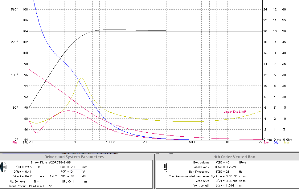

How available are Silver Flute?
Here is a similarly strange vented box for their shielded 8". I didn't optimize the vent... it will be long thou
Silver Flute W20RC38-S-08, 8" Wool Cone - Shielded from Madisound
dave

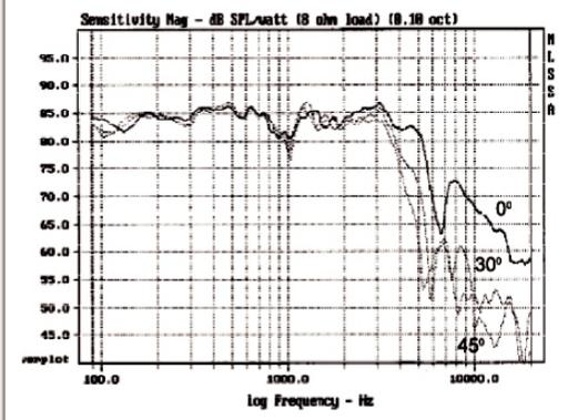

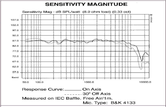

the first of the two attached images is the original graph I saw for the MW144 (which is the one I made the decision on).. I did my own measurements (which are dubious) but they were no where like it... they were actually a lot closer to the second graph, at least at the end of their range.. I have a big dip, but it is at 2Khz not 1Khz. So I guess what I'm trying to say is that good (or bad) graphs from the manufacturer probably need to be taken with a grain of salt. The fact that the morel's were used in a lot of high end speakers was one of the things that pushed me in that direction, the other was the fact that they were similar to the renound Dynaudio drivers...
Tony.
