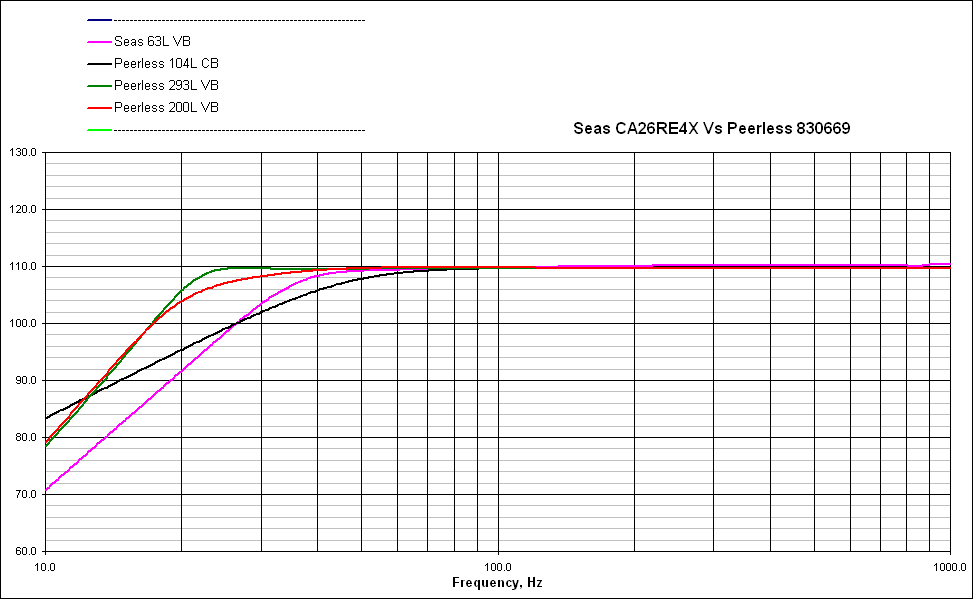

I modeled the Peerless 830669, which was about the only 12" I could see on Madisound that came close to meeting the requirements, and with the peerless 12" in a 104L sealed and the Seas 10" in a 63L vented box the Seas was better for Bass extention (down to 27Hz after which the 12 inch took over). You needed to go vented with the Peerless to get any significant advantage over the 10" seas and at that point the cabinet size was 200L or 293L for the ultimate extension... This made me think that the 10" Seas really was a winner as far as bang for the Litre was concerned! All modeled with 80W input power.

Wintermute.... interesting comparision between the Seas 4X and the Peerless 669. Thanks for posting. I have played with both and Seas sealed box cousin.... the 4 as well.
If I were to choose between the 4 & 4X... I would naturally prefer the 4. Both the 4 & 4X have about the same efficiency... and in roughly the the same size box exhibit a near eqaul f3... except the 4 is easier to work with... and has a better hf roll off and sounds cleaner. The 4X in it's ported box does seem a touch more dynamic... mainly in the mid bass area... but does not go as deep as the 4. The sealed rolloff is naturally shallower. Better transient responce too.
Other considerations... the Sealed 4 also seems more forgiving with room placement and with it's smoother roll off it is easier to cross... you can even run it wide open... bare back if you will.. it's midrange is that good. I had a pair of these as RMAF earlier this month in 1.75 cu. ft. boxes running bare back with the SS Revelator tweet (D2905) on top and those who heard them were amazed. Dare I say better than the majority of systems there. Not just my conclusion... but this was also stated by several others.
With a single 10" with a limited 4 MM peak xmax you are done at about 100 db at 40 hz.... just the way it is. But for most listeners with most music that is plenty!
As for the Seas 10's up against the 669.... The shear dynamics and displacement of the 669 is hard to ignor. The 669 will play at live levels in most domestic settings. F3 in a heavily stuffed 4 cu ft with a large inductor is about 37 hz with f6 around 29-33 hz depending on room placement. And you are flat at 40 hz. Also have a net efficiency of 91 dbw. And you do not have to counter sink the low defraction frame. And it is less that half the cost of either of the Seas. Simple and cost effective. Have pics if any one is interested.

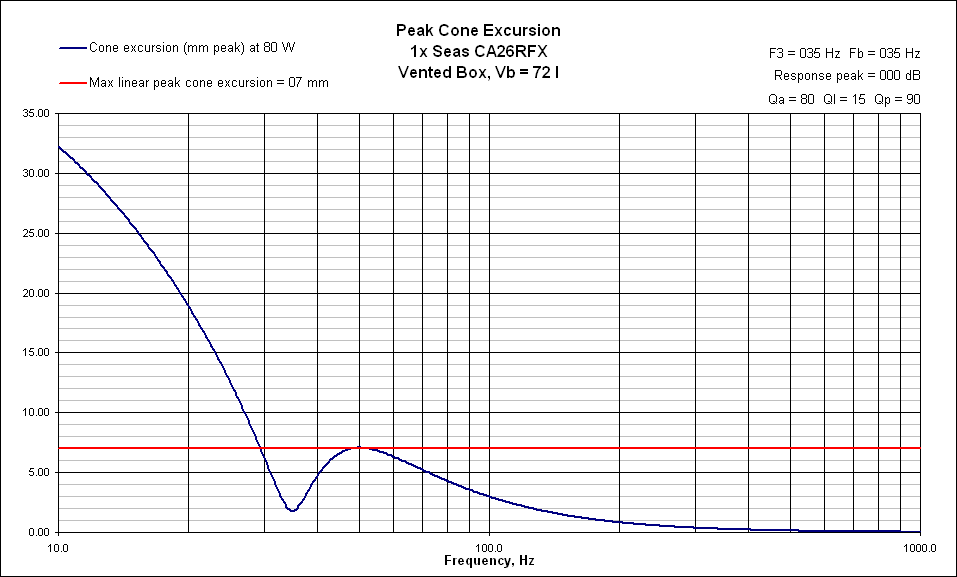

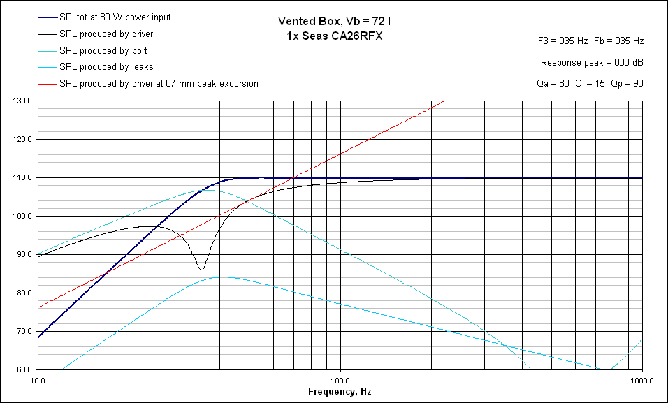

Any reason why you choose it above the CA26RFX? It got almost half the linear and max travel and lower wattage.
Mainly the cost Andre! I will have another look at the CA26RFX I modelled a lot of drivers and didn't take notes ;)... The other thing was the CA26RE4X looked like it would be a little easier from a crossover point of view (as it seemed to have a flatter response)
The CA26RFX certainly has a big advantage in xmax, 7mm compared to 4mm... in the modelling at 80W (which is what I modeled the others) It keeps within the linear range at all times until 30Hz after which it becomes a problem.. Other than that it models almost identically to the CA26RE4X (albeit requiring an extra 9L box volume).
edit: Note I haven't listened to either, and a model is only good for getting an idea, the tonal differences could vary a lot.. anyone who has listened to both would be in a much better position to make a recommendation!
Tony.
