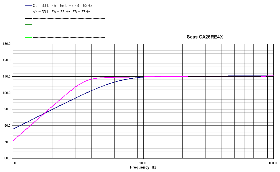

Hi Rabbitz, The SEAS CA26RE4 (without the X) was one that I had modelled and thought was a good candidate.
I also wonder whether people will be happy with the bass extension... I've only ever had Bass reflex so I'm actually not familiar with the sound of sealed enclosures with their more gentle roll-off.

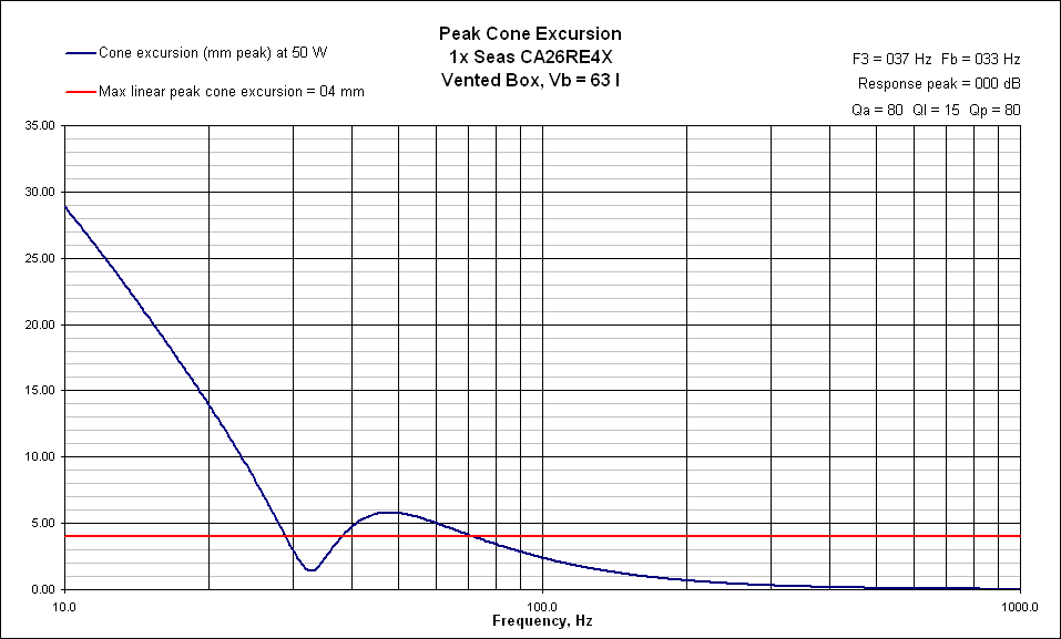

I tend to be in the vented camp to get more bass extension. The volumes for those drivers I got from Madisound's recommended size as with a new computer I haven't installed the modelling software. I think they have struck a good compromise between extension and power handling.
I don't know how low builders would want to go but 35Hz is not a bad goal with a 10" driver.

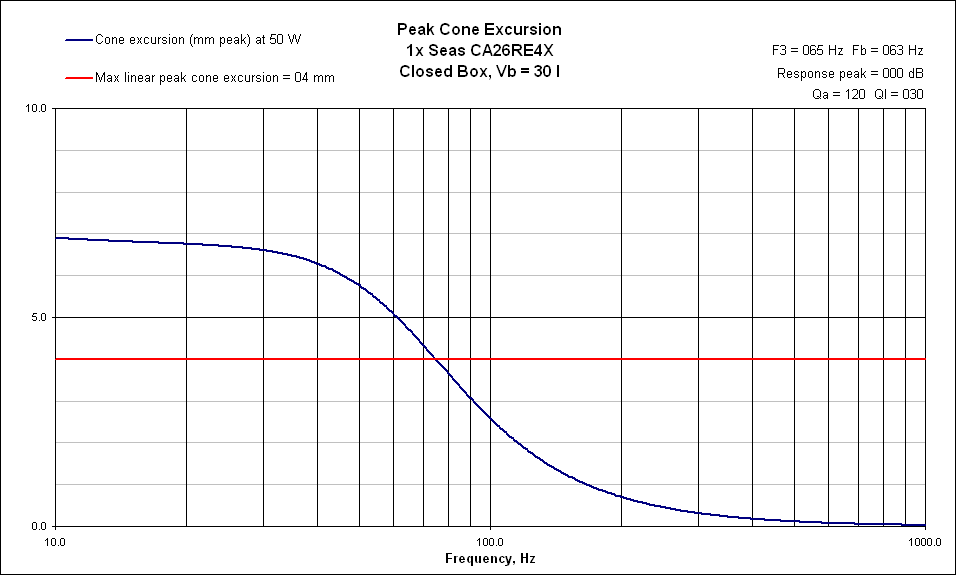

In room 35Hz with a 10" in say 40 liters sealed is not diffcult. Vented does give more bass efficiency but I suspect (and I can be wrong) that most of us will place these speakers close (within 2m) of atleast the rear wall, besides since these speakers will be floor standers they will get gain from the floor. Hence maybe sealed (sealed boxes are also more tolerant of small deviations in either driver specs or cabinet contruction) might be the way to go.
there are a lot of options for 35Hz from 2 x 10" in 60-80 liters sealed - the Peerless 10" (830452) is one such driver.

OK here are some models of the Seas CA26RE4X (basically the specs on the madisound site).
The sealed on has NO stuffing at all (that was the only way to get something to match with the specified 30L
The vented is with "walls covered".
The first graph compares the sealed vs vented performance for the two models..
The next two are peak excursion graphs for sealed vs vented... The sealed is the safer of the two in that it doesn't matter what freq is sent to the woofer it will never exceed it's maximum mechanical range of +- 10mm with all powers up to its rated 80W.
The vented however will have problems if fed high power signals less than 25Hz (with 17mm peak excursion at 20Hz and 80W).
I've posted the excursion plots at 50W power.. at 20W power the Bass reflex stays under the 4mm xmax, the Sealed still exceeds it slightly. Overall the vented box I think wins hands down for this woofer (provided it is not fed with high power at less that 25Hz), with much better bass extension and with what should be quite a bit lower distortion at moderate levels.

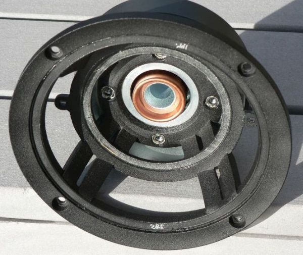

The only SB Acoustics I've played with is the SB15NRX. The build quality is exceptional and close to Scan Speak quality, great motor with copper in the right places and very low inductance voice coil. I compared it to the 18W8531G00 (not really fair) and certainly came close in a lot of areas. I still think they need a bit of work on their cone material as there was a hint of hollowness in the mids (I thought so anyway and Andy G also picked it up on a listen). Experimenting with damping coatings did improve it. I think the cone material is probably the same as on their woofers but once they sort it out on the mid woofers, look out.... early days yet.
They are easy to work with and are one of only a few drivers that don't have that bathtub shape plot in the lower frequencies for power handling modelling.... very impressive. It went lower and better controlled than I expected and the strange blips higher on the FR didn't show up in listening even when using 2nd order electrical crossovers but I don't listen directly on axis.
Have a look at the nude SB15NRX.
