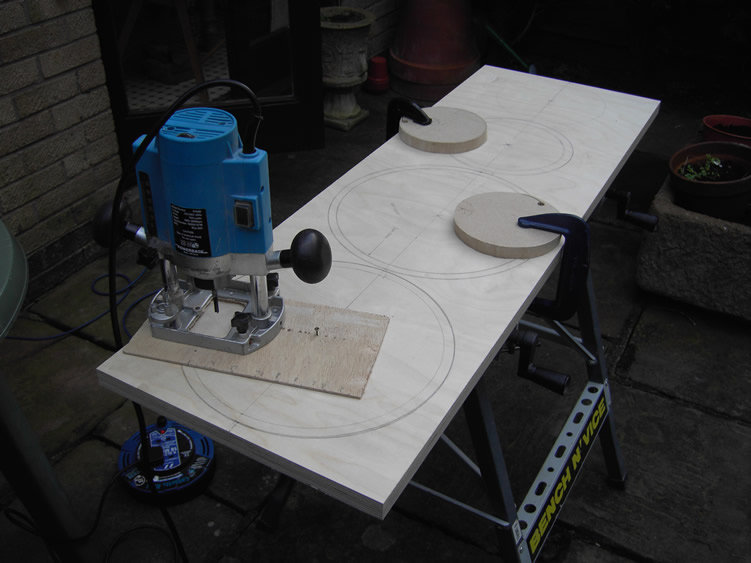

Now it's morning and I badly need a cup of tea!! It's a (rare) sunny day here so I'm going to look at cutting the first waveguide discs. I'll need three panels to reach the desired depth. I'm thinking of cutting three discs - each smaller than the next - before gluing each to the next ready for finishing in the lathe.

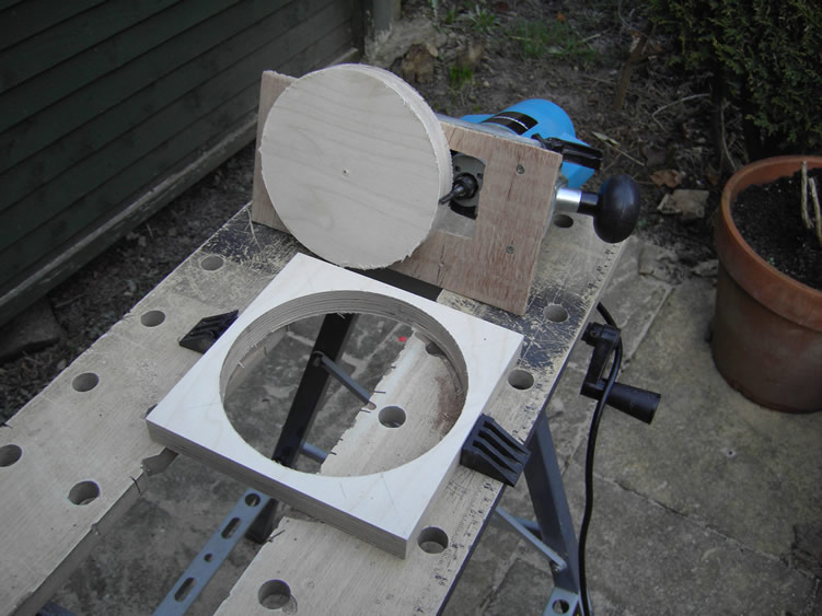

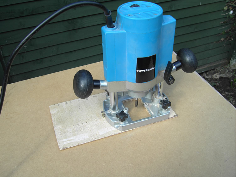

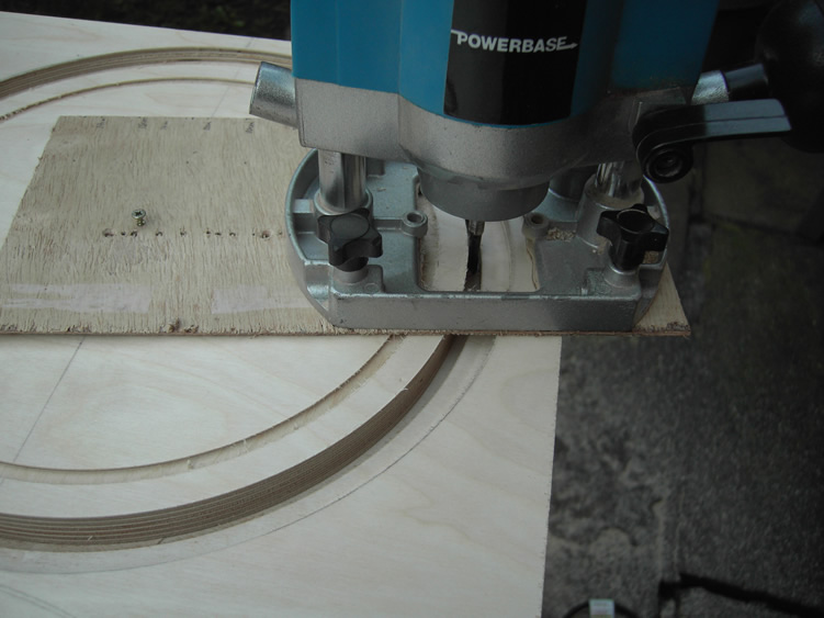

Last weekend I made a circle-cutting jig for my cheapo plunge router. I used a thin piece of plywood for this task. It's worth showing for those who have wanted to cut neat circles and rebates and wondered how it's done. I only just found this out last weekend :clown:

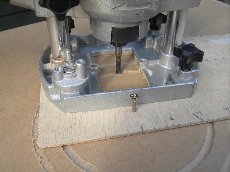

The picture shows how this works. The jig is screwed to the base of the router (a plastic cover is unscrewed and replaced by the new jig). A screw is driven through the jig and into the centre of the circle to be worked on. The router is turned around this screw to cut your rebates or cut-outs.
