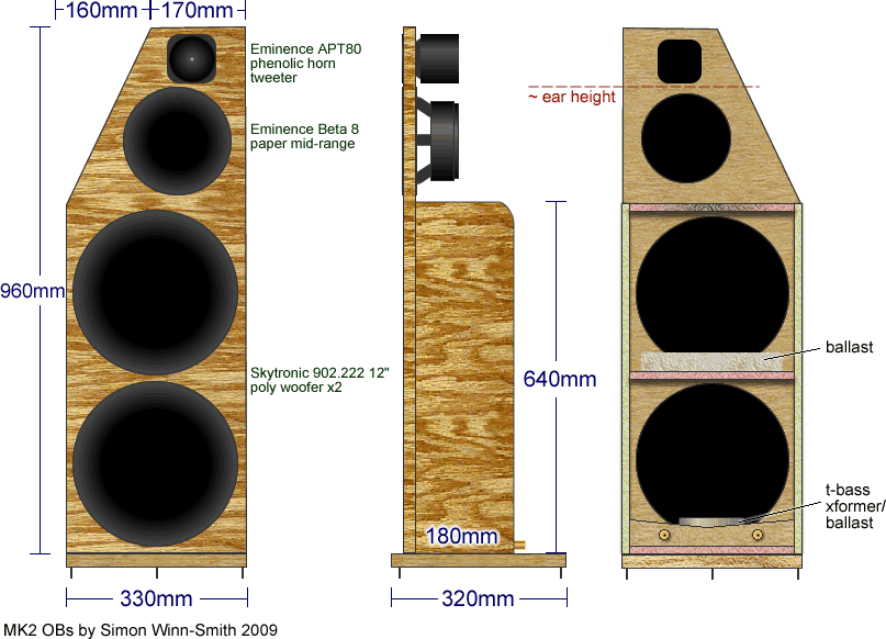

Would anyone like to comment on the tweeter position?
Should it be vertically centred over the mid driver or closer to the edge to minimise diffraction issues? At present it's sort of somewhere between the two.
Any thoughts about my idea for chipboard and veneered MDF?

Some ideas:
If you screw some heavy slabs (concrete, cobble stone, bricks or whatever you want) to the underside of the horizontal U frame braces you will have some real mass loading to the construction. You wouldn´t need the plinth to reach forward either because the baffle would NEVER topple to the front.
Don´t care too much about decreasing the back opening cross section. 10 % less will do no harm. You could even take a 30x20 cm slab and use it as the bracing instead of wooden ones.
There are mirror tiles of different sizes on the market. If you find them 20 cm wide, you could clad the U frame sides with them. It will make the U frame disappear visually.
Why don´t you want to build the top part of the baffle symmetrically with mid driver and tweeter in line with the woofers? The baffle would look like a pyramid with the peak cut off.
If you prefer the asymmetric look you could still line up midrange and tweeter with the woofers. You still would have a short and a wide baffle side to the drivers.

Lots to think about there, I've got to work on some ballast... See attached - 500VA tx is good ballast for the bottom, and I've drawn a paving slab on the mid section brace. The bottom will also have a brace so the bottom is two or three layers of wood/material thick. I do need to check for clearance behind the woofers.
The mirror idea is interesting, but probably not for me. I have no need to make them look small, I simply don't have much space.
I hear what you say about a cut-off pryamid, I'll have a go at drawing it. I've avoided it because of the extra work but if it looks much better....
On the sketch, the green and pink panels are coloured to remind me that they'll be the same size as each other.

Your design looks just right in terms of tweeter level. One thing for sure is tweeter position should not be at exactly ear level as that is not where the acoustic center is. I have been happy with tweeters about 100cm from the floor.
Hi Simon,
The mid/tweeter baffling looks fine to me. Breaks symmetry and keeps drivers more out from the walls.
However, you have a sided channel bebeath the mid which will develop its own sound.
If mine I would cut diagonally between about one inch back from the baffle at the top of your existing side wing to about one inch above floor level at the back.
This is something you can try before you make it. Try holding different sides up to your old speakers whilst they are making music.

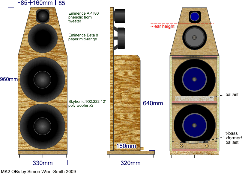

Hi Graham,
Can you clarify what you mean by cutting at a diagonal?
I had thought about the reflection from the mid driver onto the top brace, and I'd thought about cutting a shallow semicircle out of the brace and chamfering the edge to minimise nasty reflections. I don't know if it's needed or if it will help though!
I've attached the latest sketch including the cut-off pyramid shape - it does look better. I also added some more details to clarify what's what. I modelled this mid placement in Edge and we have a similar peak to before: 3dB, and roll-off is -3dB down from the flattest part @ 200hz. I'm worried about integrating that mess with the woofers.

Oh no Graham, don't say that! A gradual slant outward to the floor sounds good on paper, it's just massively harder to build, as Arnold Laver (et al) won't cut at an angle, and I can't match their cutting quality so want as many straight right-angled lines in the design as possible.
I personally prefer the pyramid style look and am pleased that it keeps the acoustic centres aligned vertically. On the other hand, the single slant arangement keeps the HF and MF drivers further away from the side walls, which is a plus for that layout. It's also slightly less complex to cut.
Overall I'm very pleased with how this design's shaping up, even if I sacrificed a lot of work today to get there lol

Simon,Graham Maynard said:The cut I attempted to describe was for the side wings to slant them with increasing depth towards the floor.
you need the complete U frame structure urgently. Please refrain from cutting off anything. Taking off the top baffle (or cutting holes in it) alone would cost you around 3 dB throughout the bass area. Slanting the side wings as described by Graham would cost you another 3 dB - at least.
Look at the first diagram here to get the message. In this regard your U frame would be equivalent to my H frame.
Rudolf
SPL responses tell us little about the *sound*.
A constantly dimensioned channel generates an audible signature due to differential pressure modification of the LF driver's response, also when excited by a mid or corner reflection. Sloping (support) wings reduce the channellised wing sound.
I think one driver having almost no wings (start of slope) wired directly in parallel with one having shallow wings (end of slope) will reproduce much more cleanly than a baffle with full woofer height parallel wings. This was why I suggested to Simon that he try holding different shape/size wings up to his baffles whilst music was playing.

Hi Rudolf,
If I disobey you it's not because I didn't listen first. I'm contemplating a slant, but I'd not remove the top of the U, and to compensate I'd make the bottom of the wings wider. This might be the best of both arguments - each woofer bringing slightly different sounds to the table.
