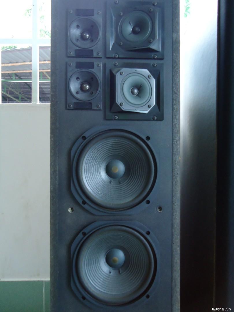

Here are the original speakers!

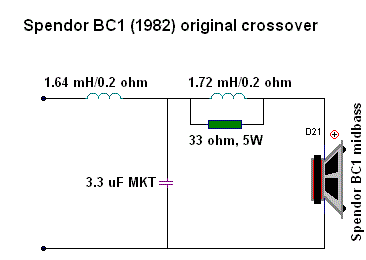

I can only think you figure out the original crossover, or redesign along, say, Spendor BC1 lines for a lowish crossover to the mid, which is going to behave quite similarly to the old Celestion HF1300:
Spendor BC1

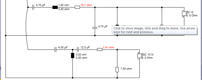

Check these XO's out! They are 1st order and they seem to behave quite pleasant!

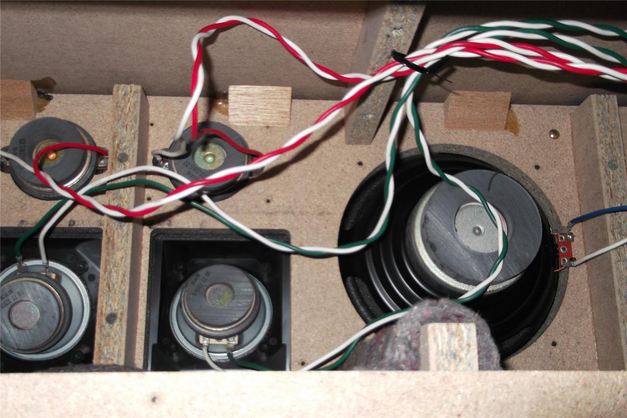

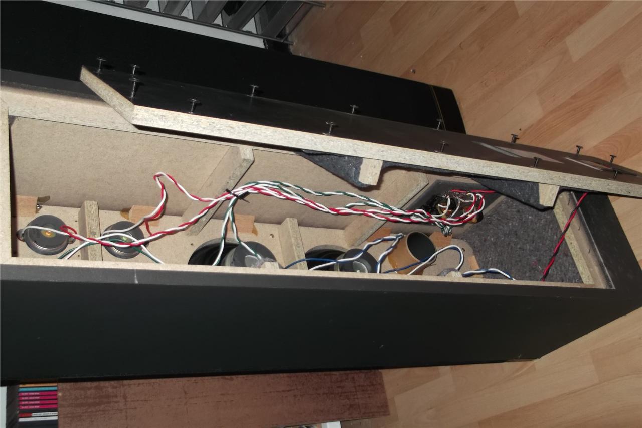

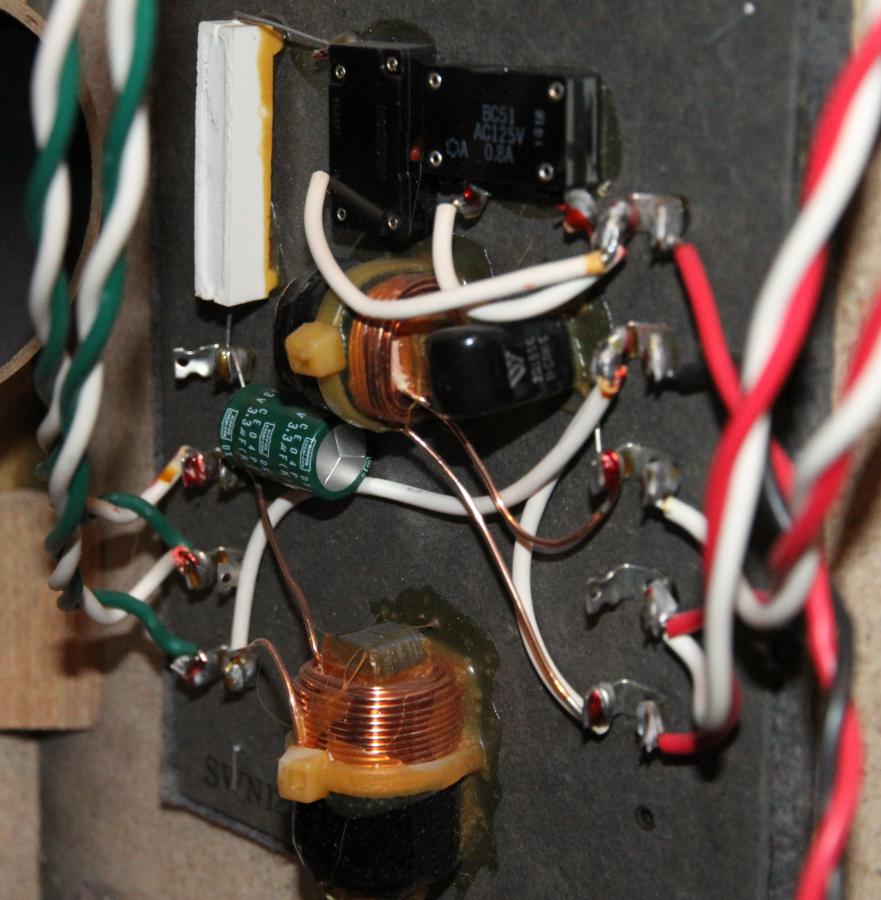

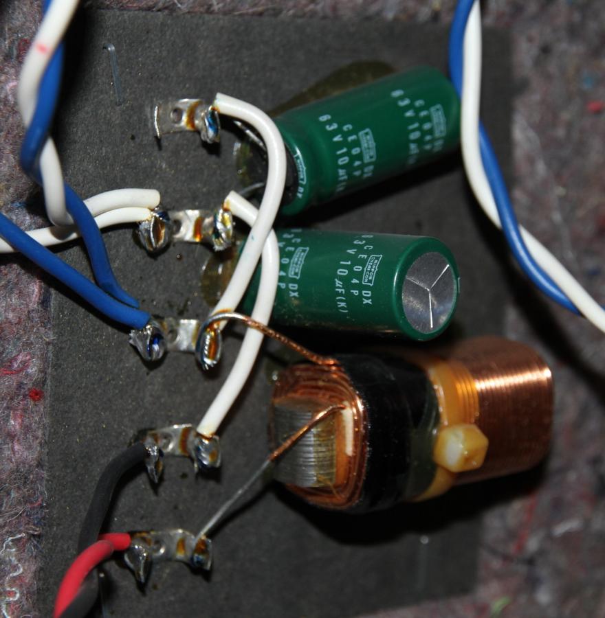

Lower are the original crossovers and a pic of the interior of the original speakers!

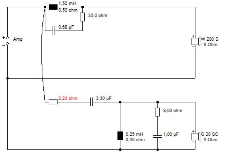

Oszkar, I really don't have time to develop a 3-way crossover for such unpromising components as you have chosen. 😀
I can suggest a 8" plus 1" two-way that ought to sound reasonable in a 30 litre box. Below.
That's all you get from me. 😎

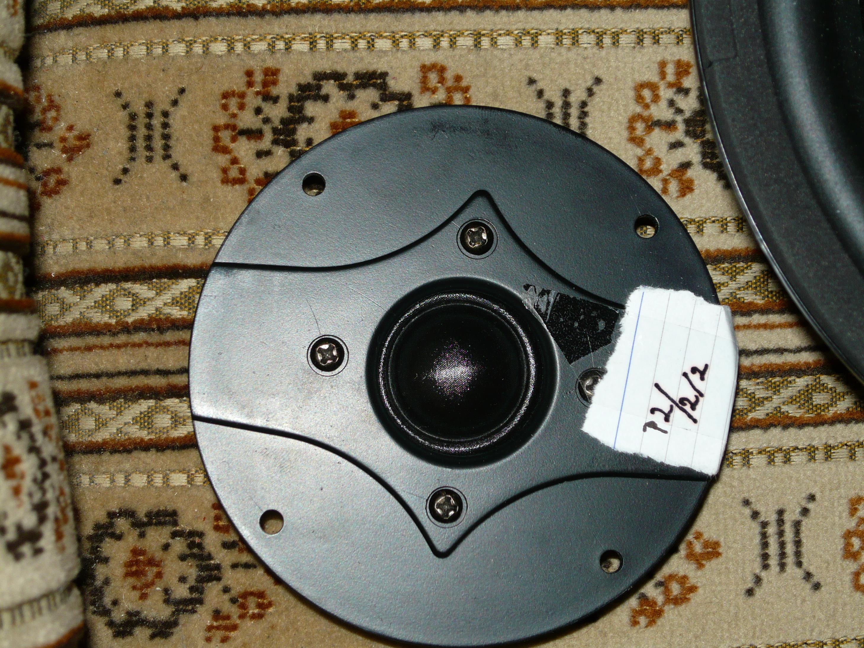

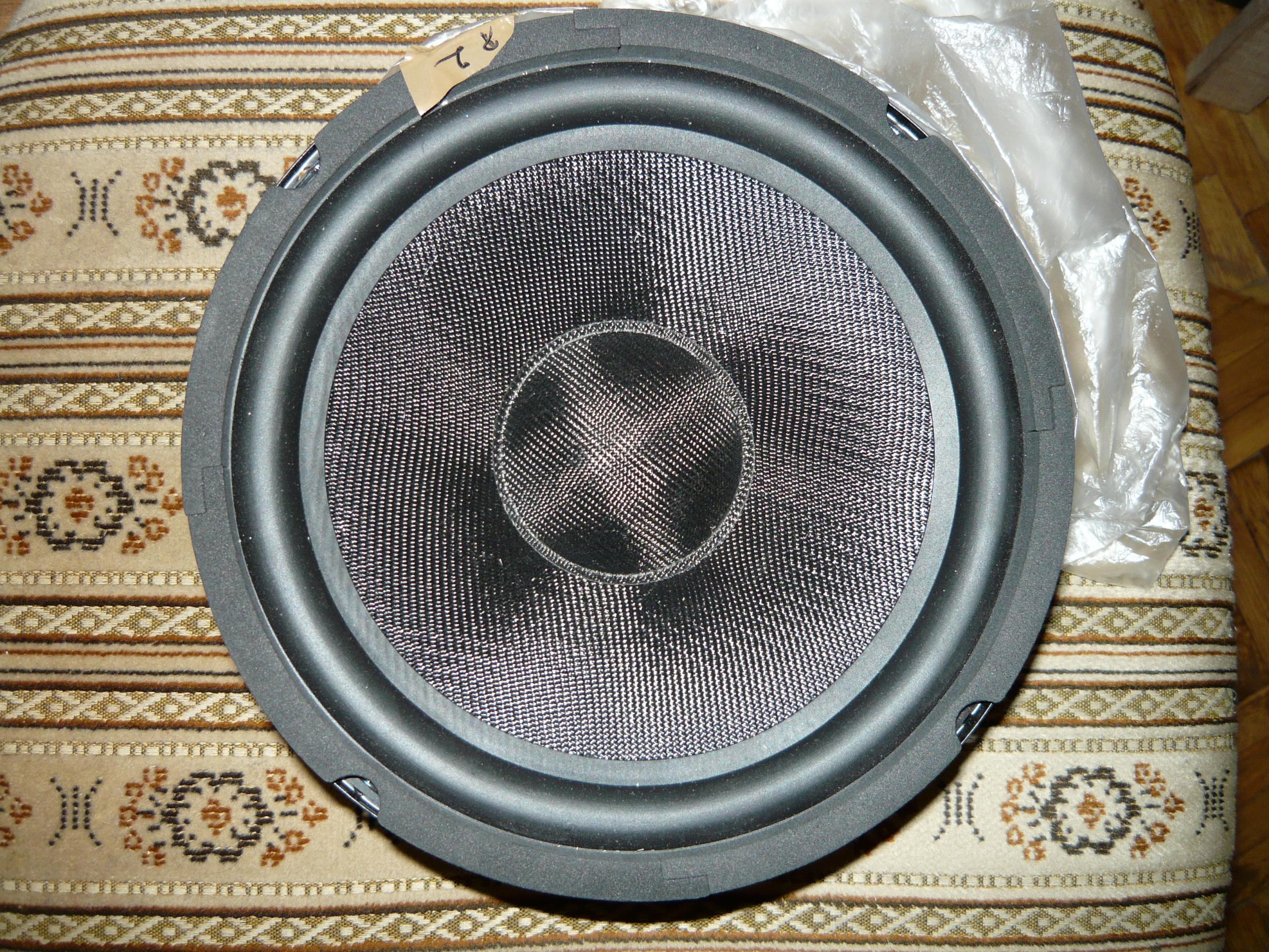

Well, I have read some more and as states out in speakers literature for 2nd order highpass 3,5 khz should be fine in my case, my case being tweeter: 2500 - 20000hz and that is what I am going with. For the mids Visaton M10 should not be so hard. And the basses found them by name and brand and states out for they to be SAL (Hungarian Speakers Company) SBX2030BK 120-80w, 3000Hz, 30oz magnet.
Here is all I have found about the drivers: Tweeters 1" recycled plastic tweeter with back positioned acoustic absorbant material rated at 8ohm, 8oz magnet, 2500-20000hz, no fs, qts, qms. The midranges I will go with are speaka 75/90, basses are SAL KBX 2030 all the data showed above and in pics posted before. The midranges will have a 3 liter cabinet of theyr own. I wonder if heco ascada 770 crossovers will be good they spec at crossover cutfrequencies 150/3500 4ohm.
Here are the plots for them for the XO's they are having L pads on the twweters and the basses but I can't the parts at supplyers and too much linking won't work for them. The mids I will be using are the speaka 75/90. I am buying heco ascada 770 crossovers if they are passing to them good. They are ready made and that might be the end of it! I will be soon done with the boxes stuffing coating orientation of the mids and front grille. So thanx all for the help! Goodbye!

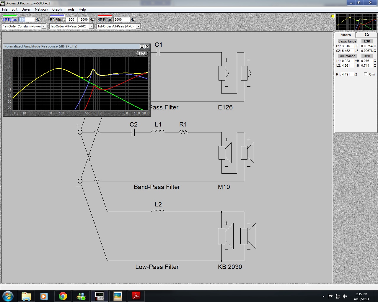

Hello! I am building a pair of speakers each unit containing 2 basses, 2 mids, 2 highs! Powers are as following: 120w bass/unit aramid, mids i do not own them yet but supposing they will be visaton m10 or similar, highs are silk dome tweeter with back possitioned wave absorbant material 150w/unit!
I want to avoid bell ring on bass!
Cut frequency 1500/8000hz!
I do not know a schematic or what is needed to make theese crossovers!
Preferably i would make them as cs-v50f from PIONEER!
