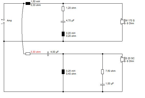

Can I suggest you build a two-way along these lines in about 20 litres of closed box or reflex.
I'm assuming you have a 7" woofer or thereabouts. We could fiddle about with it with more details about the drivers. But ought to work.

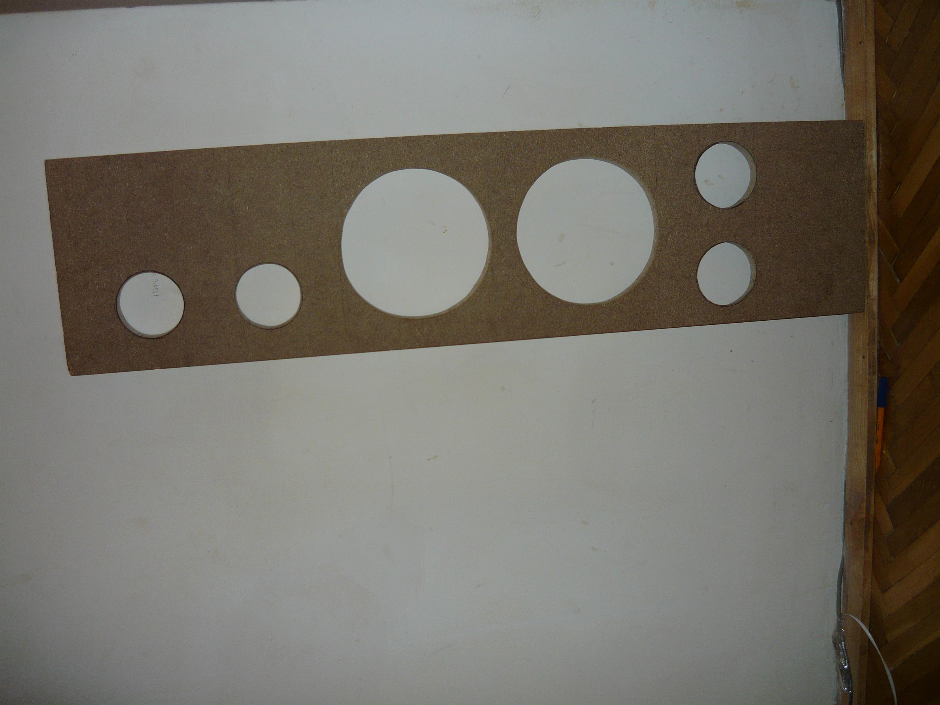

I will make theese, I am thinking of implementing on theese speakers on the rear a passive radiator of the same diameter as the bass unit.

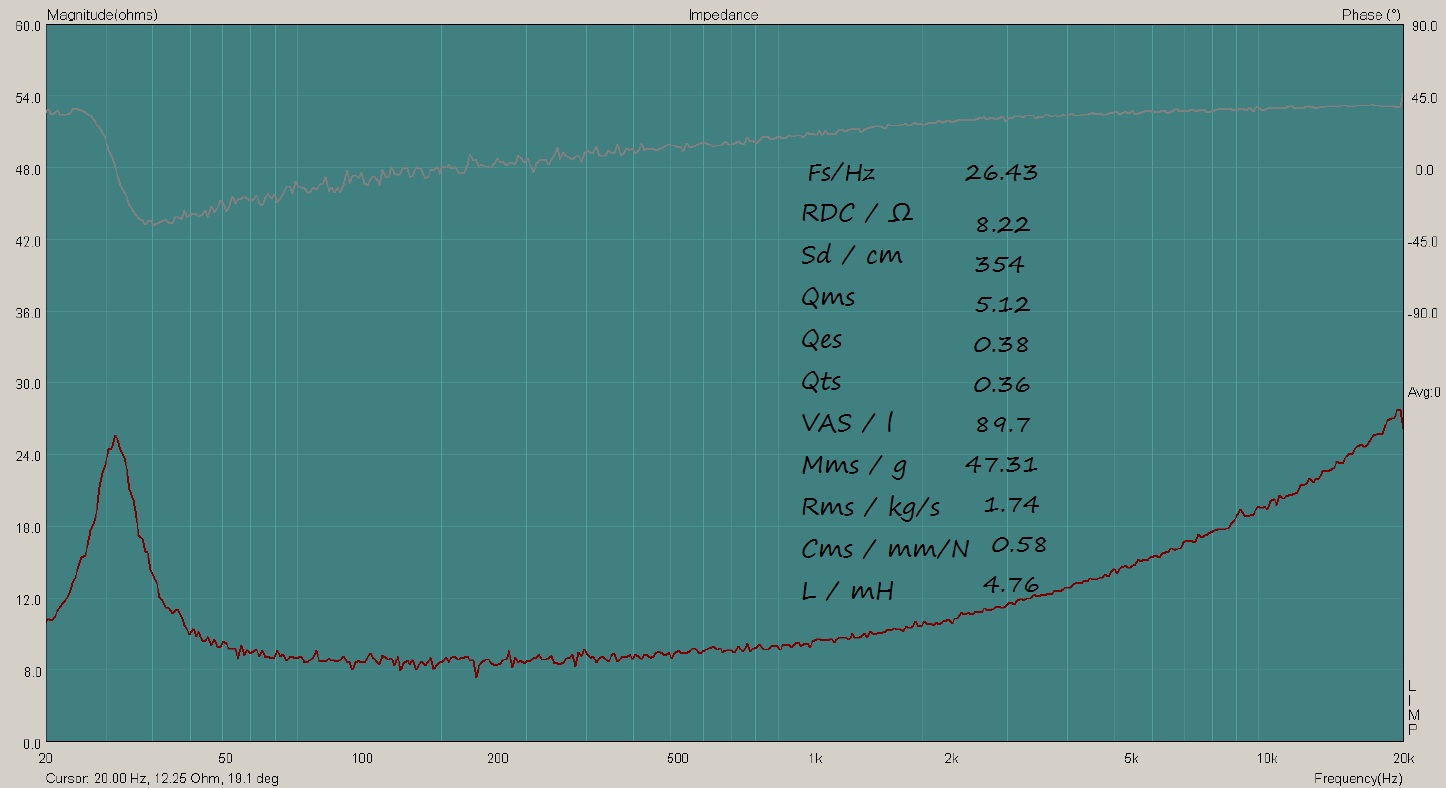

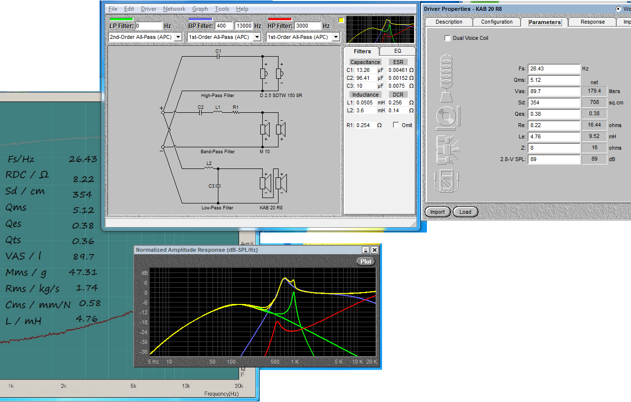

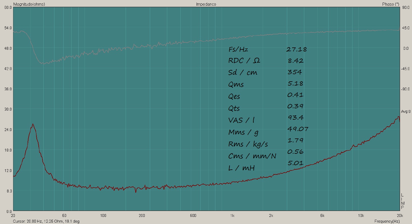

Here are some pictures of the speaker components, pllots and parameters! I have inserted the values of the drivers that I could find according to their datasheet. I do not know if the graphs are correct. The woofers are in serries configured! Pic one of the t/s is for pair one and pic two is for pair two! Only so that everibody knows! All good!

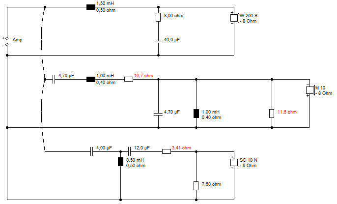

That Visaton M10 Cone Midrange is NOT GOOD. 😡
I delved at Troels Gravesen to find an ancient SEAS 3 way:
SEAS Kit 503

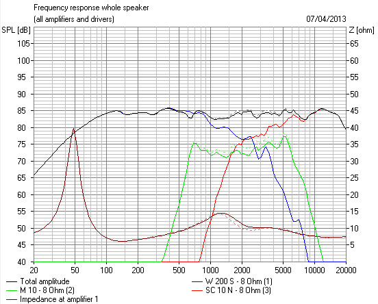

Best I could do was a Zobel on the woofer and use the M10 as a bit of a filler driver. It doesn't do much except ease the strain on the tweeter. How did you get on?
SEAS Kit 503
Woofers i think will do the job, midranges here are three aspects really there are and they amuze me about the midranges the originals weren't much hi-fi atall I think since the original speakers named CS-V50F were Karaoke BAR speakers sold togheder with Amplifier, reverb control, mic control , deph control and, they were made for simply just power and I don't know where that sound comes from or virtual surround since the mids were mounted on a orienting to left and right ornament each. I think that for this they compensated little in they sound spectrum as sometimes when they do not fire directly they offer the full rage spectrum of sound that they are intended to reproduce. Here are some pics of the speakers that are original to the brand and serial. For the midranges i do not have anymore space to make the boxes, so the Visaton M10 Midranges are allright for the job.
