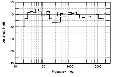

A good illustration of what happens if this simple is overlooked is the EPOS ES-25 (I am actually staggered how someone like Robin Marshall could get this wrong - I guess it happens to the best on occasion):
Stereophile: Epos ES25 loudspeaker
Basically, woofer and midrange connected in phase and out of nominal phase yields this:
The graph with the suckout in the crossover region around 400Hz is the one with "in phase" connection, the flatter response is the one with the woofer reversed.
And trust me, this is quite audible!

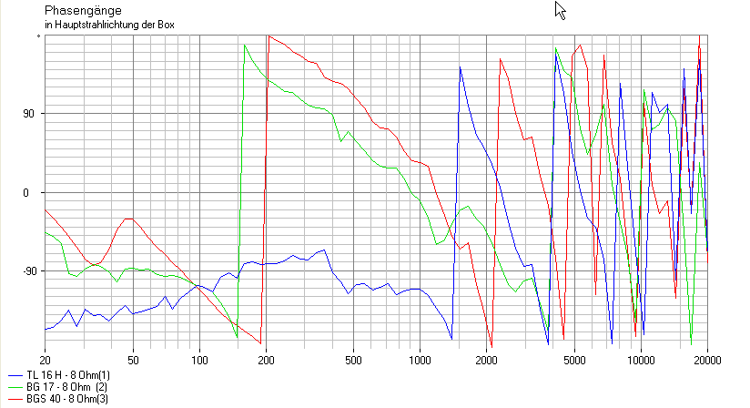

Phase vs SPL
Audax, first:
Peavey:
There's something wrong with the phase of the Audax (1). (?)
-- Audax with xover -- necessary for the right total phase (shift) with Peavey (2). This one already has xover (?) and looks good. 50Hz (+180º) to 3000Hz (-180º)
Just the raw drivers, no crossover.
Then you need proper phases with xover applied and then check for right inversion (or not).

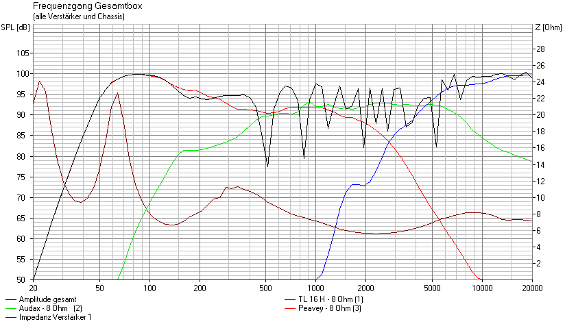

Here a simulation with different drivers with phase inversion already on woofer and minimal phase shift on software Boxsim (red-woofer/green lines-mid). (You should have something like this.)
ThorstenL, do you think that inductor (3.9mH) is going to be enough to protect the rest (high-mids) of the spectrum from it's interference with it's output and phases.

Note: I didn't use data from the drivers Peavey-Audax, only their curves from files with data/specs from Visatons. (So the parameters are different from what it should be. Just for illustration.)

On another note, I have to say that, ThorstenL approach looks like very close to a very good workable solution (as we can see on simulation from #173 with different data but same xover).:xfingers:
