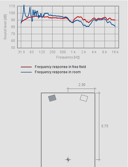

Hi Leo,
Just decided to do a quick run of the Tannoys in Mr. Hueneckes calculator.
Ignore anything above 500Hz, it would not be relevant to the speaker you are working on, with the Audax Mid and Horn Tweeter.
To get a better idea how midrange and tweeter will integrate into the room, the Triangle Celius 202 uses a similar (but less efficient) midrange and a horn loaded tweeter, so it is a good first order approximation.
Below 500Hz you can see what the room makes out of our overdamped LF response. I probably would be tempted to use a parametric EQ to pull down the spikes below 63Hz, above that the response is pretty good.
I placed the sofa at the golden ratio point in the room. The speakers placed approximately as you show.
Of course, this is only a simulator and you should take it with a pinch of salt.
Ciao T

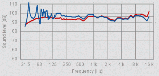

While we are playing with simulators, for fun I have spliced the LF response of the Tannoy System 15 DMT and the MF/HF response of the triangle Celius.
This should give a ballpark idea how the overall system might do in your room, of course, there is a fair bit of a fudge factor in that, so don't think "oh, this is what I'll get".
But I think it shows we stand a fighting chance with my suggested EBS bass alignment and the rest.
Ciao T
