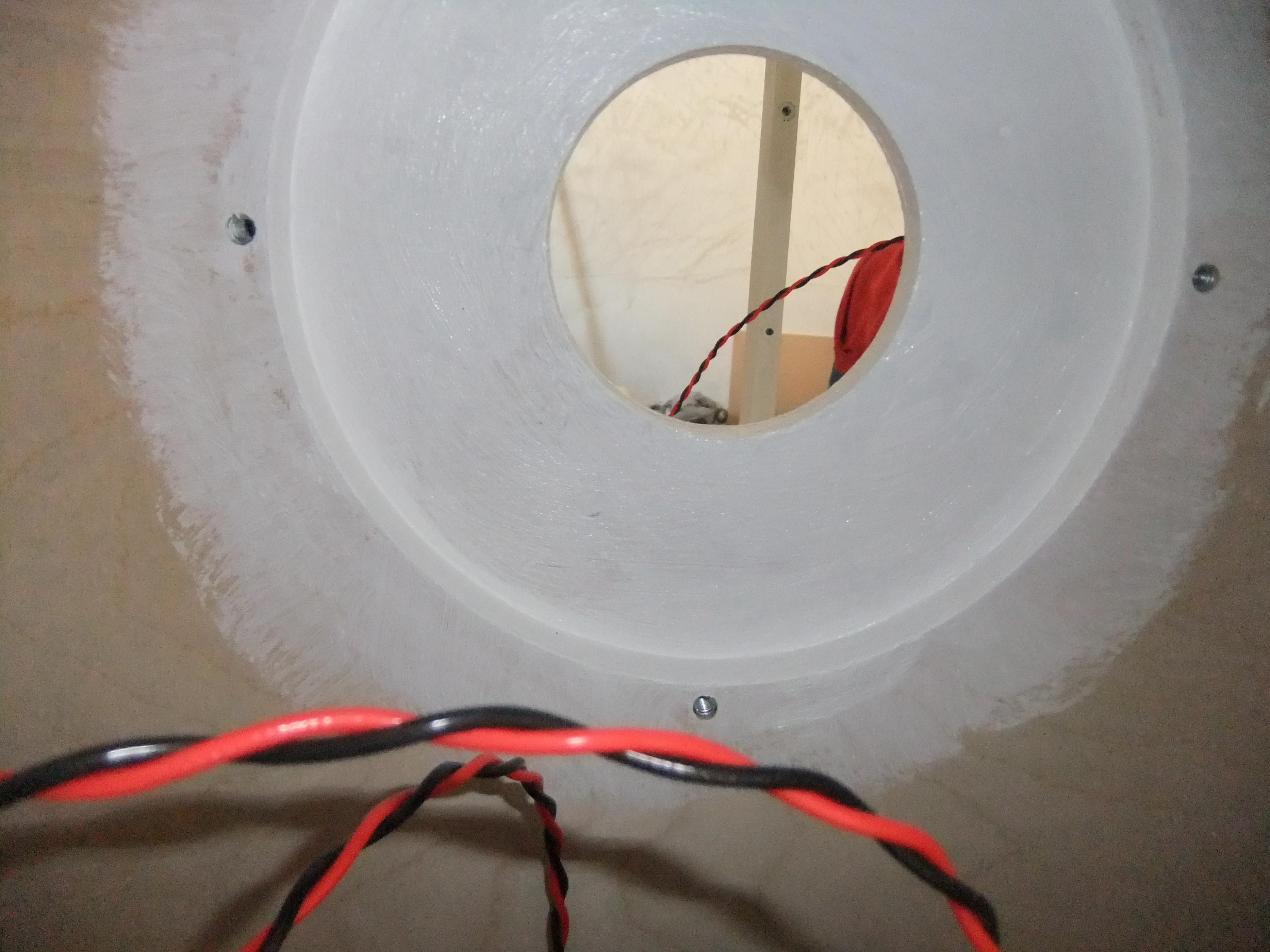

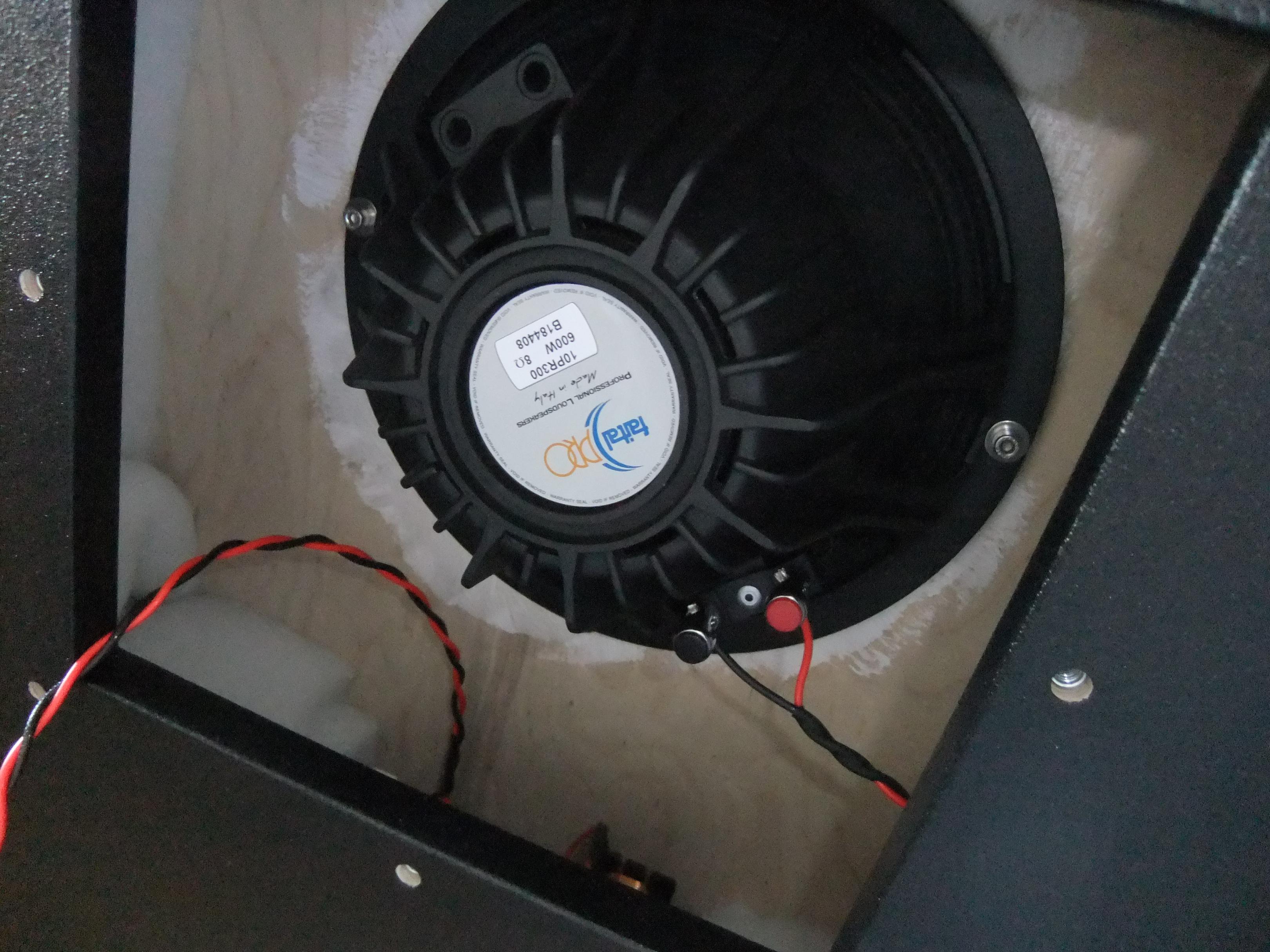

So the little round hole is where the faital 12" fires ... wow, so small ?4" diameter ?
It is Faital 10PR300 (10-inch) and fires to 10 cm diameter, with this I have got more linear upper frequency responce. It is my design and calculations with HornResp and shematics I have on paper.
Interesting, did you model it as a front loaded horn then?
I have 4 x TH1819 up to 110 Hz, Mid conical comp horn from 110 Hz to 1350Hz Faital 10PR300 and Hi Faital LTH102 and HF10AK from 1350 Hz up to 20kHz
