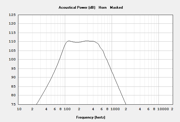

5460(1.3/22.86)=310.49868766404199475066
5460 is static in this formula
1.3 is the KA I am investigating
22.86 is the diameter of the driver divided by 2, in cm
310.49868766404199475066 is the frequency where a 1.3KA would start, as we go higher KA increases, lower, KA decresases. Look on the Geddes paper for the KA charts showing the anticipated dispersion width. Rule of thumb is to crossover with a 2=KA or lower....its a generic rule, with intelligent design the rule is bent. I personally think for a near-field 3 way for myself, the lower I can get ka, is the better. For you, 2 is probably fine, and most will tell you to try and match the polar width (KA) at crossover of each driver in the crossover.
I'm still reading papers and experimenting with hornresp because I wanted to use the 12PE32 with the conical midbass horn. But volvotreter is using a 15" driver in that horn. I mixed it up with his tractrix midbass horn. So far I couldn't find another 15" which performs well in the conical horn. And the 12" goes down to ~100-120Hz. I wanted to cross at 80Hz. This would mean the death of this idea and a win for the 15" woofer without horn. Or another compromise...

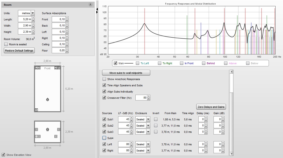

What krivium said is correct, but you also have to look at this in terms of what the room will do. If you can space your main speakers far enough away from walls then you can avoid cancellation issues in the 80 to 160Hz range. That is easier said than done in most rooms with the distance to the front wall (behind the speakers) often being hard to get 2m plus away from.
You can easily see some of this in action by using REW's room simulation, place your speakers where you think they will go and what what havoc the room wreaks on the response, by moving them around you will be able to find the best balance of issues in practical placement. If your room is rectangular this will work, and as it is based on distances the accuracy is very high if all the information entered is correct.
Getting your speakers and subs positions and types to co-operate with the room will get a vastly improved result. In Toole's research bass attributes approximately 30% to the preferred result, getting it better makes the apparent sound improve significantly. I find the same with my own experiments, a smoother bass response with less nulls makes a huge difference.
The best sub crossover is completely impossible to decide before you have measured the speakers in practical positions. You may need to go high you may need to go low. This is one of the reasons I suggested a simple start with a direct radiator. The greatest weapon a diy designer has is the ability to match the room and speaker together, most commercial speaker designers make educated guesses hoping to get a fairly good result across the board.

I planned to position the speakers to the corners to get the biggest possible listening distance. The simulations with REW were kind of eye opening and shocking at the same time. You can find the simulations attached. This was the best result I could get. IMO it doesn't make big difference if I use 3 or 4 subs. And moving the mains away from the walls made things different but not really better. Most significant is the listening position. It makes the biggest difference. I don't like the behavior in the upper bass frequencies. What do you think about this?
Is it possible to use a small bandwith eq for the room modes? Would this make things better? I read that's a great opportunity if you have FIR filters.
Anyway there will be plenty measurements needed. In the link you posted there is another way crossing the subs and mains with overlapping.

Placing the speakers in the corners will certainly reduce the impact of boundary interference and if that is your intended placement designing the speakers to work there would be a good idea. You can smooth out a lot of bass issues with multiple subwoofers, delayed, equalised and gain set independently.I planned to position the speakers to the corners to get the biggest possible listening distance. The simulations with REW were kind of eye opening and shocking at the same time. You can find the simulations attached. This was the best result I could get. IMO it doesn't make big difference if I use 3 or 4 subs. And moving the mains away from the walls made things different but not really better. Most significant is the listening position. It makes the biggest difference. I don't like the behavior in the upper bass frequencies. What do you think about this?
Have a look at this paper from Welti and Devantier there are other sources of information and presentations with simpler illustrations as well.
https://pdfs.semanticscholar.org/00da/51387c572cfd27c0256cb15e44e976a1a72e.pdf
In a rectangular room they found that either 2 or 4 subs worked best and that mid wall or corner positions were best. Have a look at some of their research to see which sort of response you think is easiest to work with. Then have a look at Multi Sub Optimizer Software, which is kind of a free version of sound field management.
Yes minimum phase EQ will allow modes to be suppressed. No need for FIR to deal with this. With well placed multiple subs and a fairly fixed listening position the above software can work wonders.Is it possible to use a small bandwith eq for the room modes? Would this make things better? I read that's a great opportunity if you have FIR filters.
In a home type of construction anything under 200Hz is going to be hard to deal with easily using absorbent due to the depth required. Helmholtz style targeted traps would be needed and are notoriously difficult to get right.Hi, this isn't this bad.

The result is changing. By moving them around you improve one mode but another one gets worse. When using only 3 subs it was good at the middle of the back wall behind the listening position. Also the delays can change a little bit. But like fluid said hopefully it will be better with delay, eq and gain.
Btw I'm not sure if I mentioned it before. As subs I want to use the Beyma 12BR70. It's not a dedicated sub but it goes very low in a closed box and has a nice sensitivity. Only downside are the ~150L volume needed.
Broadband absorber are on my list of course. But I didn't plan in detail how thick they should be and how many my room can handle. It would be great if everything works without bass traps. But maybe I can add them if needed.
Start with the main speakers only in the simulation and try and find the best position with the least nulls. The lower frequencies will be taken care of with the multiple subs but big nulls in the wrong place will make the crossover difficult.
I simulated the Beyma drivers and they want a ~50 litre box with fairly heavy stuffing to get a 0.7 Q, with 120W input they do not exceed xmax. Seems pretty reasonable and no need for 150L in my sims.
To see the response of any absorber you can get a reasonable idea with the porous absorber calculator. You need to know the gas flow resistivity of the material you will be using to get a more accurate prediction. These vary wildly between materials that look very similar. In general something around 10,000 or less works pretty well in reasonable thicknesses. Air gaps really help to extend the effective frequencies downwards.

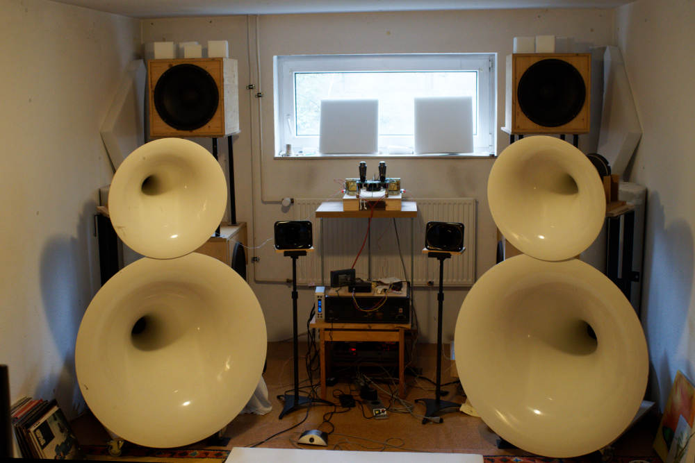

Hi Drumberg,
here comes a more detailed view on my system.
My listening room is located in the basement of our house. All walls including ceiling and floor ar either made out of
concrete or bricks. The measured frequency response of the untreated room showed peaks of more than 20 db caused by the (badly distributed) room modes and the hard surfaces of the room.
The room is an acoustical nightmare, but the combination of speaker placement, acoustic treatment and dsp based eq has solved some of the problems.
The lower bass speakers are Tad 1601 in 150 l onken style enclosures, but the reflex channels are completely blocked with damping material. The upper bass speakers are BD15s in 70l closed boxes.The bass enclosures are placed near the front wall to minimize boundary interferences. The horizontal and vertical placements of the bass enclosures are inspired by the dba concept (double bass array). There is no corresponding array on the back wall, but both back corners are stuffed with 50 cm deep acoustic absorbers.
Small remark: The in room frequency response of the 70l and the 150l boxes are not that different, as the room modes rule the bass response in small rooms. You have to eq the response anyway.
The horn satellites are driven by JBL 2490H compression drivers on 95 cm (tractrix?) horns and TAD TD4001 on 53cm (tractrix?) horns. The additional tweeter horns are B&C de10 on 18sound Xt120. The satellites are placed 1,5m in front of the back wall. The listening distance is 2,5 m.
All drivers are time aligned and controlled by a convolution based digital crossover located on an audio pc running jriver. The crossover filters and eq are done by acourate.
Early reflection are reduced by the directivity of the horn speakers and damping panels on both sidewalls, floor and ceiling. The result is a "dry" sound that requires some acoustical enhancement to make the speakers more listenable. This is done by two ambient speakers placed behind the listener. The ambient sound is generated by a combination of VST-plugins inside Jriver. I borrowed the idea from Wesayso, who presented this approach in his line array thread.
Feel free to ask further questions.
-Bodo
I didn't have much time in the last days. I still need to do some room simulation especially with my 20m² just to see how it behaves. But I made some midbass horn simulation. I tried a ton of drivers until I had the idea to try the 15PR400 in a conical midbasshorn. The simulation doesn't look that bad either. It should be useable from 80hz to 500hz. Maybe I could pull 2db out at 150hz with eq. I even made it a little bit shorter (70cm vs. 77cm). What do you guys think? I needed to decide between 15PR400 in closed box without horn and 12PE32 (or other) in a midbasshorn. With the 15PR400 I can try both without buying different drivers.
@bodo: You have got a big system there
The tweeters look pretty far away from your tractrix horns. Does everything play as one closed system? Or can you hear that different drivers are playing?
50L would be a dream. But can you tell me a little more about the stuffing?I simulated the Beyma drivers and they want a ~50 litre box with fairly heavy stuffing to get a 0.7 Q, with 120W input they do not exceed xmax. Seems pretty reasonable and no need for 150L in my sims.
@bodo: You have got a big system thereThe tweeters look pretty far away from your tractrix horns. Does everything play as one closed system? Or can you hear that different drivers are playing?
The acoustic path length of the upper tractrix horn is as long as the path length of the tweeter horn. I can't detect single drivers. Even the bass section is integrating nicely due to the digital delay on the horn speakers.
Don't waste your time on absorber construction, if your (new) listening room should have hard walls. I've tried different kind of absorbers. The best I could get was about 3-4 dB on a single room mode. Finally the combination of eq + broad band absorbers (acoustic hemp, melamin foam, Caruso iso-bond) solved the problem with room modes. Don't fear to use eq for solving problems with room modes. I had to use an attenuation of 16 dB on single bass frequencies. So 2 dB at 150 Hz is nothing to worry about.
