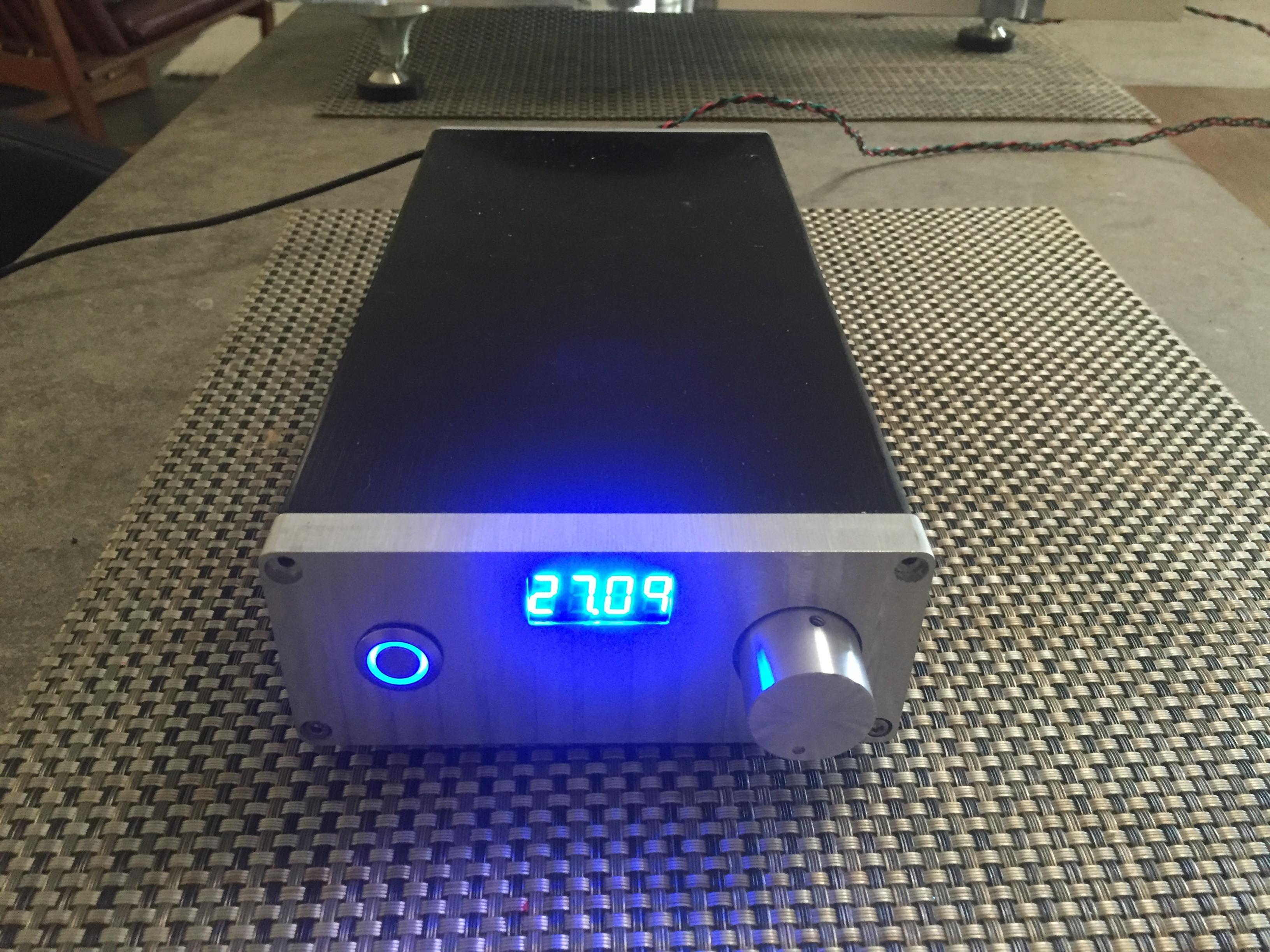

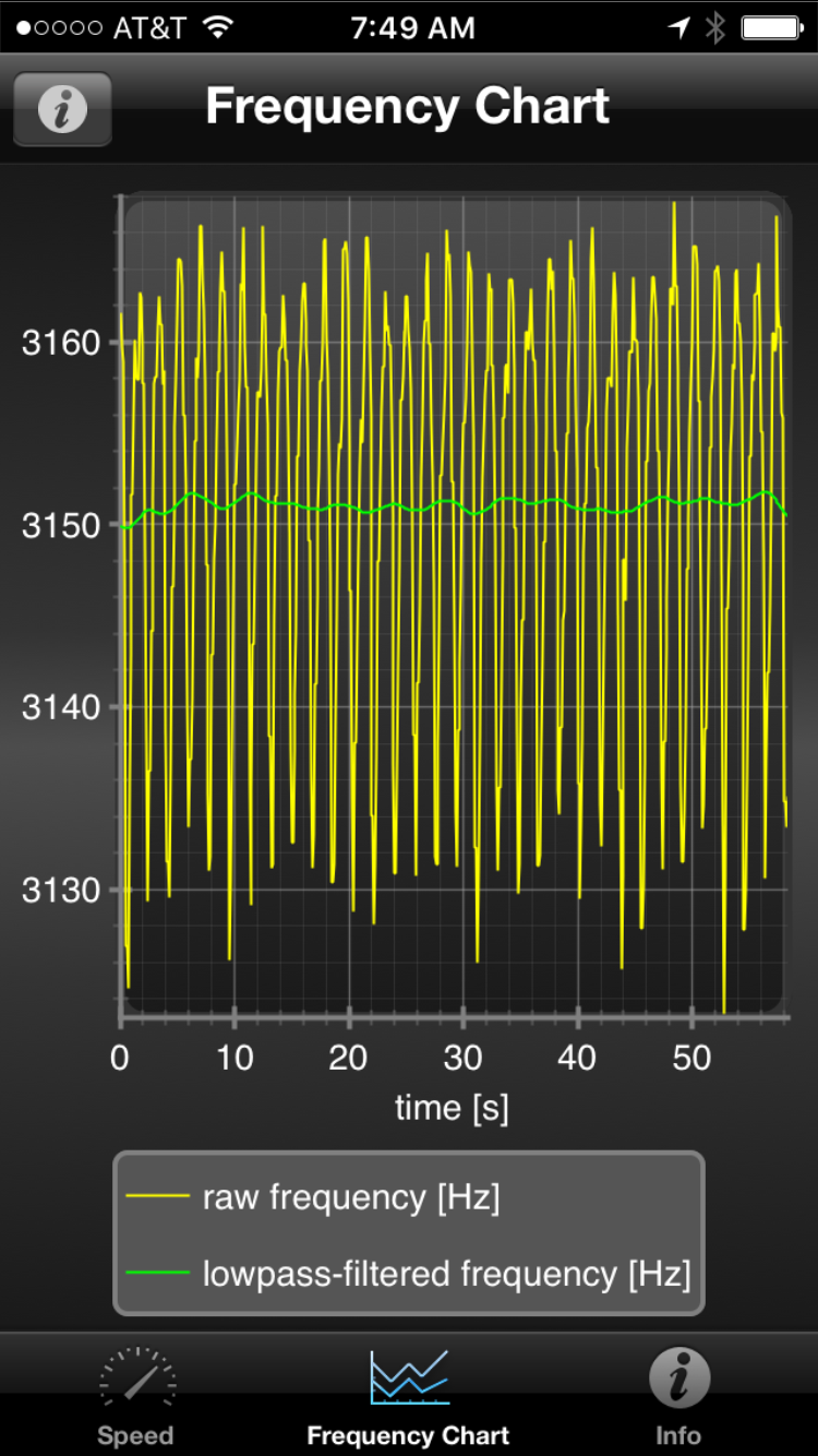

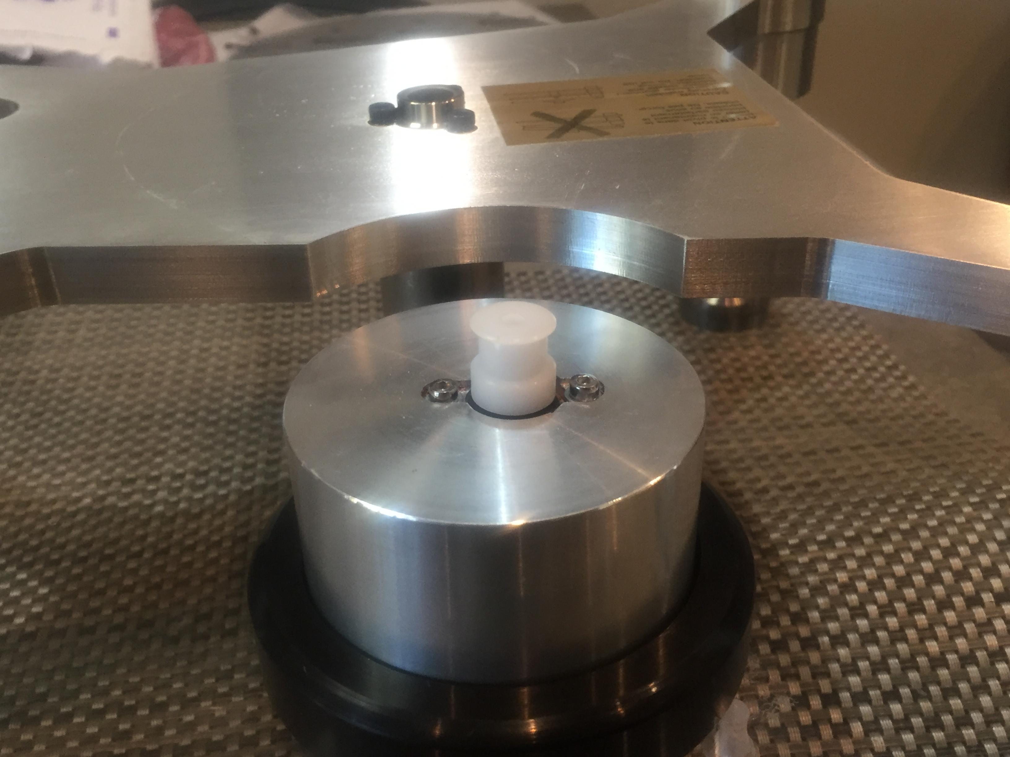

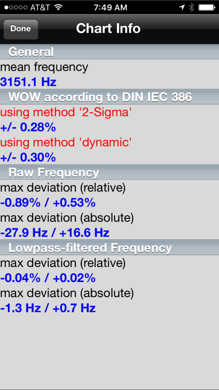

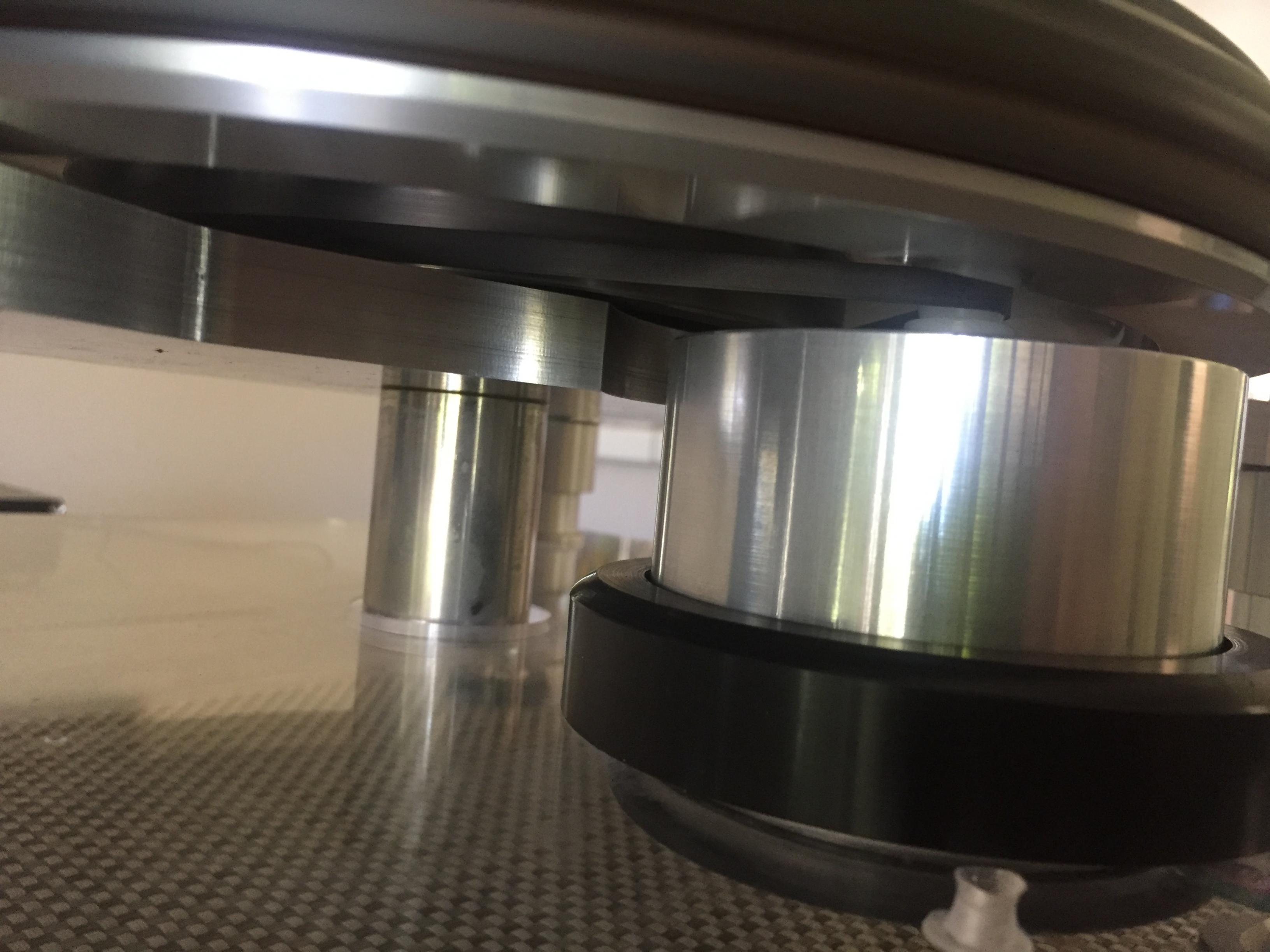

Thank You Pyramid for making this project available.
I've been playing around with the SG4 and now the Class D amp and motors from AA. I started with the BLWR as that was the only one in stock at the time. I am currently running 27.09/36.61hz using a stock size pulley. I have attached platterspeed graphs that show speed accuracy comparable with some high priced tables. My pulley is accurate to within .001 and think the absolute deviation is mostly due to the test record being quite off center.
I’m working on the BLWS now, (it is quieter as Pyramid stated). The pulley is also more accurate since I have a ¼” lathe mandrel to turn between centers. I should have it mounted later next week and will make graphs to compare.
Gregory

Great looking controller and great results! Which LED display did you use (Blue?)
If you are running the BLWS motor, the max output (SG4 at 128) should be 13.2VPP at 27 Hz and 15.6VPP at 36Hz. You can power the MA-3D with up to 24VDC without a problem (you'll need a higher supply than 15VDC to get 15.6VPP output).
Thank You, I used this New 0.36" 0.36 inch 7 Segment Display Blue LED 4 Digit Common Cathode | eBay and just used some scrap I had for the faceplate &
knob. The chassis was from a failed turntable controller I put together last year. No such issues with this one!
Thanks for the tip, I have some 24v supplies and will give it a go.
Gregory
